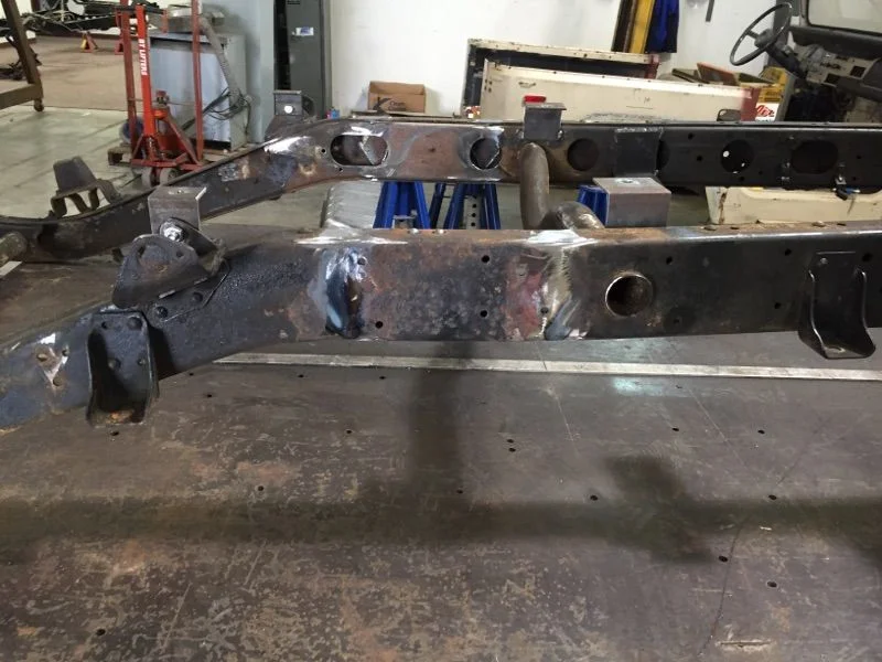

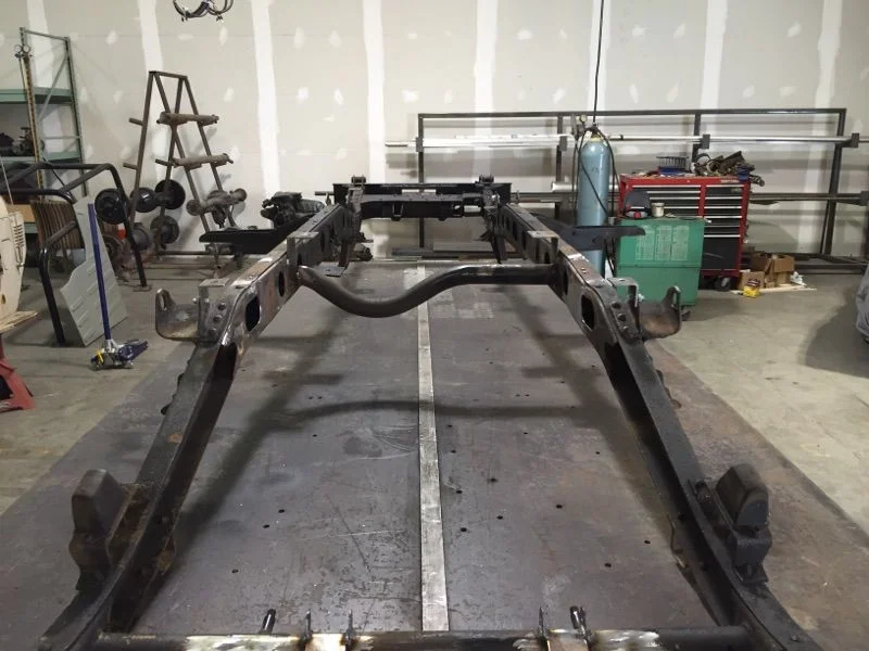

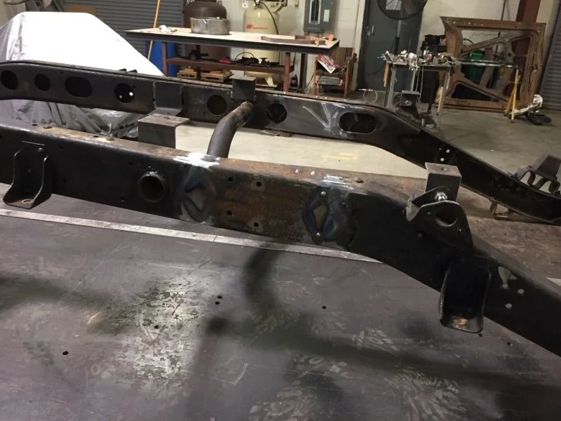

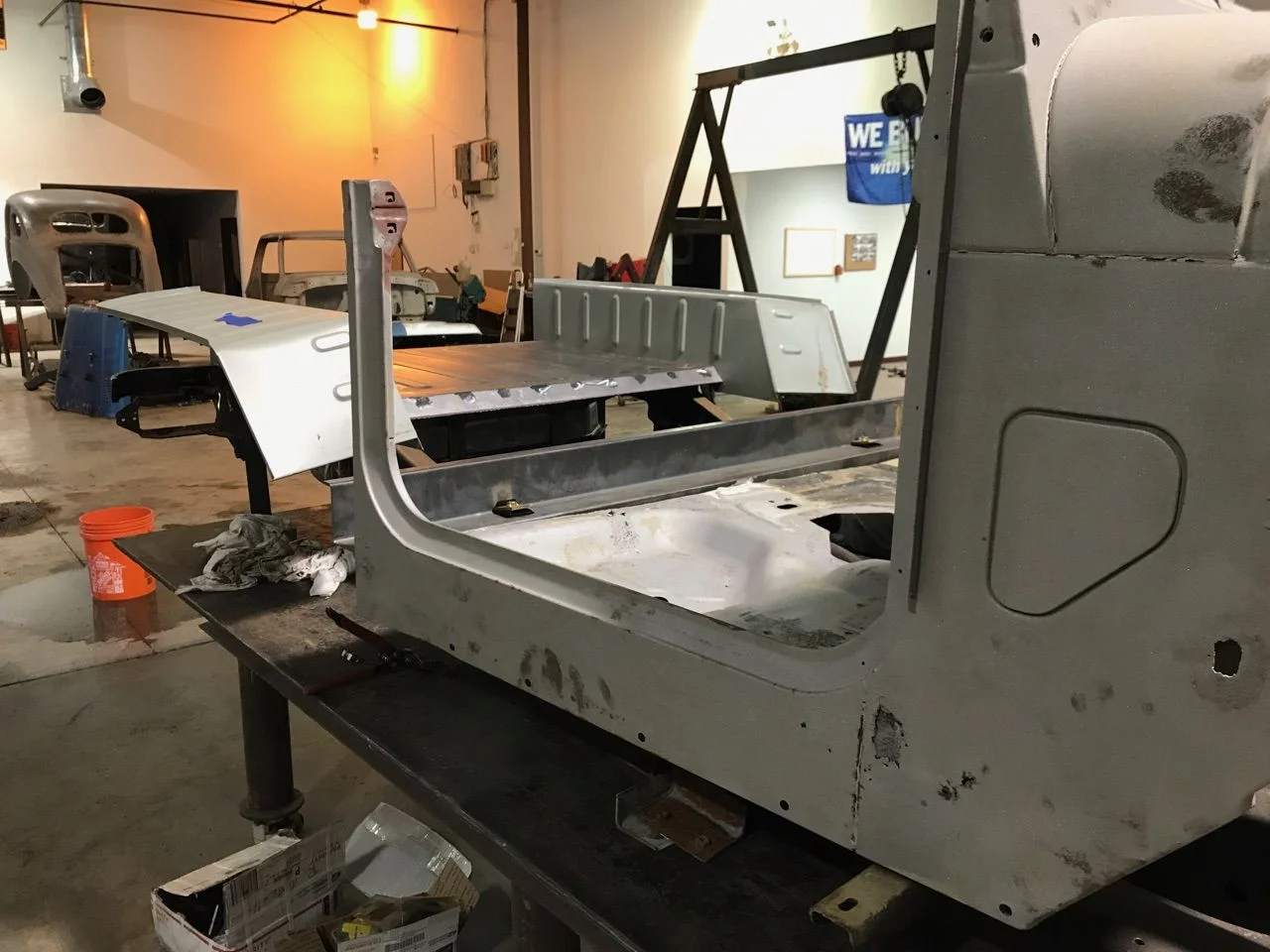

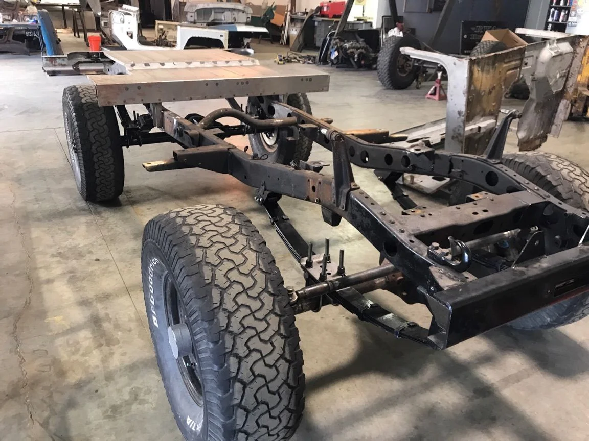

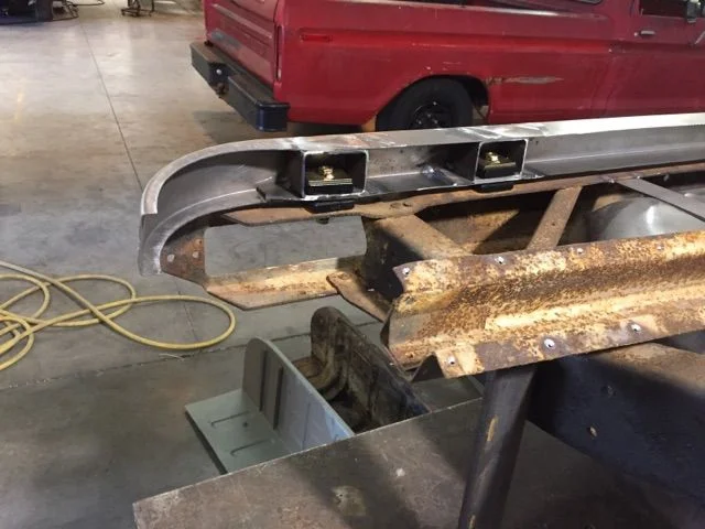

I decided to take my running and driving 1974 FJ40 into RVA Hotrods and Restorations. What we thought would be a simple cut and stretch turned into something completely different! They tore it down to just the frame and put it on the chassis table to make sure it came out straight. We used a section of an old frame to make the stretch section and blended it in.

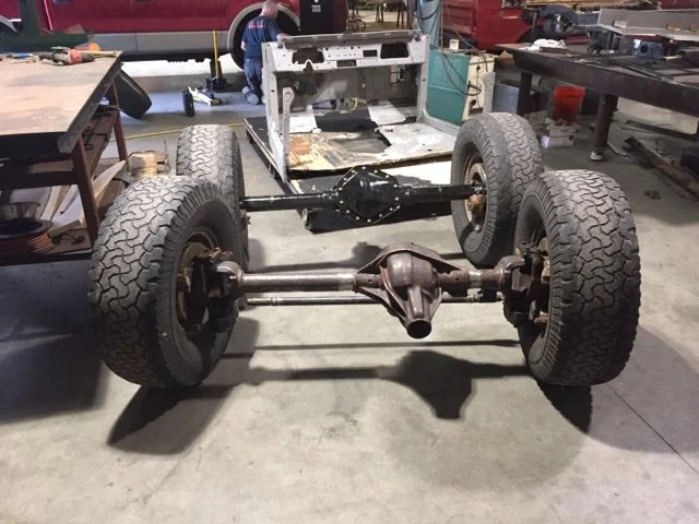

I was planning on doing a drivetrain swap later down the road but decided this was the best time. Curent drivetrain consist of:
1995 TBI 350
1978 4spd, t-case, axles with mini-truck outer knuckles and brakes
Skyjacker 4" lift
33" BFG All Terrain KO 2's
New drive train will consist of:
2004 Chevy 5.3l, 4L65 out of Suburban with 124k on it
NP241C, drivers drop

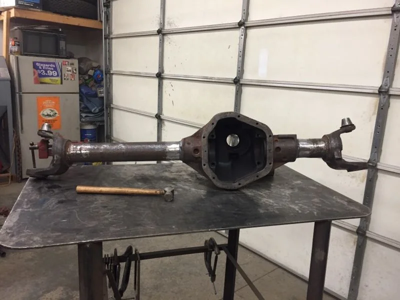

Custom HP Dana 60 with Chevy outers 3/4 brakes 35 spline shafts, Yukon 4:56 gears and Zip Locker, narrowed to 64.5" wms
Corporate 14bolt rear, 4:56 gears and Detroit locker, 3/4 ton disc brakes 63" wms
1350 Spicer cv driveshafts
SOA
35" or so tires I am trying to keep it low

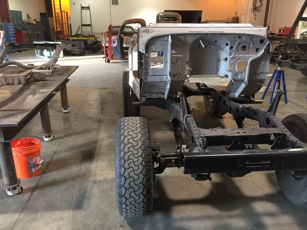

We found a lot of hidden rust and bondo and fiberglass on the body tub. I knew about some but not all of it. After reviewing the situation it was decided that we would build a new tub. Floor pieces are started. Some panels such as the drivers side floorboard and inner rear wheel wells were bought from Iron Pig Off Road. I have admired Lance's FZJ40 but wanted to keep the 40 frame.

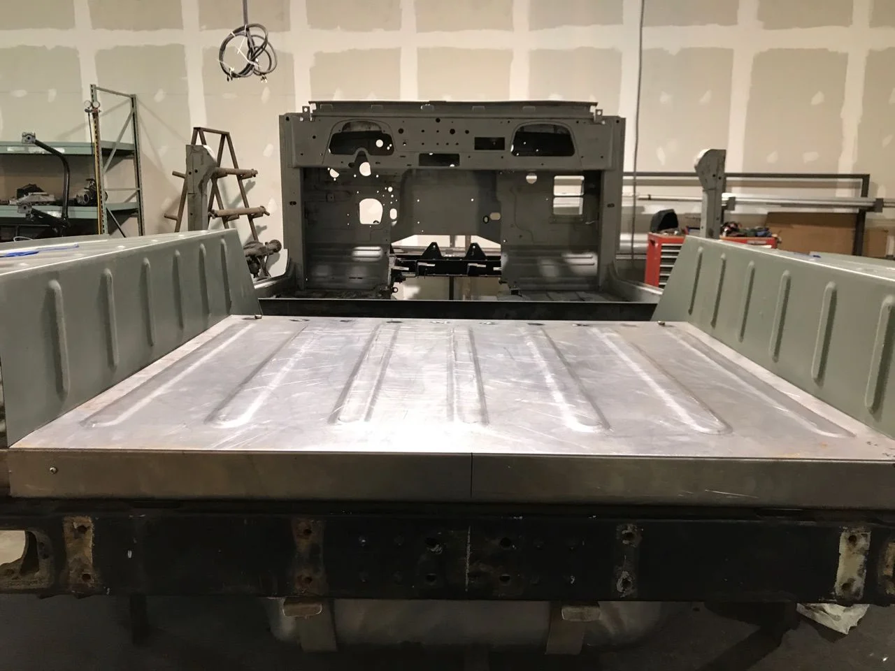

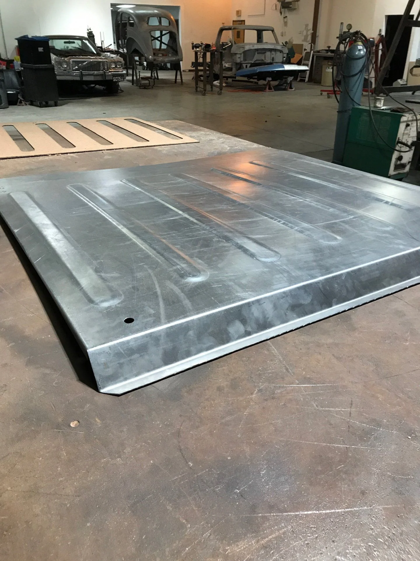

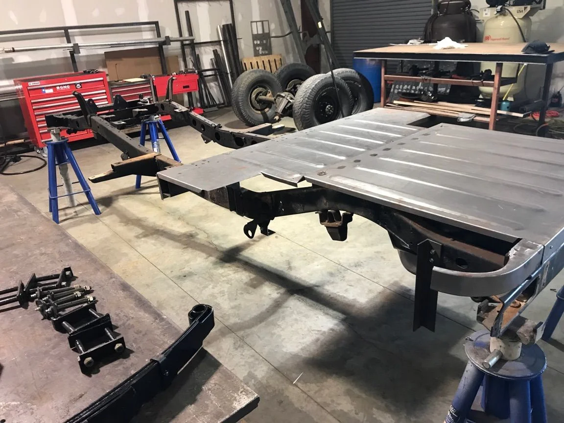

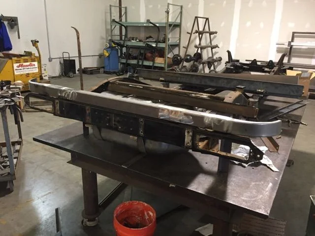

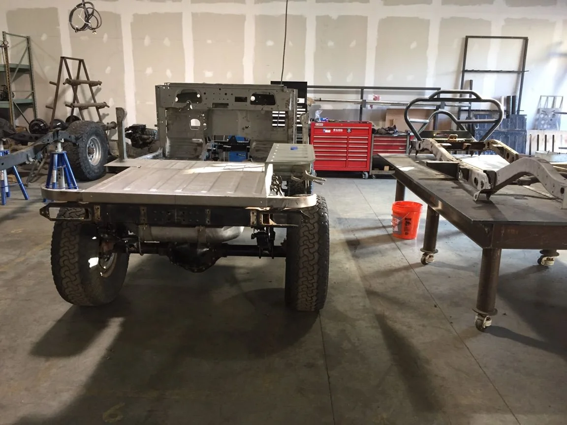

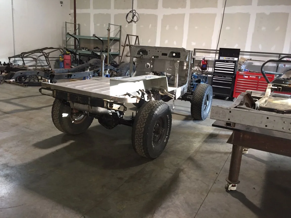

I got some progress pics of the project today. Main bed panel made, inner fenders mocked up and cowl back on frame. Now time to fill in the blanks with a new floor board on pass side, some small patches on the cowl, finish bed and install quarter panels. Sounds easy right?

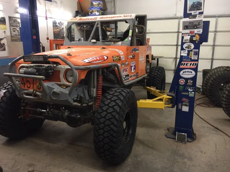

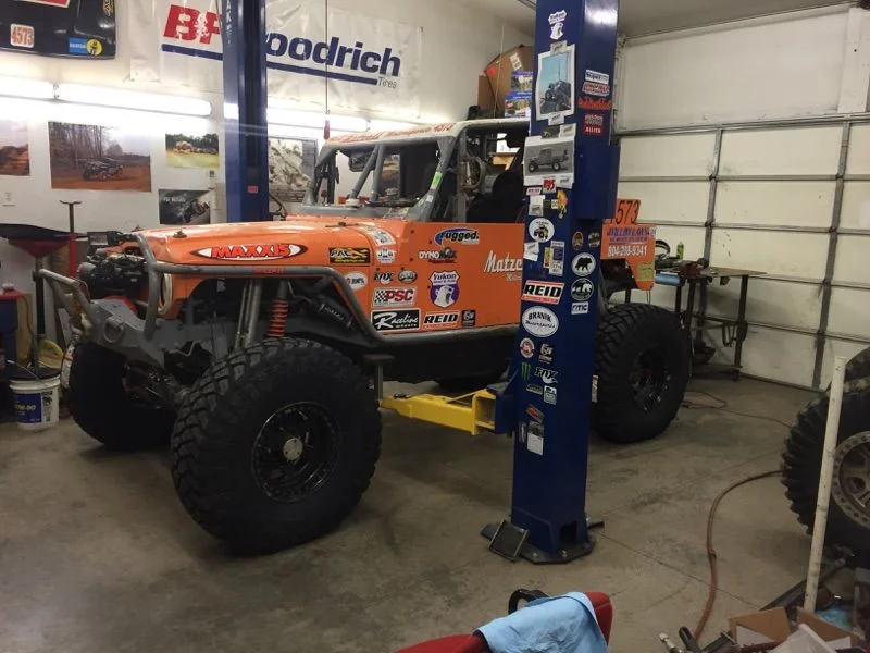

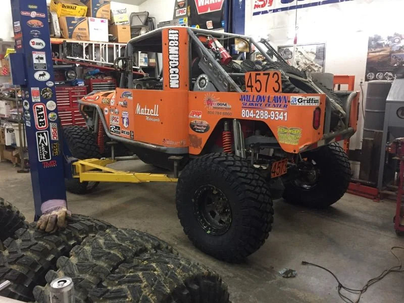

I think the 40's are going to be too big for this project. They do look good on my 45 though.
I am actually worried about them rubbing! It has a lot of flex with 14" travel shocks.

Coming along slowly. Frame is back on axles so we can get the rear wheel opening correct since I flipped the rear springs. I am stopping by after work tomorrow so I hope to get more pics. Currently sitting on 35's.
