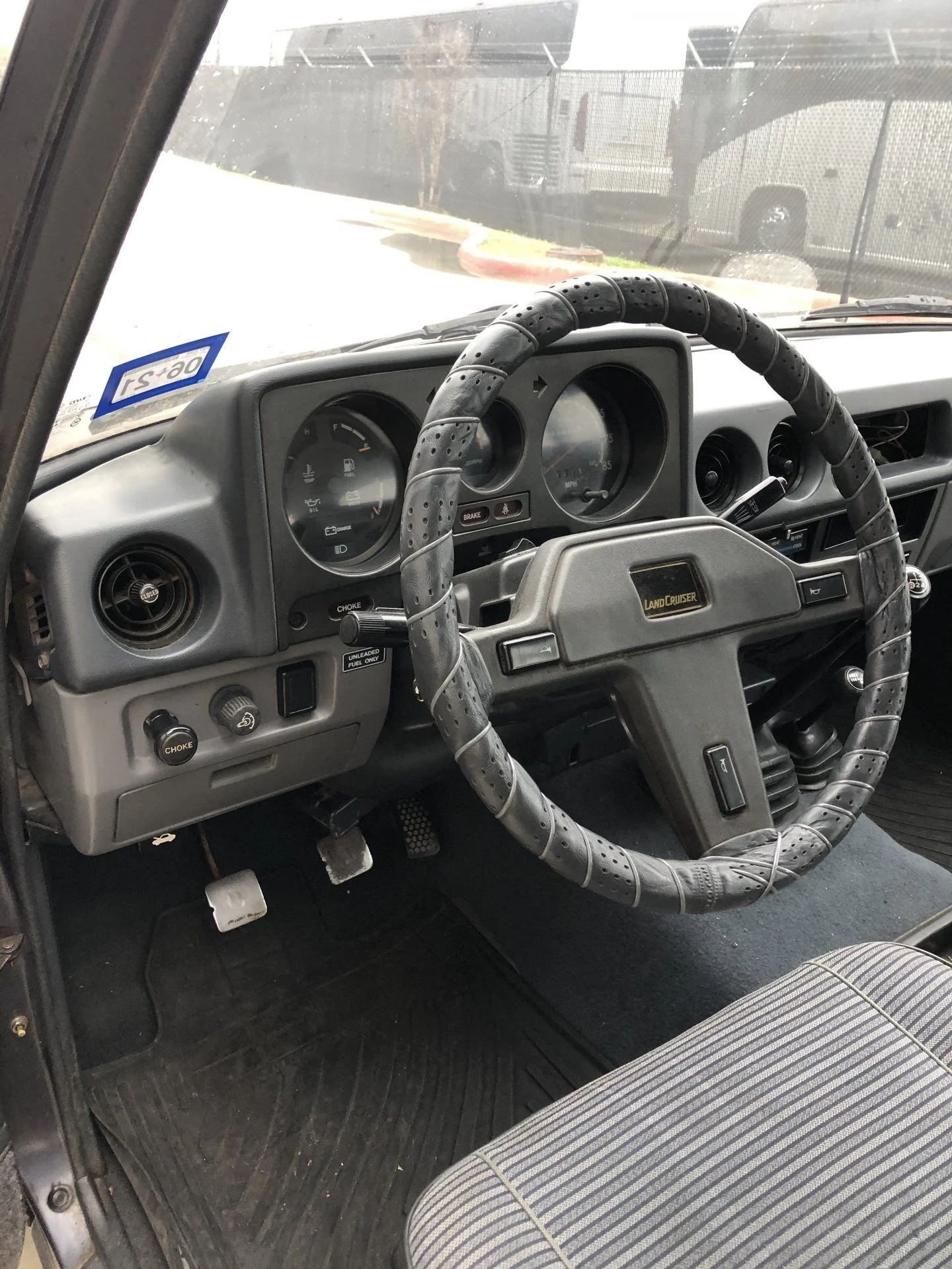

Something about the way I drive an FJ60 must be weird. I have no idea why, but I can not be behind the wheel of one for more than a few minutes before the horn honks. It has provided for some head scratching moments from people who happen to be near me when driving down the road. City or highway driving doesn’t seem to matter. Sooner rather than later, the horn is going to honk.

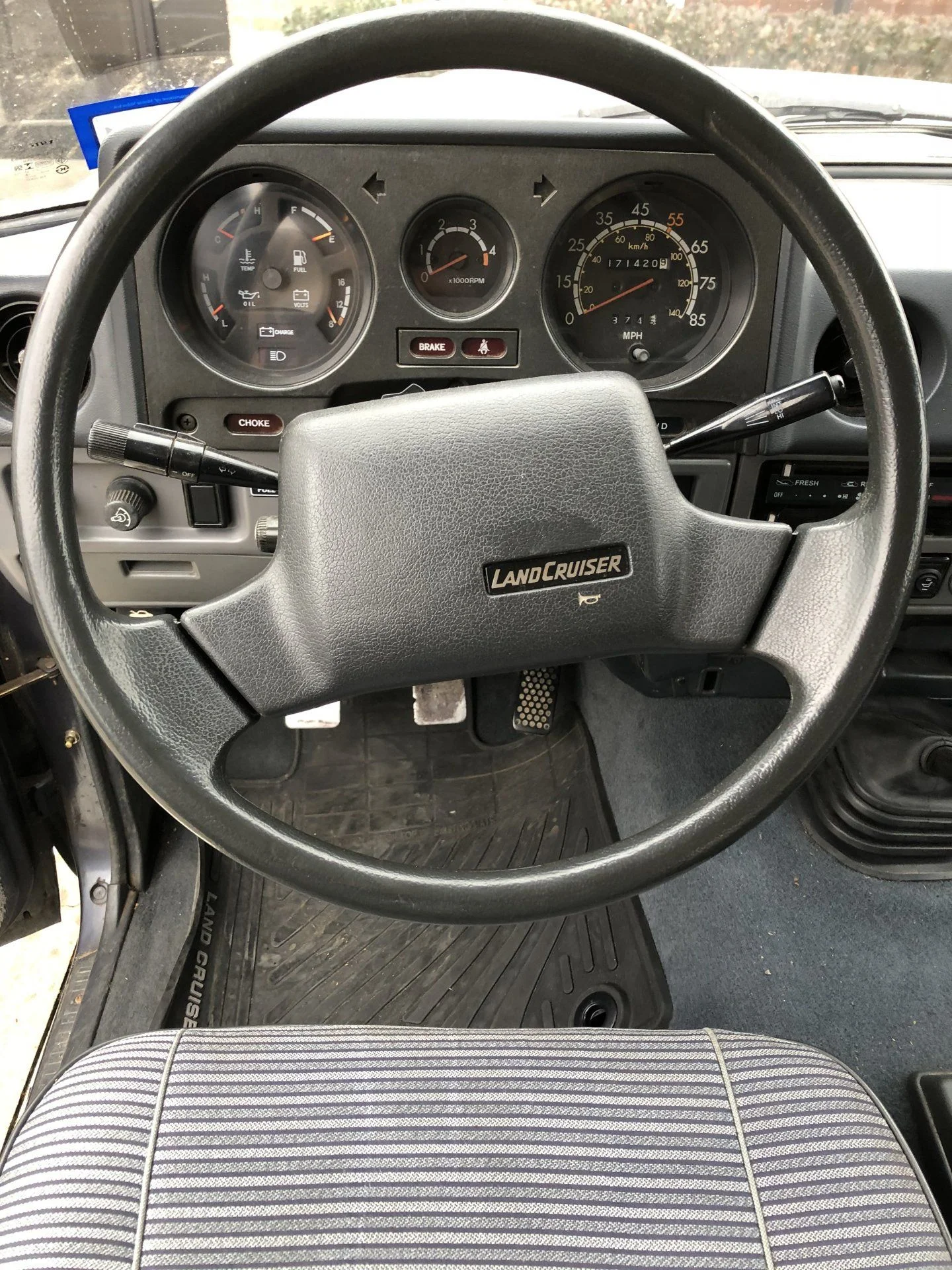

Needless to say, the first mod had to be an FJ62 steering wheel. You will not hear too many good things said about a 62 from me. However, the FJ62 steering wheel might be the best Land Cruiser wheel there is. Today was the day the new wheel got installed.
From this:
To This: I can’t stop smiling.

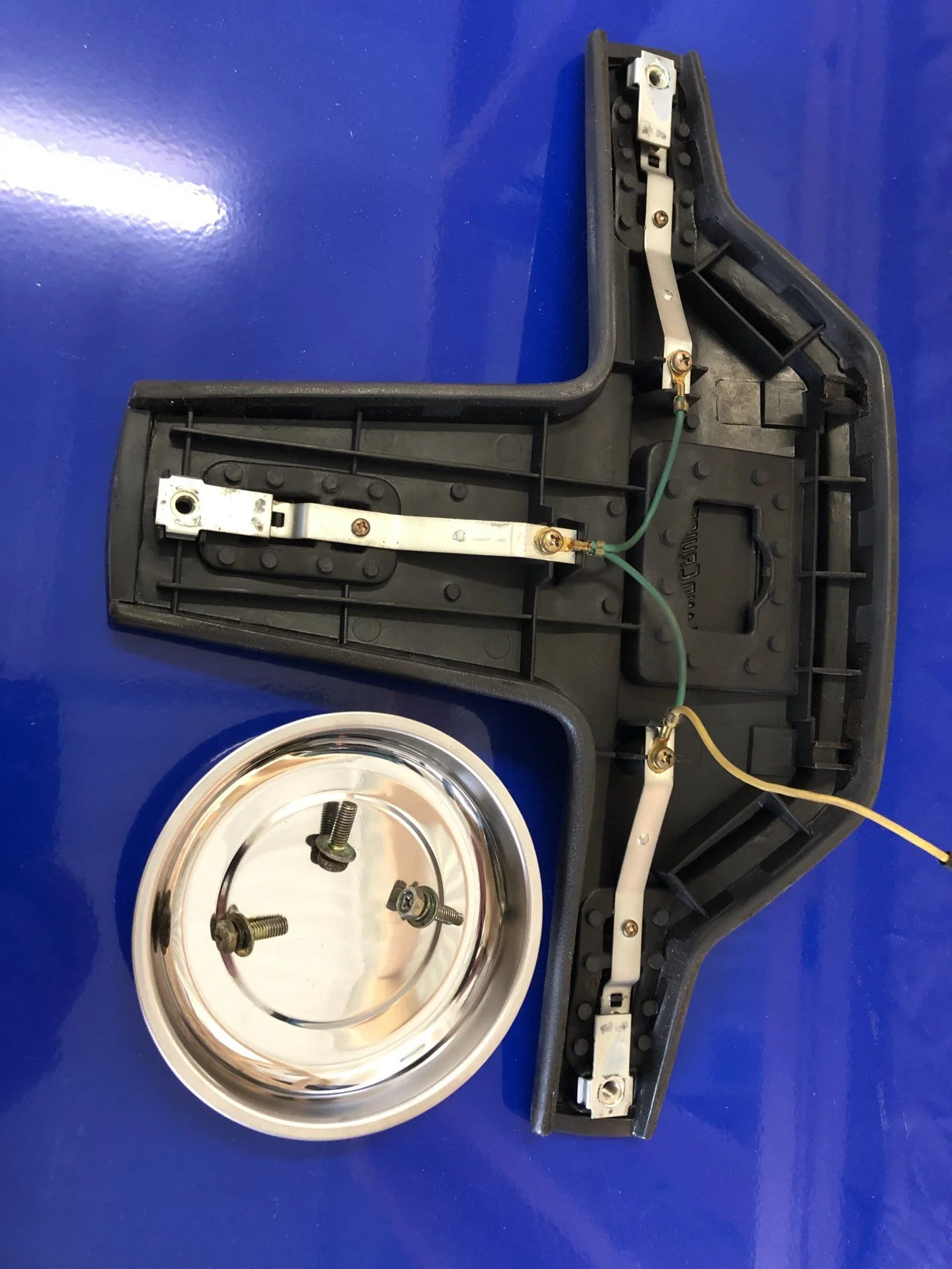

Congrats on finding the 60. Can't say I love the look of the 62 wheel but completely understand bumping the horn switches, and it seems like a good remedy. Does the horn wire/pin in the headlight switch harness clip into the 62 horn pad? Overall it looks pretty clean.
The 62 horn wiring is a part of the wheel, not the cover. Simply bolt it on.
Below is the 60 cover. You can see the wires are part of the cover, not the wheel. You have to disconnect that wire to remove the cover. On the 62, you just remove the cover.

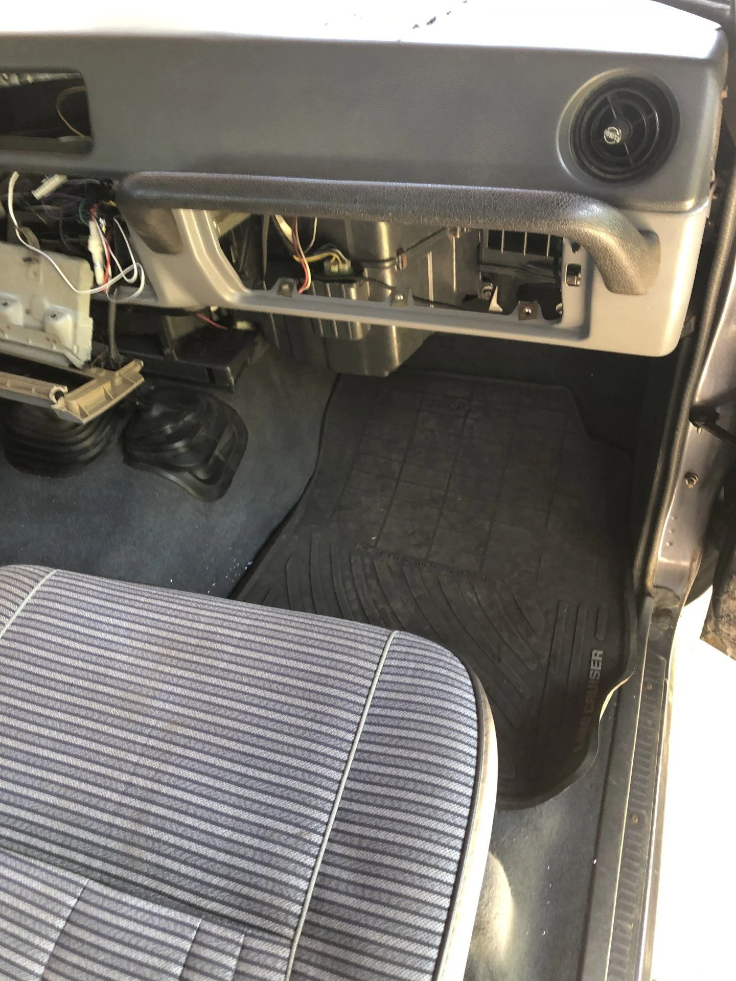

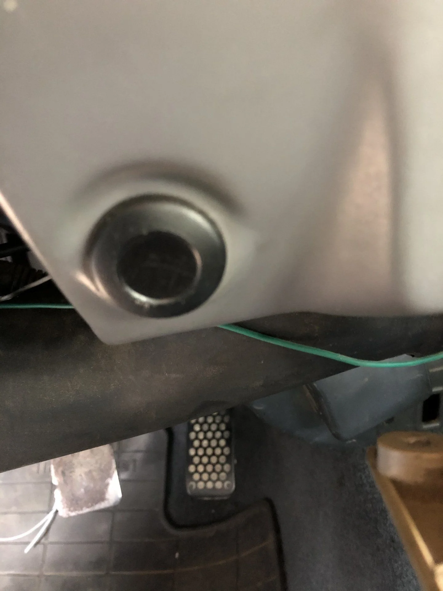

Finally had some time to work on a few things. I am at some point going to move this project to the shop and deal with issues from front to back. But for now, while it sits in the driveway, I will keep plugging away at some of the little stuff.

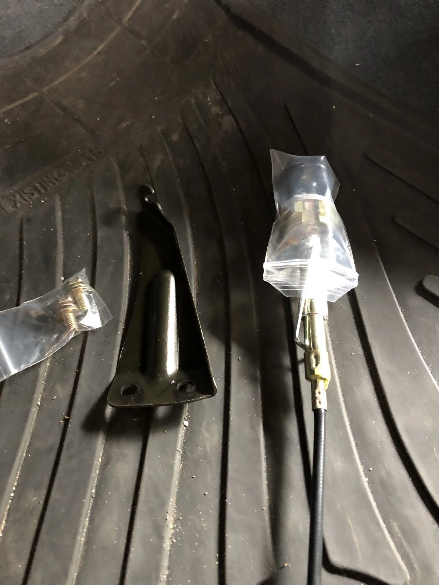

I had one of these hand throttles on a previous 85 FJ60. Always thought they were cool.
This is a 1 :banana: job. Or at least it should be.

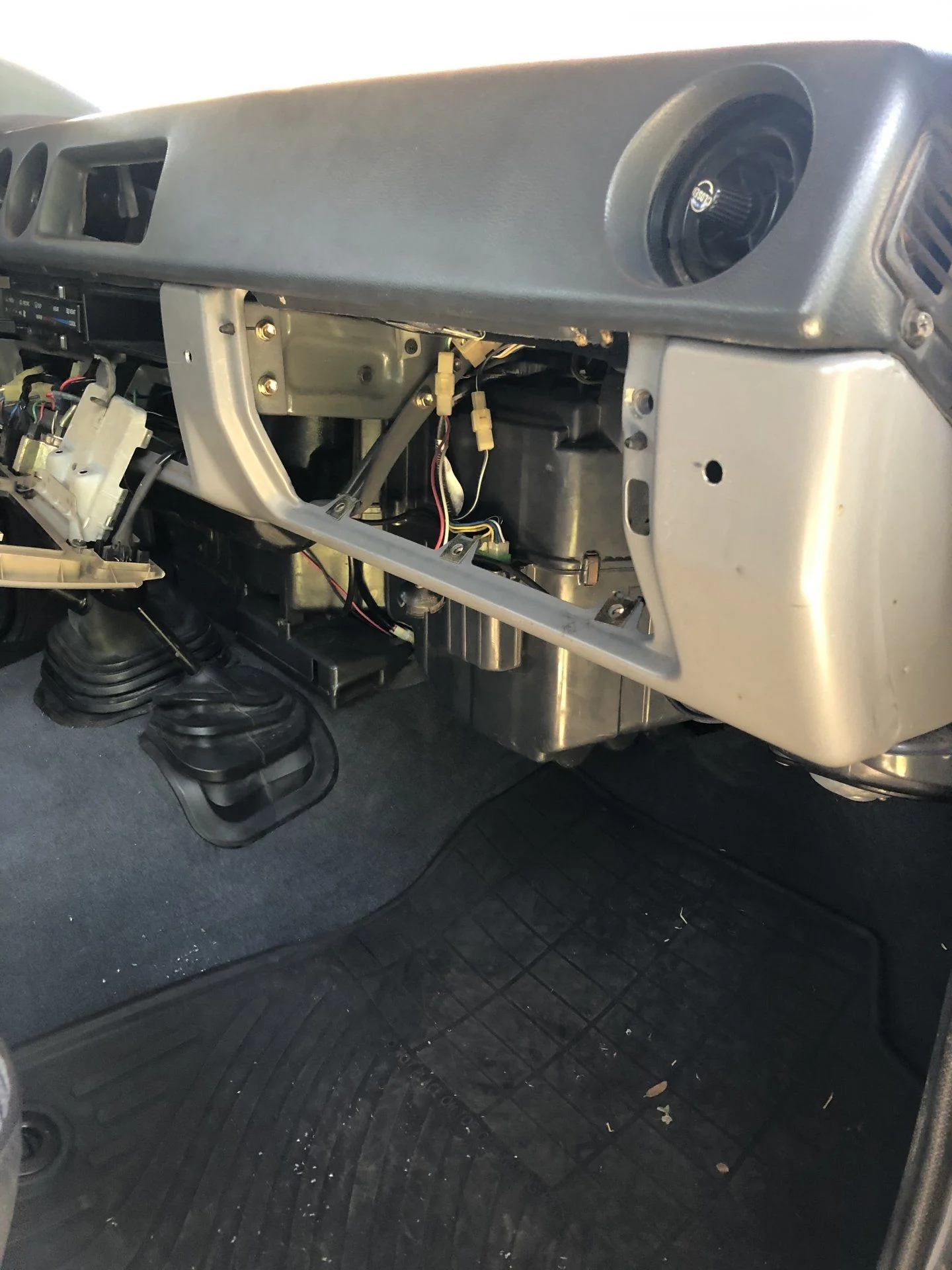

Remove the plug on the dash and slide the cable through. Use the included split nut to tighten it to the back of the dash.

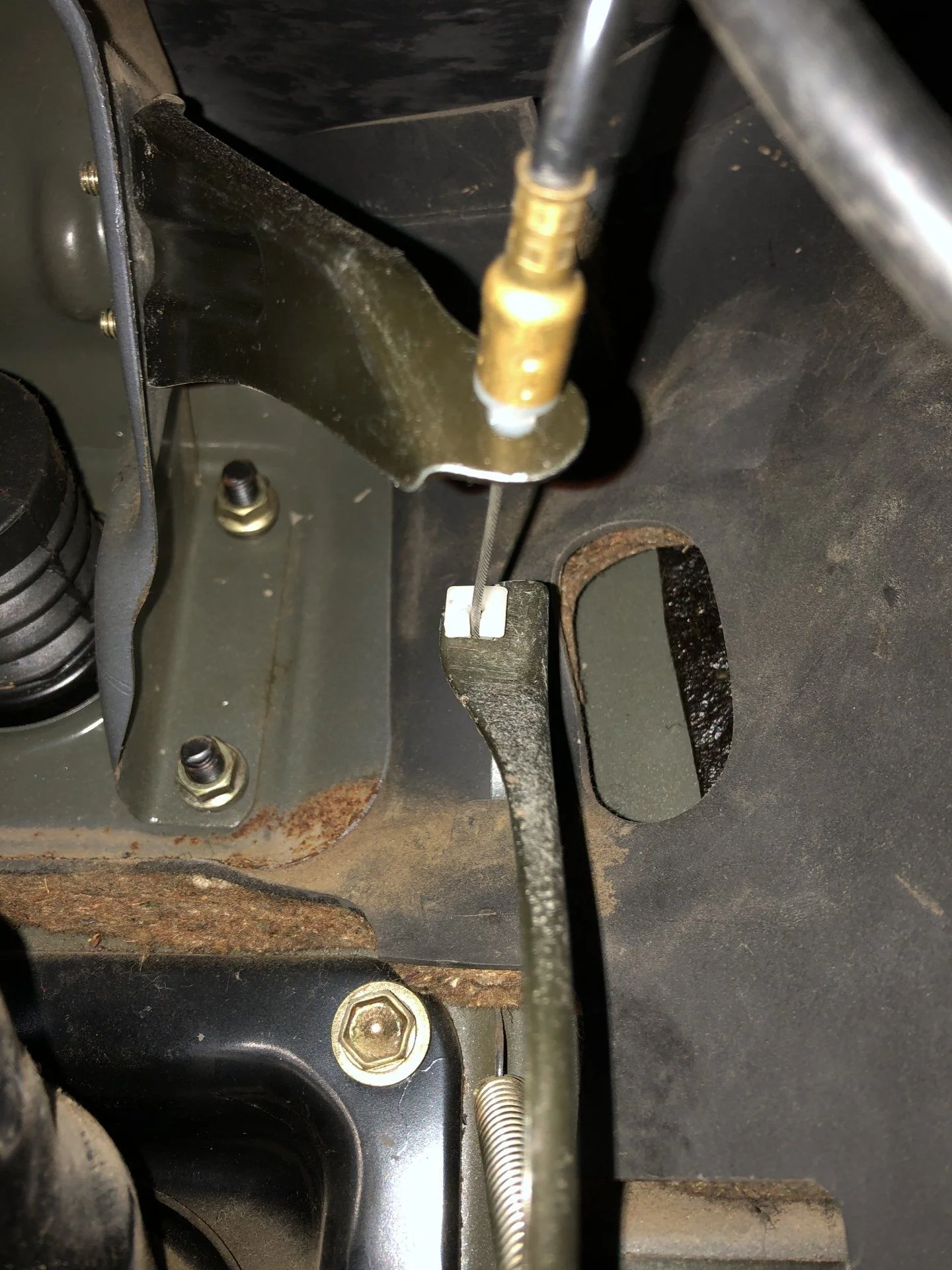

There are two holes near the top of the accelerator pedal on the firewall that the bracket bolts to. The fitting at the bottom of the cable slides into the bracket to hold the cable steady as it is being used.

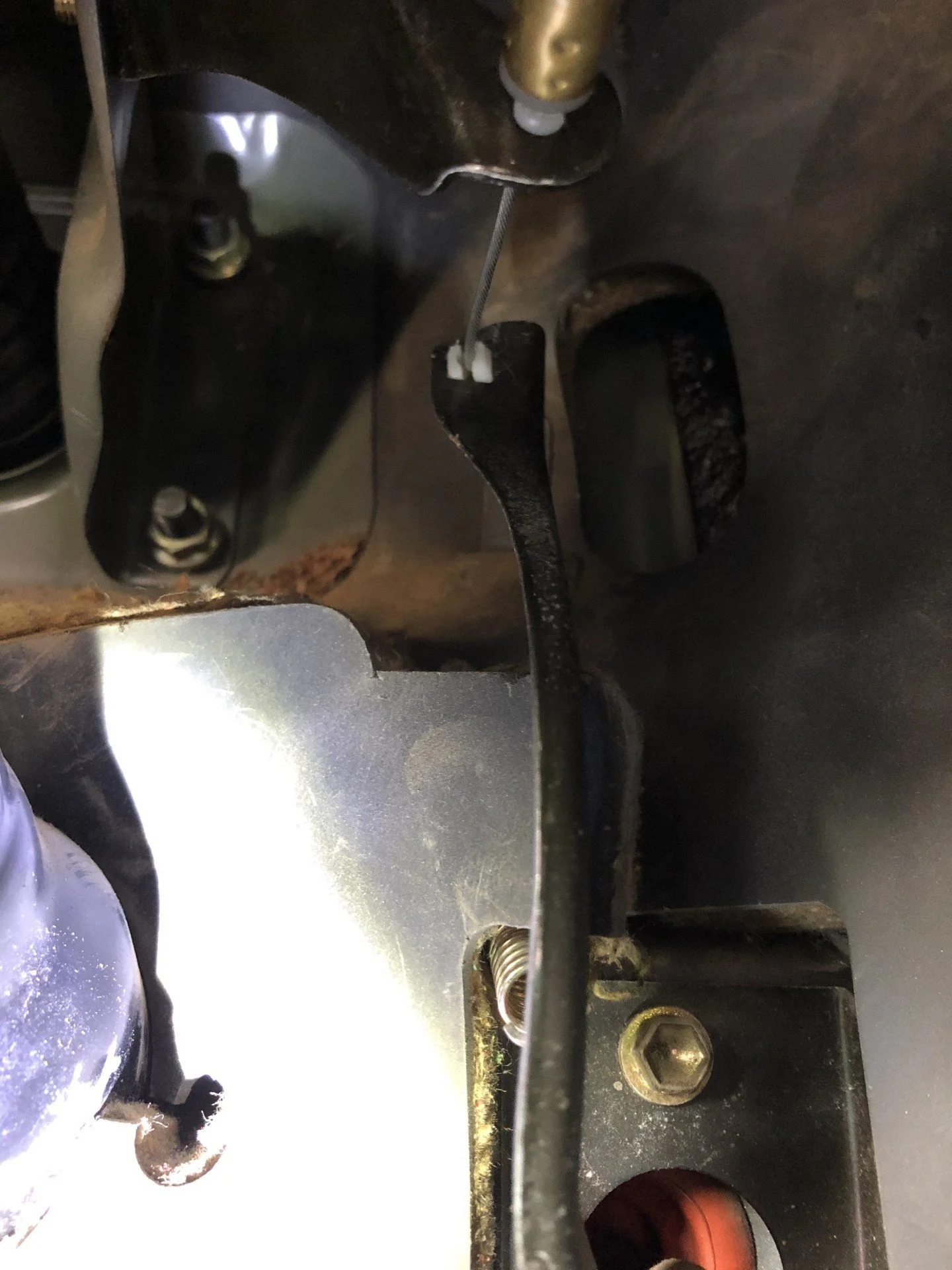

As you can see in the above picture, the end of the cable has a hammer shaped fitting that fits at the top of the gas pedal. The pedal has a split at the side of that hole that the cable will slide into. It helps to use your elbow to depress the pedal as you are doing this as it adds a little slack to the cable. After sliding the cable in, there is a plastic lock with a slit that slides over the cable and fits into the hole to lock the cable to the pedal.
I have attached the above picture as a public service announcement as to what not to do. Common sense will tell you that no matter how nice it looks with the plastic plug on this side of the pedal, just don’t do it.

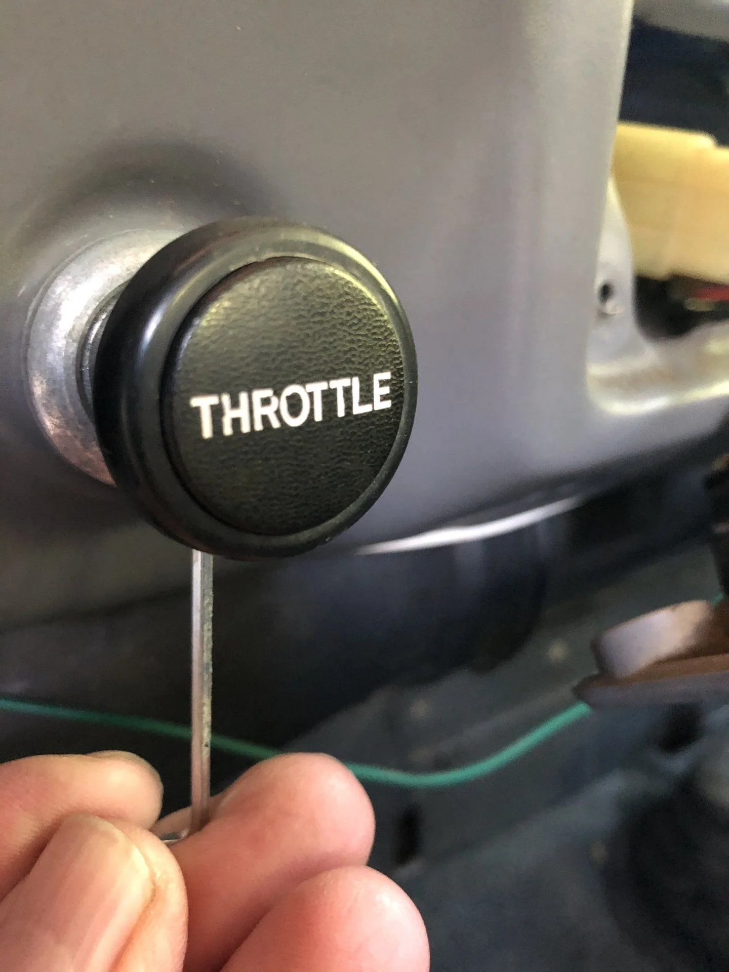

The cable included this Allen wrench to loosen the nut to allow you to adjust and straighten the pull.
Pull the cable out to test it and you should be done. Remember to turn the knob to release the cable so that it can be pushed back in. Like I said, 1 :banana: job. Unless, you put that clip in on the front side of the pedal (like the pic in the previous post) so that when you pulled the cable to test, it shoots to God knows where to never be seen again. Trust me, it will happen.

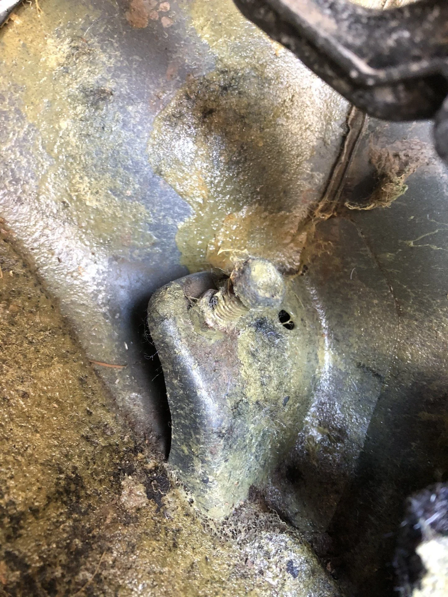

I spent the next hour looking for it. Pulled the carpet back and tried feeling into every crevice I could find. Finally! Success!!!!
It was hidden in the hole behind the pedal adjuster.
This is what it should look like.
