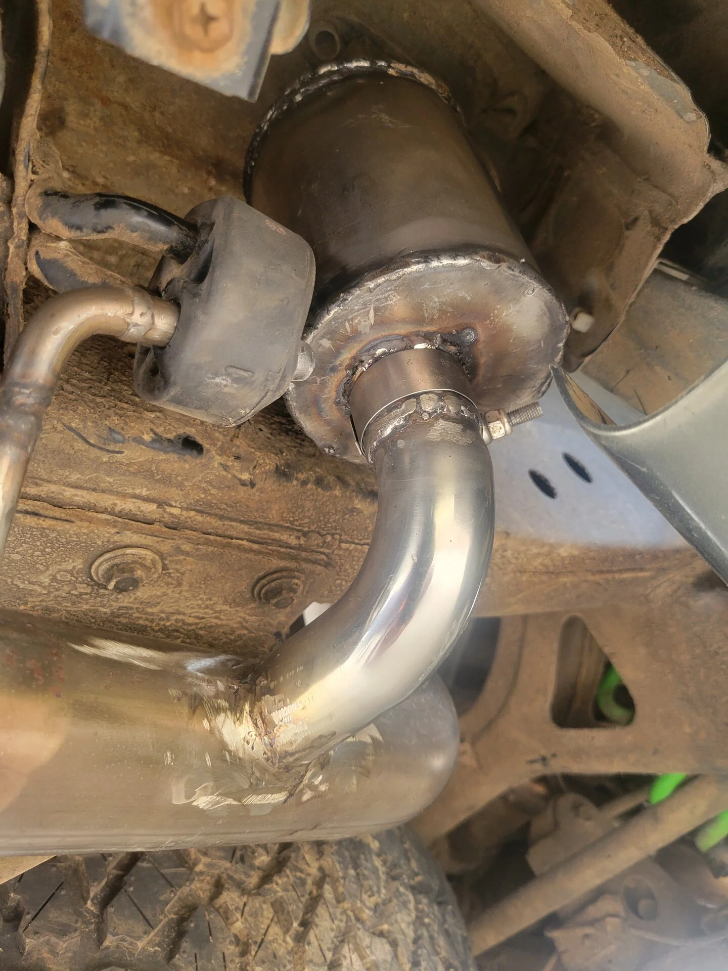

A Helmholtz resonator will take care of the drone. There is a good spot around a foot up from the tailpipe. My Borla is stock-silent at 70 mph after building a Helmholtz.

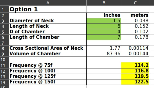

I used the spreadsheet/method listed below:
And I built the Helmholtz myself. There is some info in my build thread.
The whole process of killing the drone was quite a saga with a lot of trial and error. The end product and skills I picked up along the way were worth it.

Did the Helmholtz resonator work the first time based on the spreadsheet, or did you have to adjust it a bit? The spreadsheet outputs 4 frequencies based on the dimension inputs, each at a different temperature. Which temperature did you pick for your target frequency?
Thanks!
I designed it for (IIRC) a ~140 Hz frequency at 100F, since the actual resonator itself stays pretty cool. It works very well for the ~2,100-2,500 rpm drone I had and the exhaust is basically silent at ~2,300 rpm. Based on where I installed the resonator, there really isn't any room to make it bigger, so I didn't add any adjustability (although I had purchased a 4" band clamp to provide length adjustment if needed). If you can build it with adjustability, IMO it is a good idea.
Now that's it's been installed for around a month or two (and I've gotten used to it) I've noticed a ~1,500-2,000 rpm drone that isn't opressive (maybe 60 db, so quieter than the 2,100-2,500 rpm drone I had before) but somewhat annoying. I'm going to build a second, larger Helmholtz that ties into the tailpipe at the outlet from the muffler and sits on top of the muffler to take care of this other done and hopefully have a stock-quiet exhaust at 50-80 mph cruising speeds. These are really pretty easy (and fun) to build once the process is down. I'm still loving the extra power of the exhaust, so IMO it's worth the effort of building a couple of resonators.
