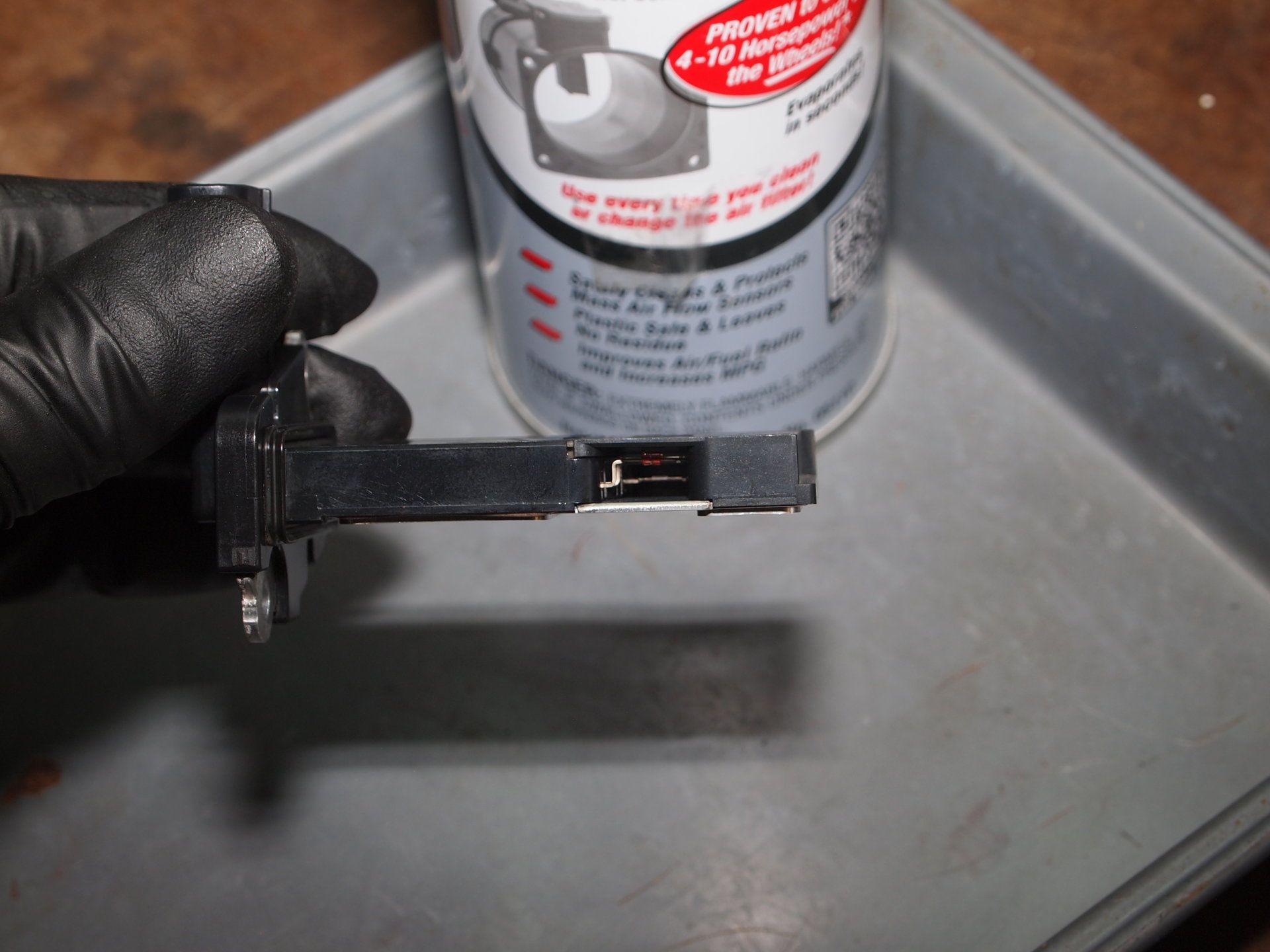

Two screws? Mine seems yo ave about 8 spring metal clips all around the four edges? Am I looking at the right ting or do you ave a differently model not a 100?
The MAF should only be attached by 2 screws. As for the metal clips you stated, you might be looking at the entire air box that contains the filter. This is the mass air flow sensor (not my pic nor is it a 100, but the part looks the same and is in a similar location along the intake piping):
