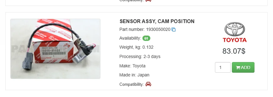

Hello all,
I am stumped, my original cam position sensor harness is a 3 pin/wire connector and the one I ordered directly from Bell Lexus with part number 1930050020 is a 2 pin/wire connector. It seems they updated this design at some point and didn't keep the original 3 pin connector. I can't seem to find anybody else that has also experienced this. It seems odd that Toyota would do this without keeping a similar design. Has anybody else ran into this? I am going to just de-pin this and re-wire and ohm out and attempt to reuse it but can anybody suggest the right part number for the VVTi 4.7?

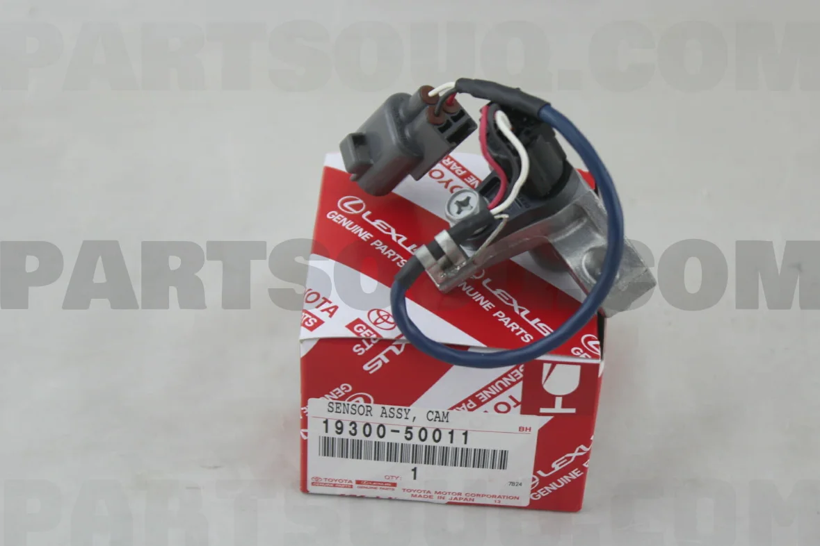

I believe I was able to figure it out, the GX part number looks to be the correct as it has the 3-pin connector for the VVTi 4.7. The part number is in the pic below. I hope this helps others with this oddity.
