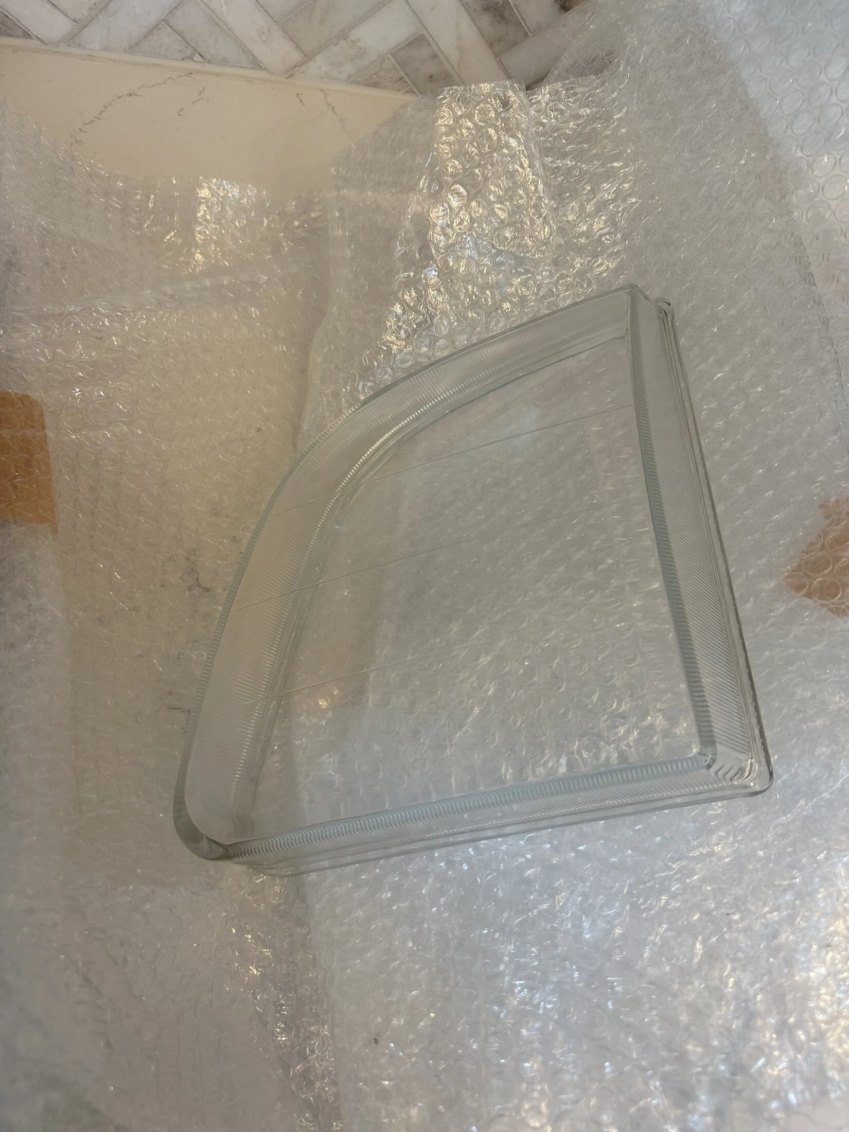

I ordered glass lenses from eBay, see link below. They shipped from China and took about a month to get delivered. One showed up shattered unfortunately, but the seller was able to send out a replacement at no charge. The arrived within about 2 weeks.
Glass Lenses Link: A Pair For Lexus LX470 1998-2007 Front Headlight Clear Lens Housing + Seal Glue | eBay - https://www.ebay.com/itm/275754569788
Shipping box from china and glass lens unpacked

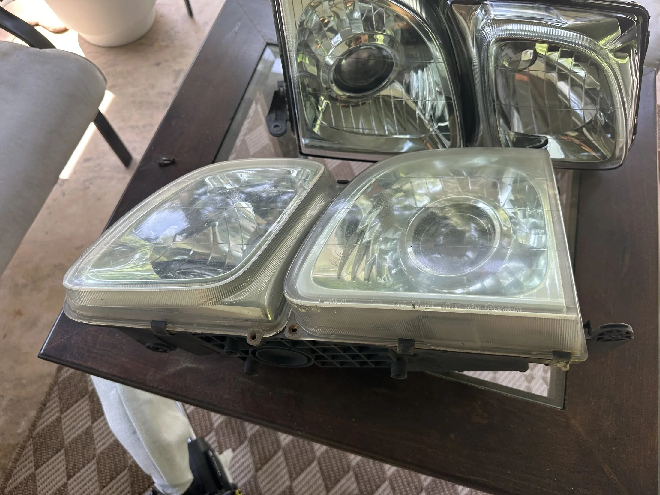

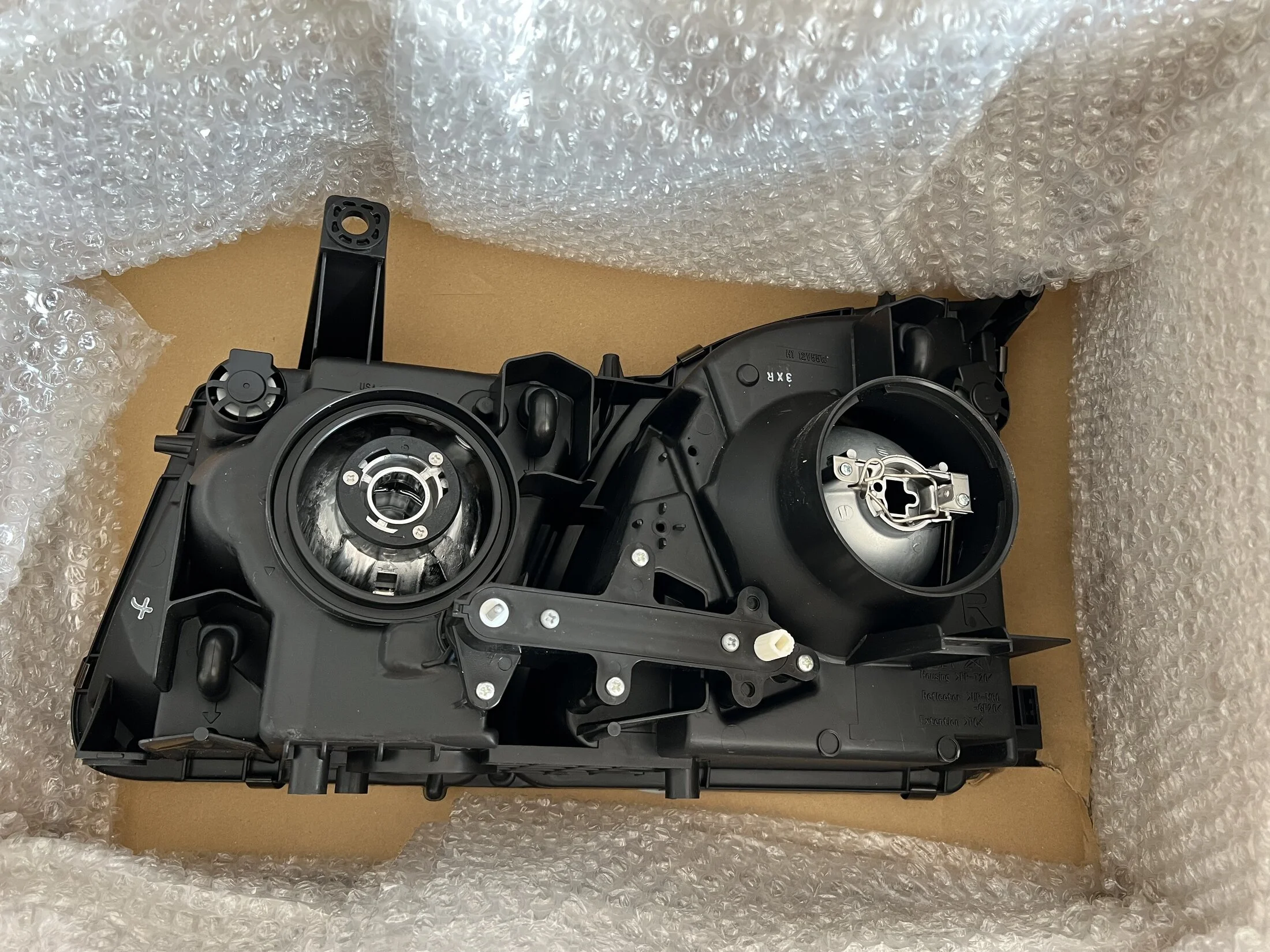

Glass in back, old polycarbonate in front. Screw holes with screws removed shown.
Lenses were pretty easy to remove after that. With the lens out, I used the provided headlight sealant in the grooves. I found that stretching out the sealant to a thinner bead worked fine as I wasn’t able to remove much of the old sealant. I then baked the headlight housing with the new sealant bead for another 10 mins at the same temperature to soften the sealant prior to installing the new glass lens.
Installing the glass lens after the sealant was warmed up wasn’t too difficult. I would recommend using the clips to help compress the lens into the housing and ensuring a water tight fit. I was unable to get one of the clips on due to having too much sealant in a section and it hardening quicker than I could compress the lens on. I’ll edit this if I find it to ever become an issue.

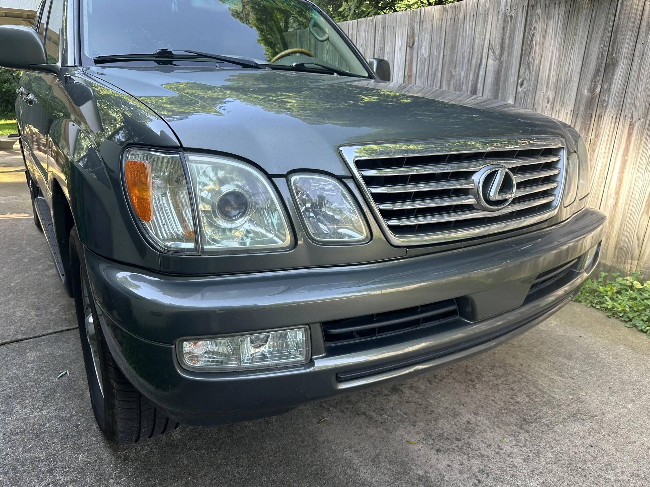

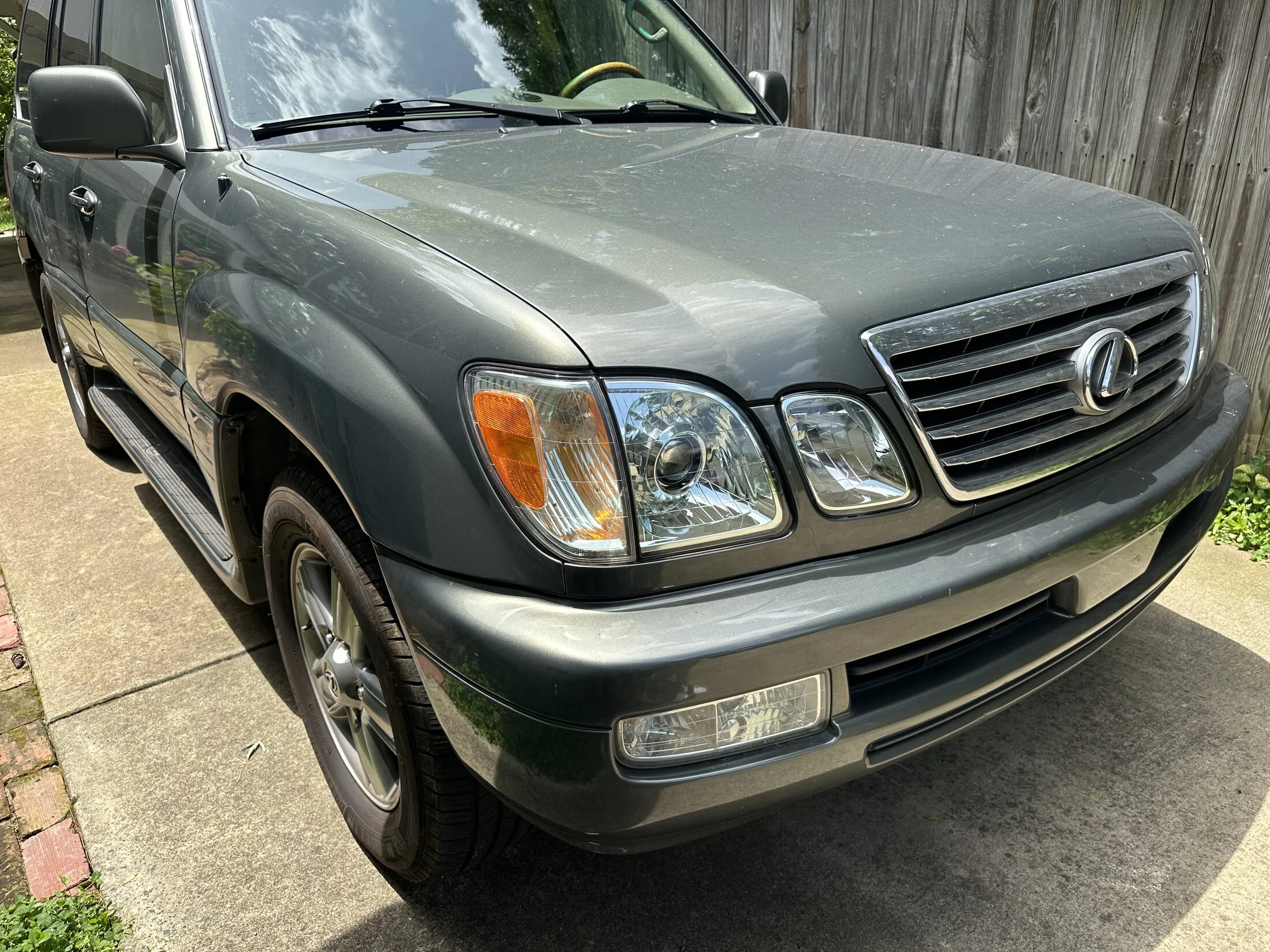

Before (let) and after (right)

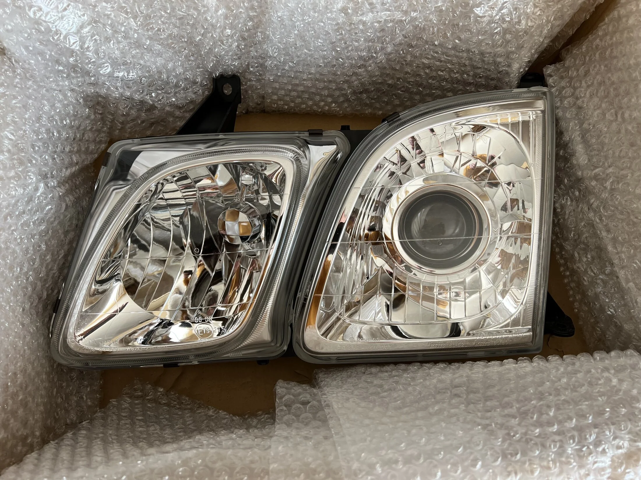

It turned out great. Did you feel the fitment of the glass was as good as OEM?
Yeah, fitment is near perfect. I was very impressed with how well the glass lenses lined up in the housing and the glass even had little lips in the right spots for the clips.

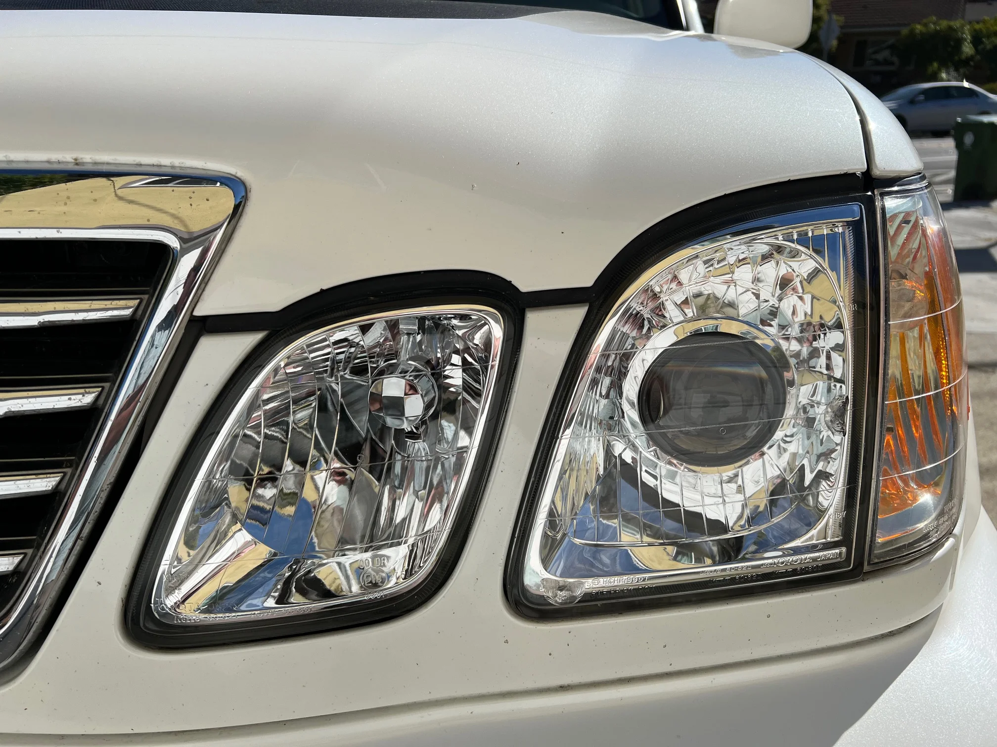

I replaced my bad polycarbonate lenses with new Glass Lenses i bought from Bell Lexus in Scottsdale. They worked beautifully in my 2006 LX470. I had them retrofitted with larger LED Projector Beams... Best modification ever! Unfortunately, I took some rock hits on the way back home to the SF Bay Area and experienced some damage. I was basically a day late, but ordered up and installed the thickest glass protection film I could find... WeatherTech LampGard. The film fit perfectly and went on easily... and so far, no further damage.

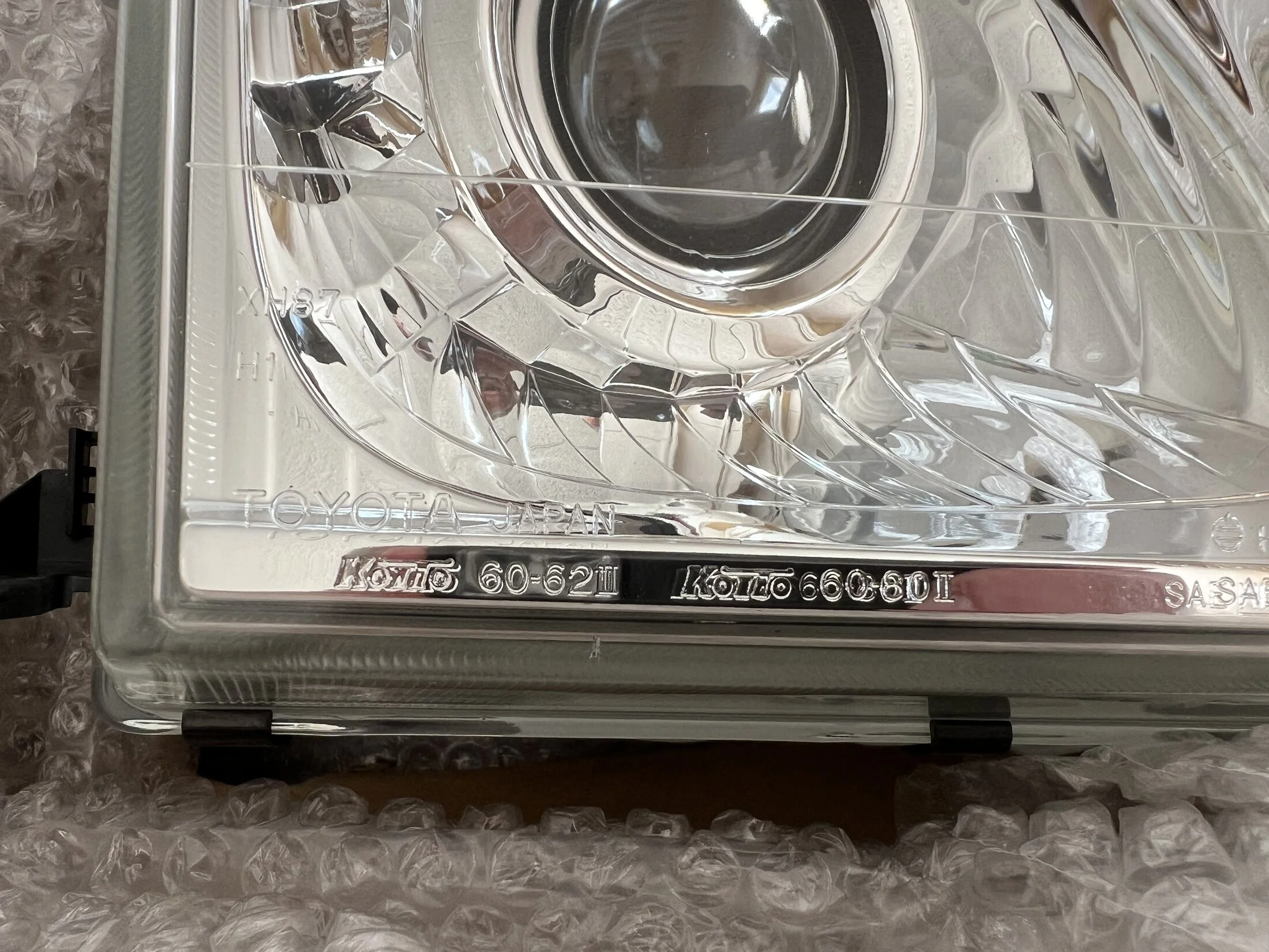

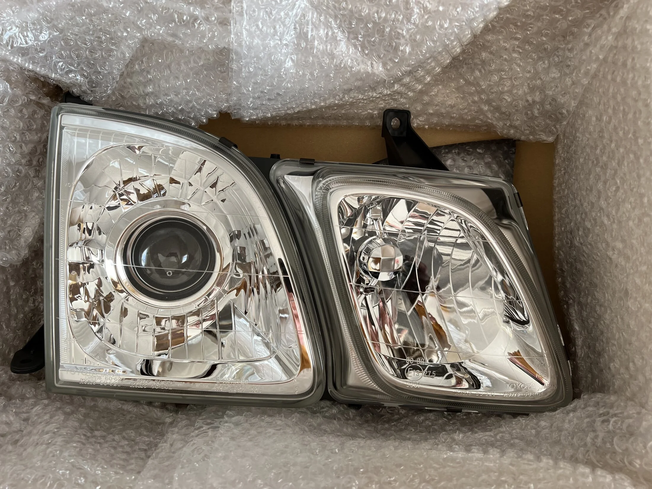

I bought OEM Glass front headlights directly from a LEXUS Dealership. These are stock for the early years of the LX470 but they fit perfectly in the later years. Mine now sport the way brighter oversized LED projector beams.
Part#? I have a 2000 Landcruiser with rock chips in the glass headlights. I looked up the replacement and got 4 part numbers with no mention of which are glass.

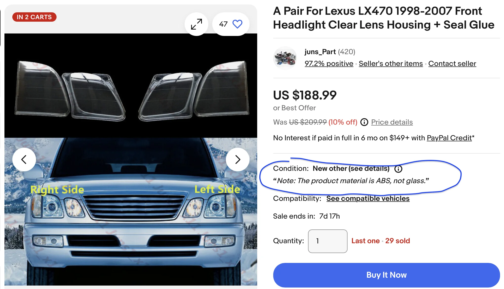

I contacted multiple sellers with the same eBay ad for the glass and they all tell me it’s plastic..poly.. no glass. All pics for all sellers are the same.. they all look like poly
@ronnunan One lenses that I had originally shipped had shattered during shipping, definitely seemed like glass. Sellers replaced it really promptly and the lenses are still looking great today.
@gwilsterman The eBay ad you linked in the first post specifically says....
