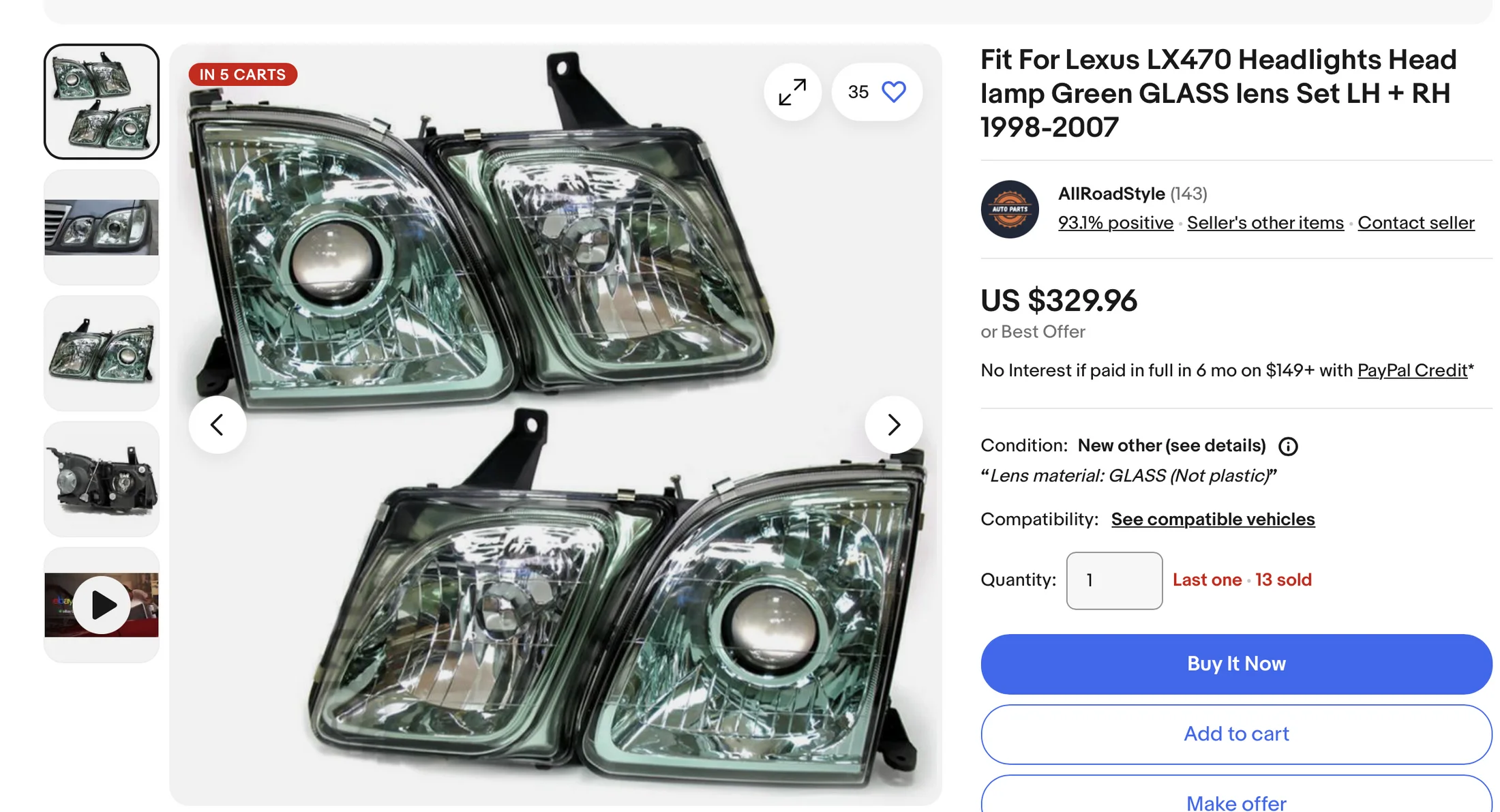

These are aftermarket and specifically say "Glass, not plastic." So somebody must offer the glass lenses a la carte.
I’m struggling to find glass replacement lenses. So far:
- I ordered one from AliExpress. Listing said “glass” but a plastic lens was delivered.
- ordered another from eBay. Listing said “glass” but seller shipped plastic.
- I contacted roughly 10 other eBay sellers where the listings were unclear about the material or they said “glass”. Most returned my messages and all of those confirmed “plastic” (despite their listings saying “glass”). It seems clear that Chinese sellers simply copy and paste verbiage with no regard to accuracy. I’m actually pretty aggravated by this since it’s a form of bait and switch.
I really don’t want to have to buy entire Chinese aftermarket headlights just to get glass. Also can’t afford to pay dealer pricing if I’ll just end up breaking another lens on a group run.
I’m open to any advice at all…
