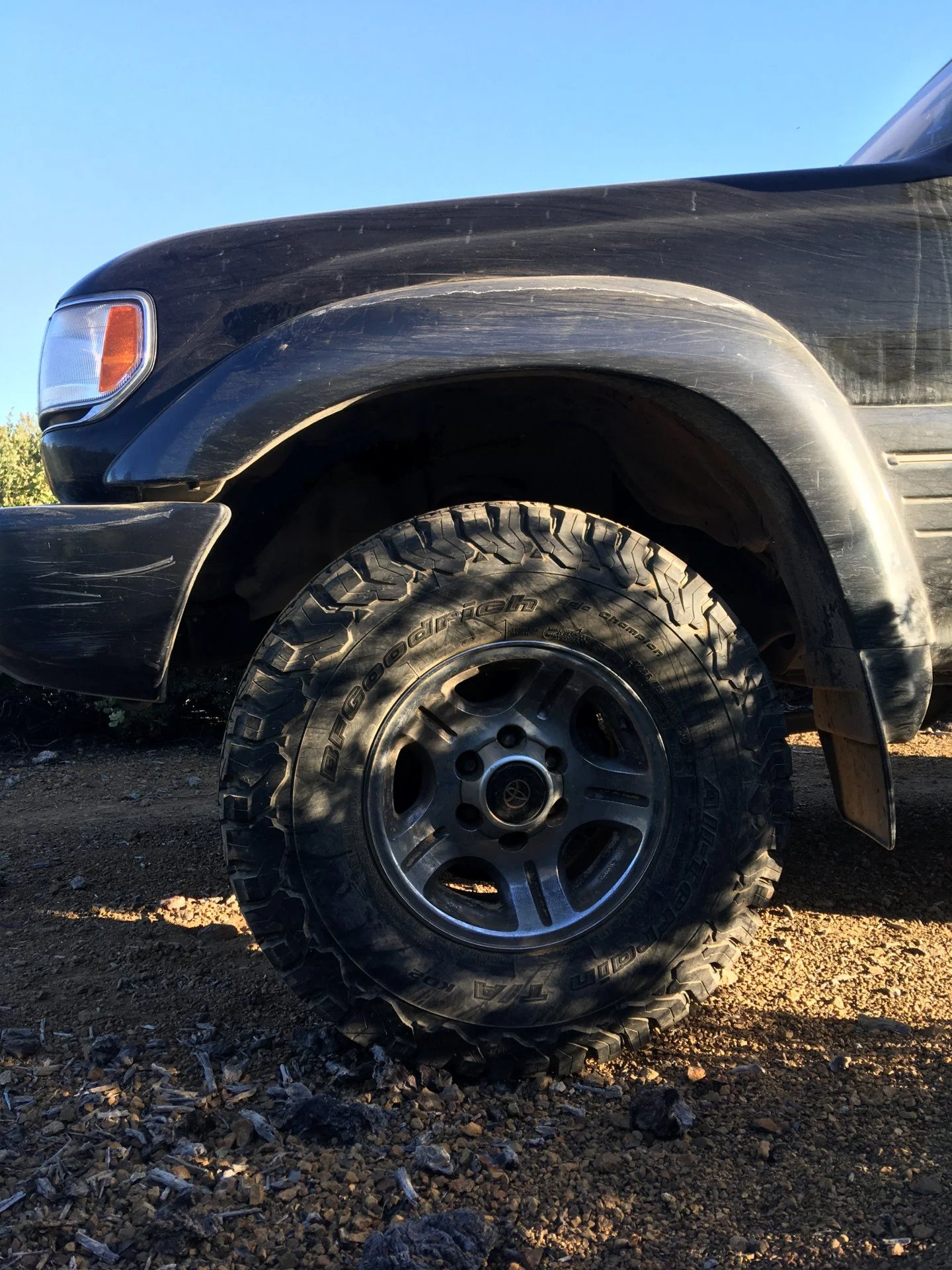

So i got an OME 2.5 heavy lift kit from bilstein which arrived day before yesterday (OME 2.5" lift kit for 80 series 1991-1997 Toyota Land Cruiser) I got too excited and threw it on right away, which of course would look silly with the stock tires so i also added 285/75/16 BFGs to my adventure. Stock wheels. No casters or spacers were used. I gave it to a shop because i cant lift it in my hangar and even if i could its way out of my expertise.
Now the sun has just risen on me sitting on my hood in the middle of big sur wondering where it all went wrong! There is definite rubbing on tight turns with compression in the front. On paved roads even. Where does it rub you may ask? Good question - how does one know? Im still running stock bumpers and i put mud flaps on when i took off the running boards so those are a good suspect, but they dont look like theyre touched (mud undisturbed). Maybe the front bumper but ditto on being hard to tell.
To add insult to injury, there is a terrible clack thats coming from what seems like the arena of the steering stabilizer bar on the front.
Yes, maybe i shouldnt be allowed to modify anything anymore but im trying to view my mistakes as happy accidents. If i dont do anything i dont learn anything, right?
Anyway appreciate any advice about whether this is a major / minor issue that a) can be fixed by swapping out coils to lighter ones? b) happened to anyone else with 285/75s c) indicative of incorrect install and i should drive it home immediately.
I know, i know, search function still works but im on my boyfriends phone bc mine doesnt have reception and after 2 hours of the clickety nothing is helping - seems like a lot of opinions out there.
Ill be having the boyfriend drive it around when he wakes up to see if i can watch the rub and clacket so stay tuned, but i figured ill throw this on here sooner than later.
Check the steering arms at full turn for signs of rubbing. Look for the spot that looks clean to find the rub.
35" tires work well with the 2.5" OME lift. Several guys in the local Cruiser club using that setup, but may require a re-gear to get back into the power band.
Can't help with thew rattle, but you got the Heavy Kit, so it may ride harsh. That kit is for overlanding rigs with armor, bumpers, sliders, roof rack, drawers and usually a tent. It MAY smooth out a bit once you add the weight, but I'm no suspension guru by far, just going off of what I have read here.
Check that the fan isn't contacting anything and that the oil cooler, steering cooler and stock little armor plate under the steering stabilizer area were all secured properly.
It looks like the source of the clacket is that the steering stabilizer is bottoming out and hitting whatever the bar is thats directly behind it. Maybe time for me to learn what a castor is?

As far as that rubbing issue you should see some wear marks on the frame, plastics where it is rubbing. I went with the same tire as you but in 315/75-16. The only time I rub is when I come out of a steep driveway and on the compression of the STOCK springs/shocks it rubs the fender flares. I am sure that after the suspension lift that issue will go away.
I got the OME medium 2.5" lift springs and shocks, steering stabilizer and the caster correction plates. Same tires, BFG 285/75 r16 on stock wheels. Drove it for a month before installing the plates (waiting) and did not experience any rubbing or noises. As a matter of fact, thought about not installing the plates but did it when they came in anyway. Heavy versus medium might make the difference but I tend to think not.

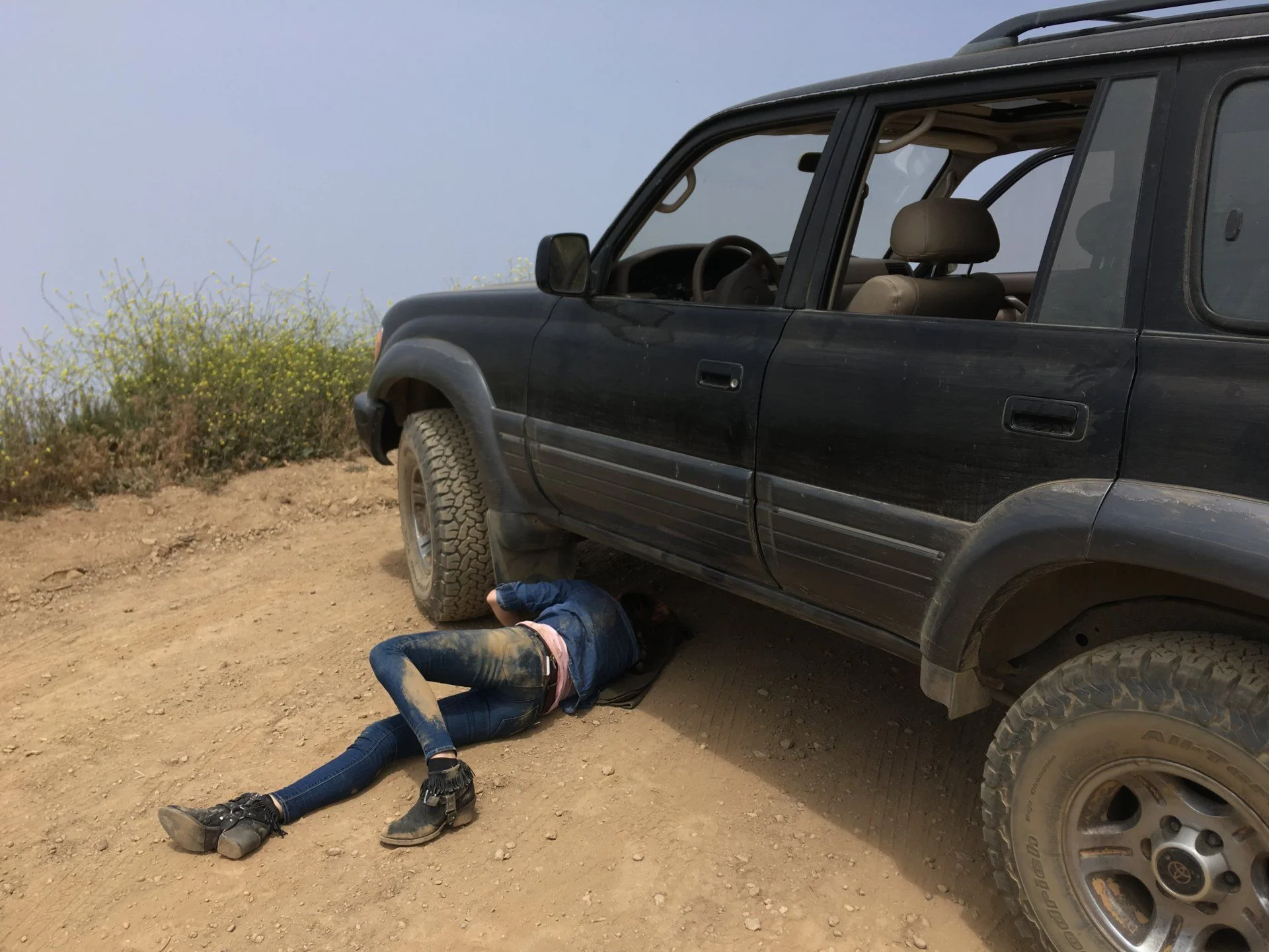

Well guys - Mystery solved when we heard a loud clank and a bunch of parts fell out. Turns out the shop cross-threaded the top bolt on the left front shocks and didn’t even bother screwing the nut all the way on. The whole bushing came out on the road and my guardian angel made sure we found all the parts.
Took 4 hours and a lot of dirt to Mcgyver that thing back on given the crossed thread ensured the whole shock turned with the nut.
Feeling like I should have just gotten a jack and done this thing myself because I think I could have done a better job than those jokers ;(
Well guys - Mystery solved when we heard a loud clank and a bunch of parts fell out. Turns out the shop double-threaded the top bolt on the left front shocks and didn’t even bother screwing the nut all the way on. The whole bushing came out on the road and my guardian angel made sure we found all the parts.
Took 4 hours and a lot of dirt to Mcgyver that thing back on given the double thread ensured the whole shock turned with the nut.
That fxxxing blows. I would take it right back and have them fix it or at least buy you a new shock.
Sometimes doing the work yourself isn't just to save money. It is to make sure no corners are cut. Glad you figured it out. Usually it is pretty obvious early on when threads get crossed.... 4 Hours and it looks like your environment wasn't the best for doing repairs. If you take it in to get them to fix the mistake, I would ask they not be allowed to use an impact wrench this time. I am thinking they didn't get the nut started properly and just run the wrench till it stops turning.. in this case until it is bound up but not screwed down.
