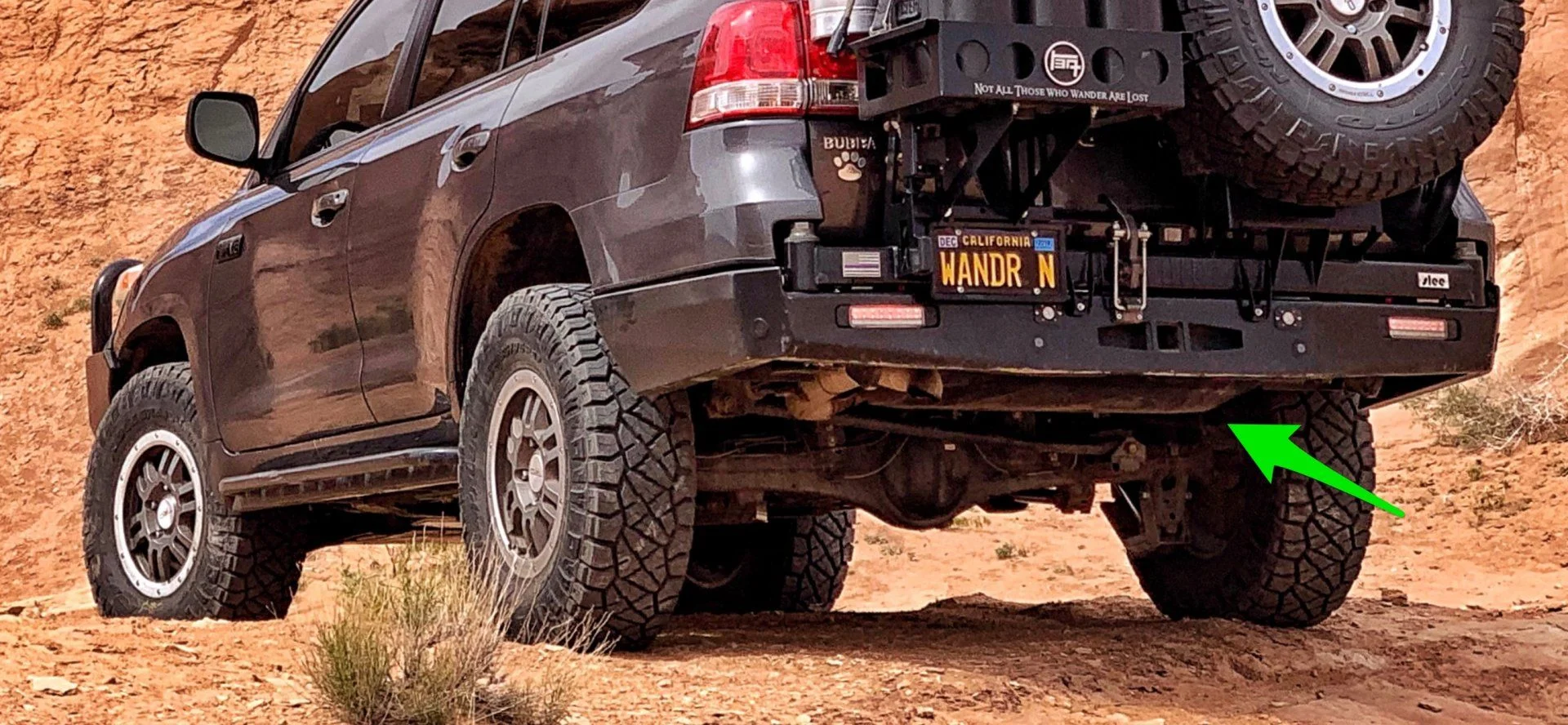

Here’s the 24 with my Slee. No one ever notices it’s even there...
Super tucked...and what you see at the arrow below is the more forward part. It actually slopes upward and higher (more tucked) toward the rear bumper.
Here:
