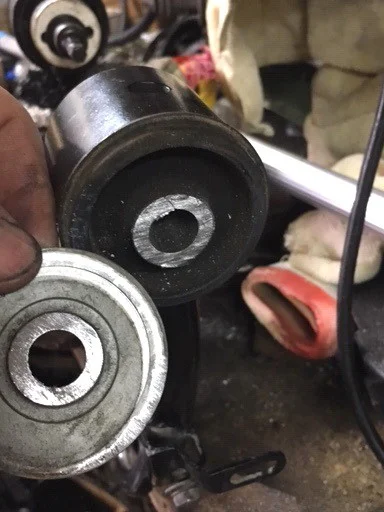

  • Place the Upper Control Arm (UCA) in a vice and with a hack saw remove the outer cap on both sides. This is in preparation to using a holesaw (deep 1-5/8") to core out the rubber bushing.
Use a deep holesaw mounted in a 1/2" drill to core out the rubber bushing. This will allow you to use your hacksaw to cut a single kerf through the 'shell' of the bushing.
Continued Below:

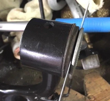

Remove the blade from your hacksaw, insert it through the shell of the bushing, reattach to your hacksaw handle and saw a single kerf all way through the shell of the bushing. STOP when you are all the way through and don't start cutting into the control arm bore.

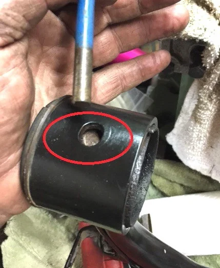

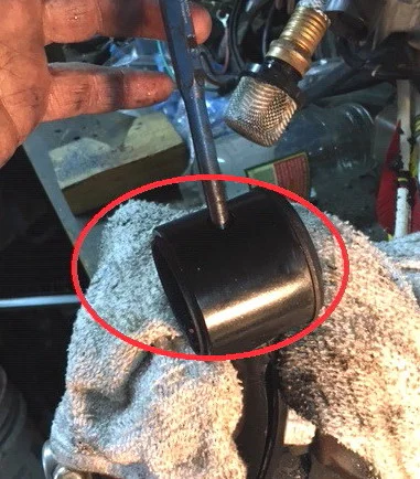

Once you've done that....please note there is a hole in the control arm bore....USE IT. Take the largest flat point punch that will fit through the hole and with a hammer tap the bushing shell inward so that it deforms and relieves the 'press fit'.
Provided your bushing hasn't rust welded itself to the bore of the Control Arm, you can now tap it out with a drift punch/other. Even if it is rusted to the bore....you've still won the battle at this point. Just use whatever is needed to get between the shell and the bore wall and it will come out.

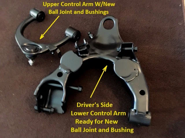

Now.... thoroughly clean the bores of the control arm. Use a press (I recommend a floor press) to remove and install the new ball joint. Lightly grease the shell of the new bushings and press them in. They go IN a lot easier than they came out.
