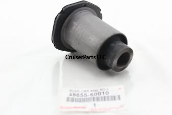

Is ths rear bushing is included with the oem LCA? I see this bushing is list3d separately from the lca arm. I am going to do all oem control arms all around except front upper arm, but will install oem bushings there.
I do not believe so. Only the front bushing (comes installed) in the arm.
Nope.
