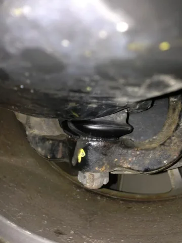

Noticed this evening I had some grease exposed beneath the lower control arm bearing. Is this normal after installing a lift? The land cruiser is a 2006 with less than 50,000 miles.
Could something be wrong with how I installed the lift?
I have over 100K on my 2000, I do not have any leakage from the lower ball joint boots. Although they are shot, they are not leaking. Clean up the grease and keep an eye on them. As you lift the front end of these trucks, everything starts running at excessive angles, you may of torn, or pulled the boot off.

This grease showed up only after installing the lift (OME T-bars and shocks, diff drop). The land cruiser has been parked in the garage for about 2 weeks and only driven (maybe at the most) 5 miles since the install. I recall seeing some seepage after installing the lift and wiping it off (this was maybe a week ago when I was underneath measuring the diameter of the CV boot housing). Chalked it up to just seepage due to differing angles resulting from the lift. Was under the land cruiser last night cleaning things up and noticed more seepage on both sides. The land cruiser has not been driven since the last time I noticed the seepage and wiped it up a week ago. I inspected it thoroughly and it does not appear to be running down from the CVs.
So, are the lower ball joints sealed bearings. Anyway to regrease them or verify the appropriate amount of grease is still present?
You can replace the boot which gives good access to re-grease the ball joint. The boot may have filled with air if you separated the lower recently and is just purging the pressure. Boots are cheap, you may want to open it up and have a look.

I would just wipe that and watch for it to continue to seep. When you lift a truck from the height it has been riding at you will disturb some of the 'seals' and get slight weeping like that. To be honest, that boot looks really new and is likely not needing to be replaced.

Good advise^^^^^^^^ not likely to disable you on the road IMHO. Provided you inspect periodically and be aware of feel in steering & sounds. Although voids warranty with the aftermarket parts on.
Anytime any modern vehicle is modified one must expect more maintenance & repair issues, its a trade off.
Note: "Inspect"; torn boot, ball joint play test, note amount of grease loosing and listen for a dried out ball socket it many creak, but not likely for many miles from now.
