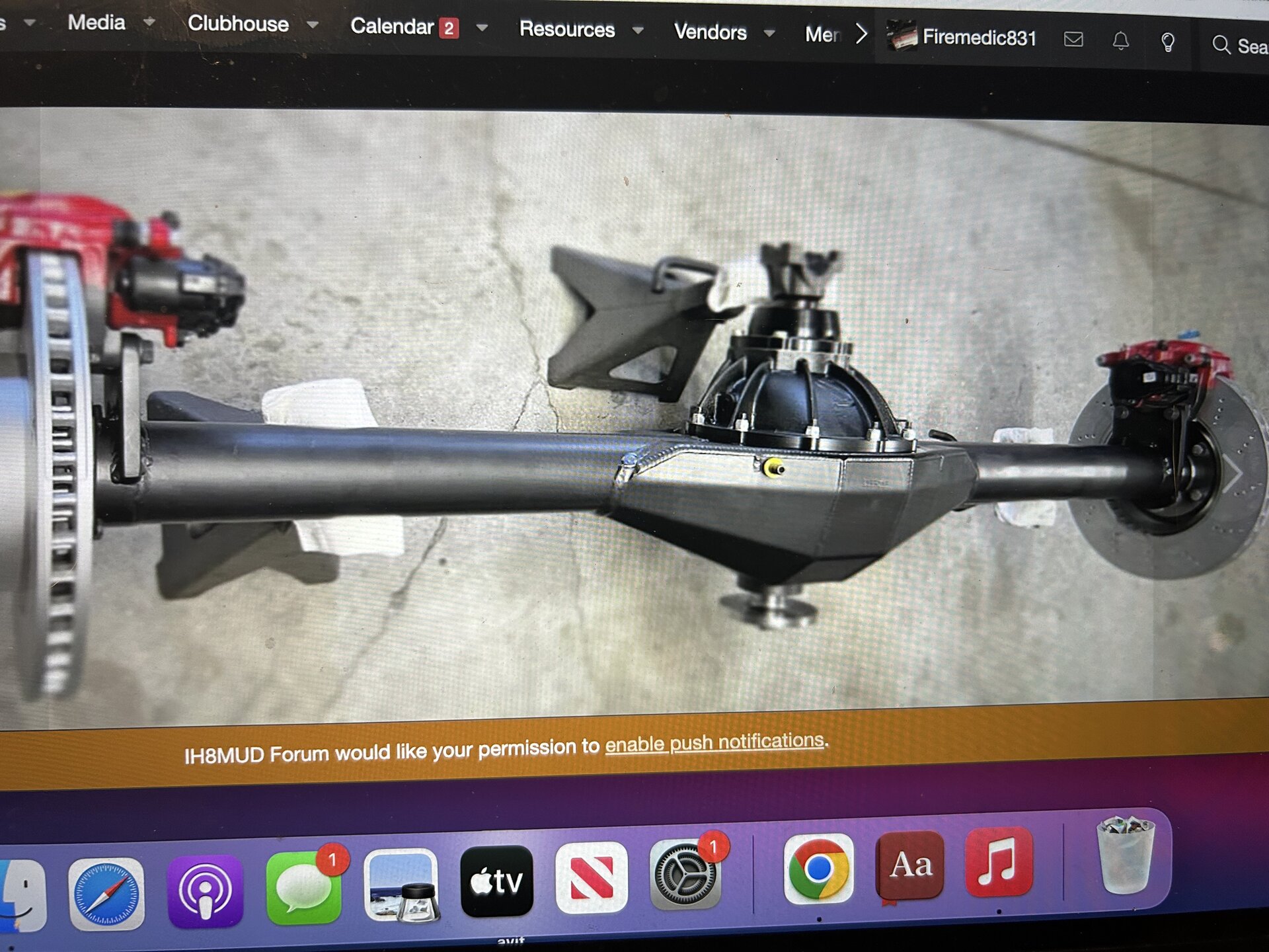

I think peezy ment something like this .

Front Range Built the housing i am 99 percent sure i can ask what he did .

GLTHFJ60 thanks mate your talking 6x4 mate, mine was 6x6 done poorly in the way White stripe is talking about which means an early non floating hub diff was used, the backing plate was unbolted and a second third member was used they removed the bearing caps and ground out the rest of the journals leaving in the pinion, and bolted it in the rear which then drove in reverse, then the rear of the rear diff housing was removed and welded back on upside-down then the center put in up side down so it would drive the correct direction, and they couldn't work out why it was noisy, (the second pinion driving from the coast side of the teeth on the crown wheel causes it to be noisy which is ok for a shooting rig or paddock basher but not on the road) all the other pictures in the replies without the front box on them, are ford nine inch very close to what I'm building. Over here we use a Detroit locker built into the rear of the front rear diff to deal with windup (6x4) mine will have a disconnect air operated at the rear instead of Detroit looker, and locking hubs on the rear diff making mine a true 6x4x2 wheel drive so I will spend most of the time in 2wd and select 4 or 6wd as required and also will be fitting ARB air lockers to all three diffs should be a handy unit
