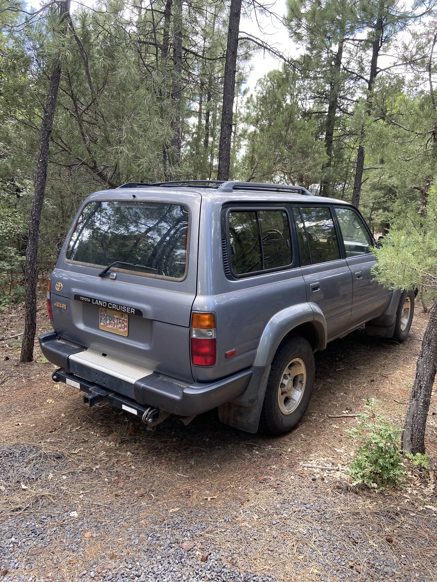

Awesome inputs and thanks! 1st job in line is finishing 8 rib upgrade on my ‘03 supercharged Marauder, but getting close on that, then onto the leaker LC. I will post photos as I go. Again, many thanks
-KK
When he mentioned posting pictures, he might have meant of the underside of the engine and transmission bell housing, since that would make it considerably easier to help you diagnose where the oil is leaking from, but hey... nice cruiser in the pines!
