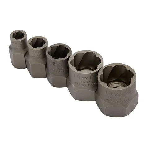

Irwin Bolt Extractor
These things grip a stripped bolt head, rusted bolt head, or if the head has been cut off, a smaller one will grip the shank of the bolt.
These and heat it up then cool down real fast wd40 I can't us pb blaster makes me puke let soak in then heat again cool down real fast wd40 soak then heat use tye above socket go slow if it starts to stop stop then reverse then soak and try and loosen. Don't break the bolt off or you won't be able to put the new shock on without more work.
