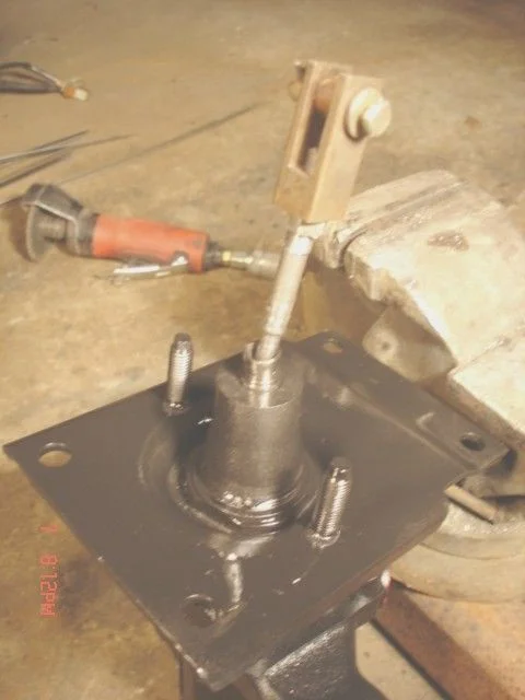

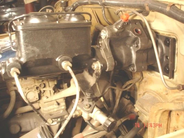

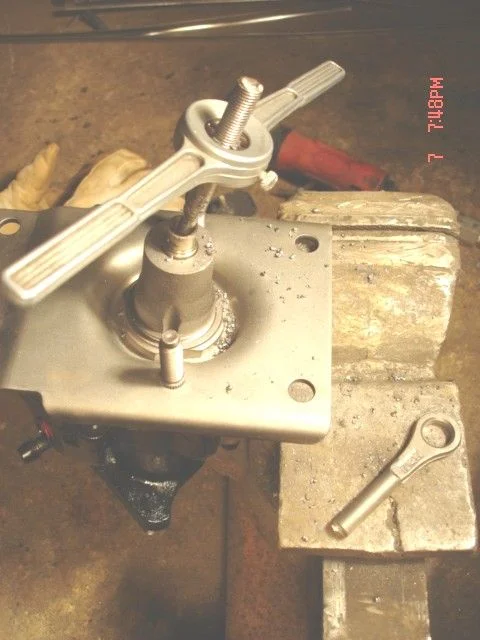

What's the advantage of the Astro unit over the common GM style off an 80's Chebby truck? I'm running a unit off a CUCV military truck, reflowed by powerbrakes hydroboosts vacuum boosters everything for your extreme braking needs for hydro-assist steering. You need to drill 2 mounting holes in the firewall, cut the plunger, run a die over it to hold the nut/ brass ubolt that mounts to the pedal. On my 40, I had to fab up a spacer plate cuz the plunger depth to pedal distance was too deep even after I cut it all the way down. You may not need to do this if your measurement is closer than what you see in the 2nd pic. Didn't need to do that on the :pig:
