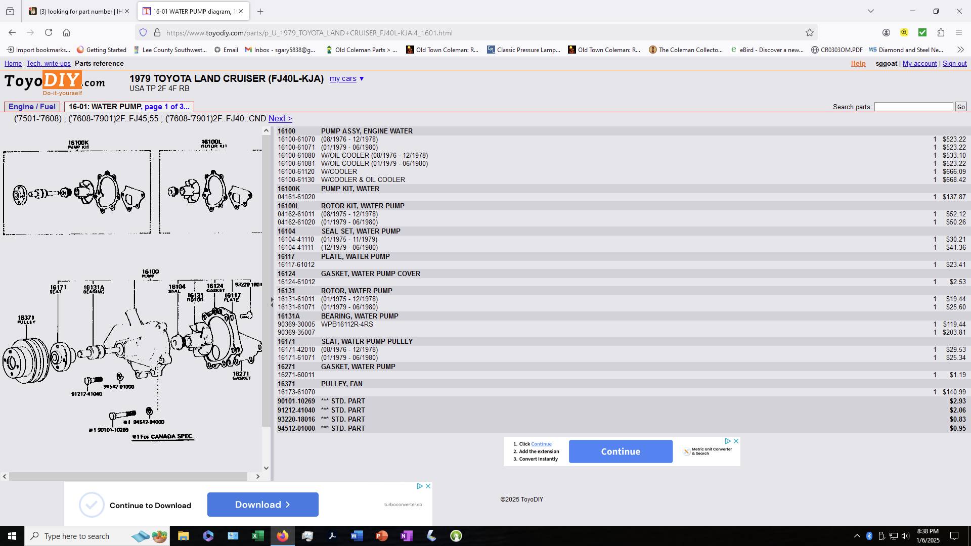

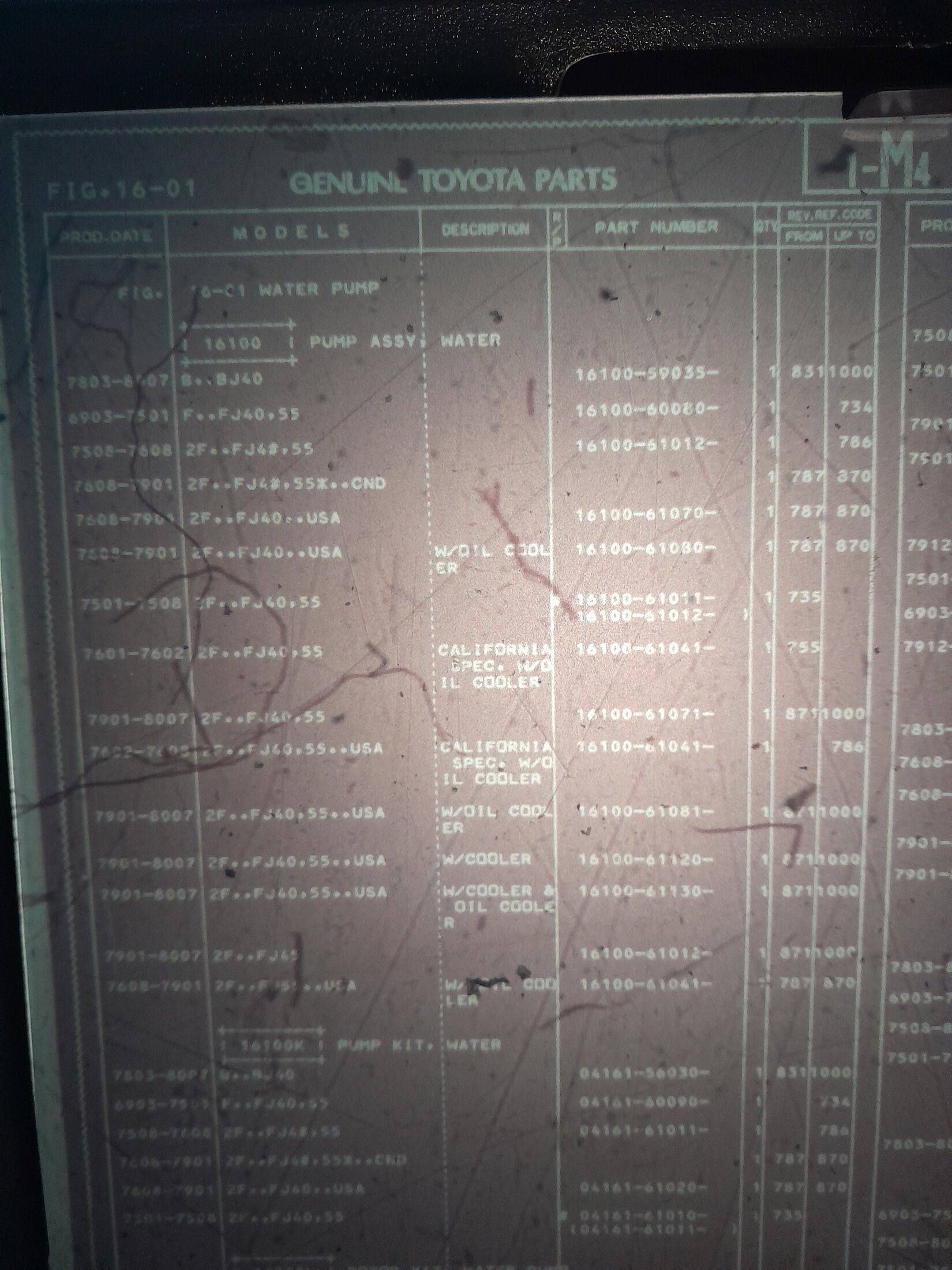

You actually need to clarify if you have a fan clutch or direct drive fan since you note you do not have an oil cooler.
Thankfully I read contracts better than thread posts....usually.He said no FC above.
maybe this---
thank you allThat's for a 1979, every one of those listed are irrelevant to his 1977 w/o oil-cooler and w/o fan-clutch fwiw. The links posted above are the exact units necessary for a F/2F running a plastic fixed blade w/o oil cooler.
