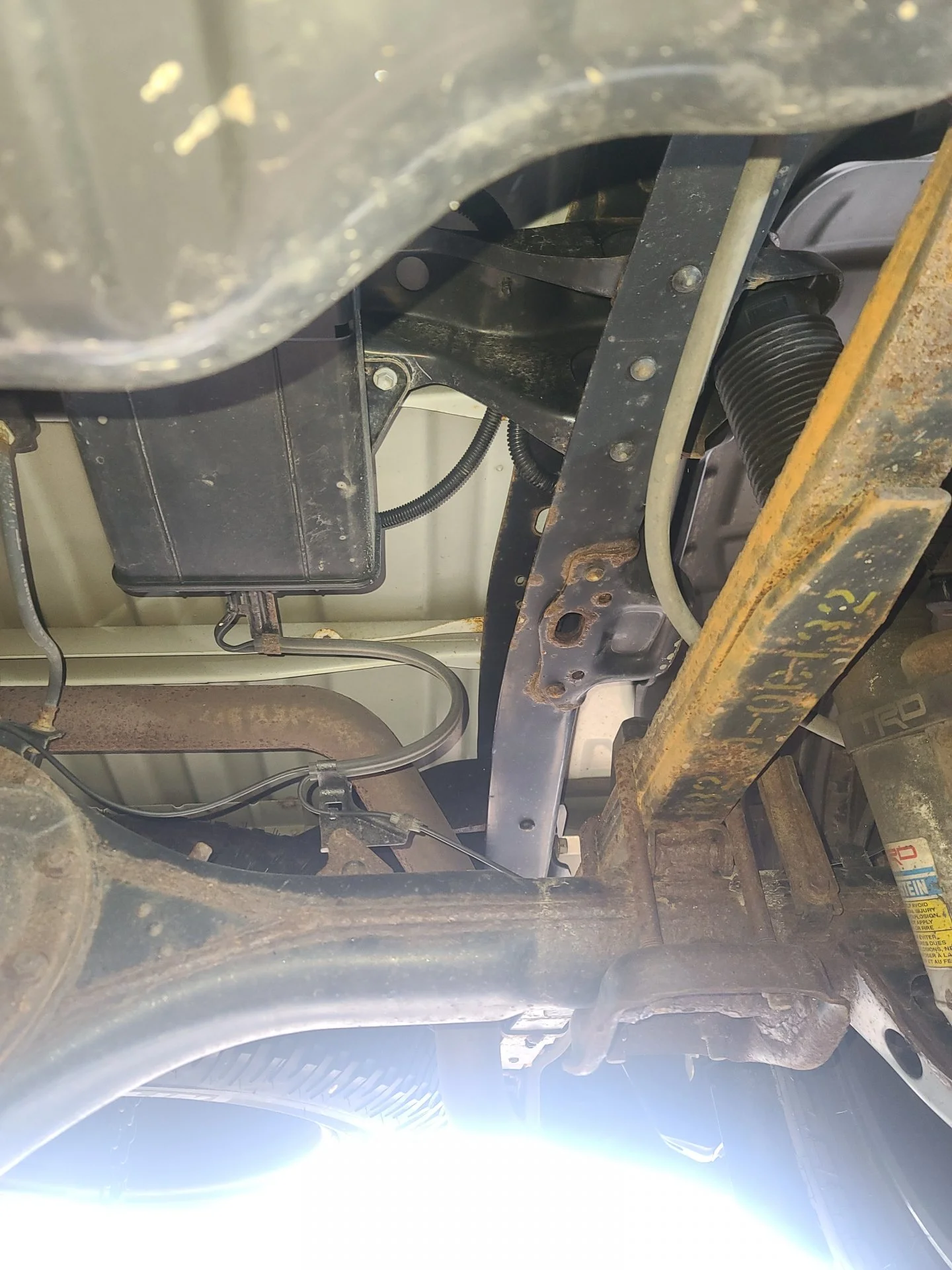

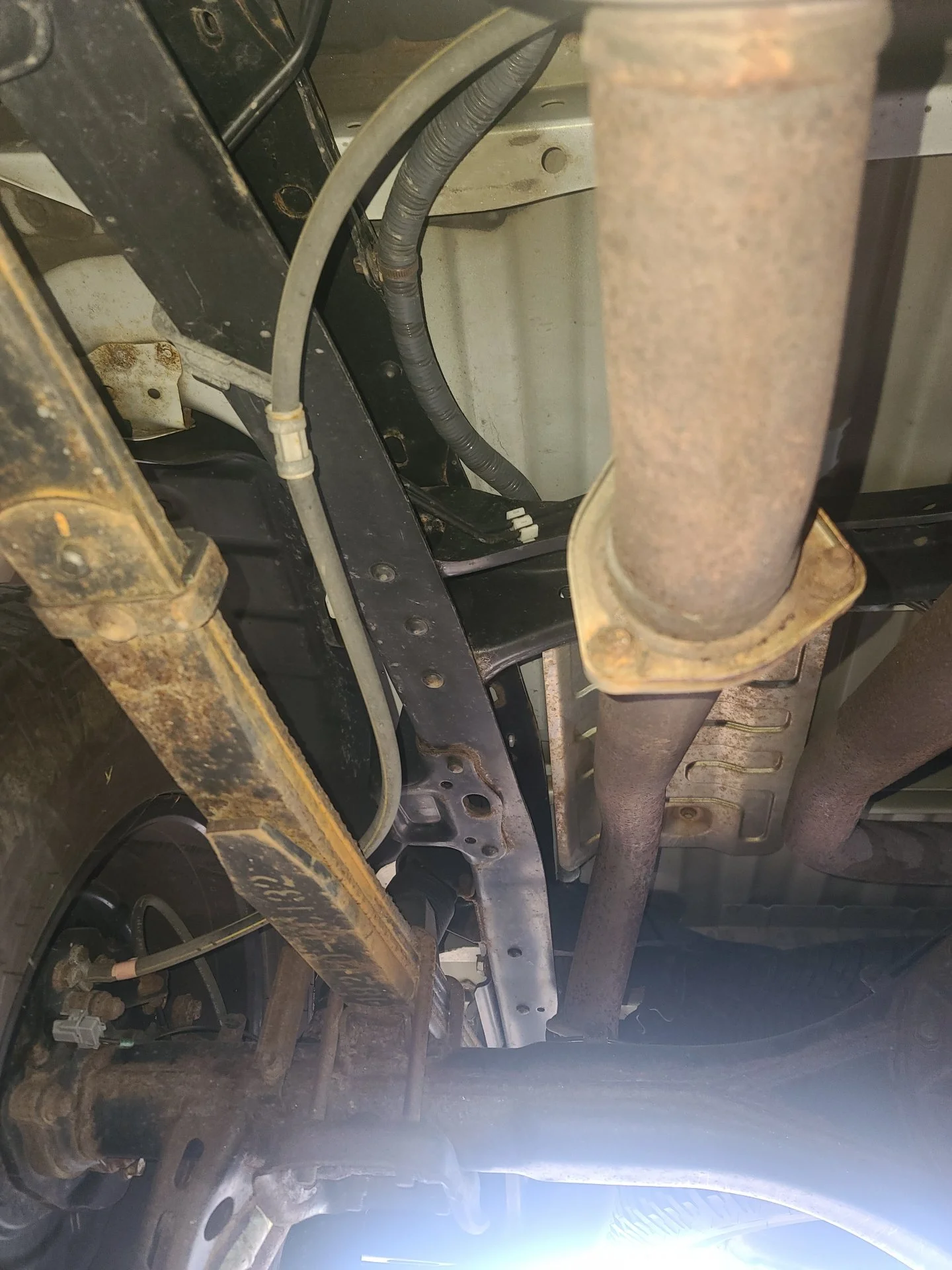

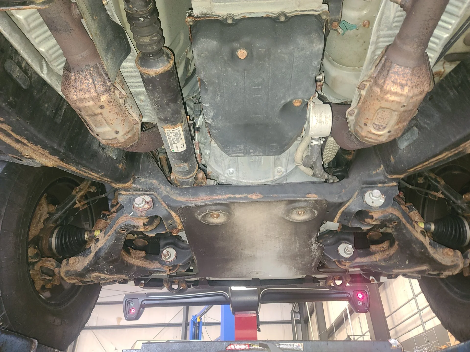

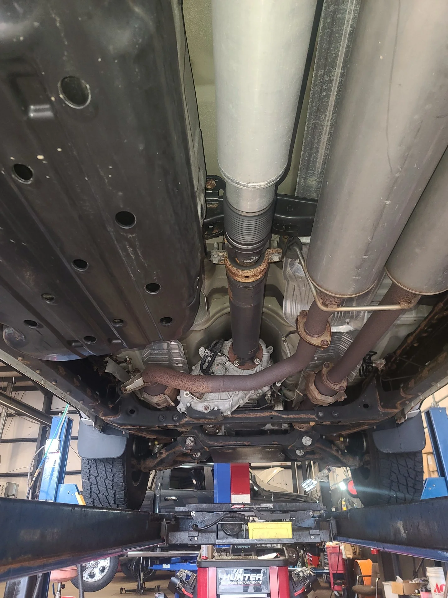

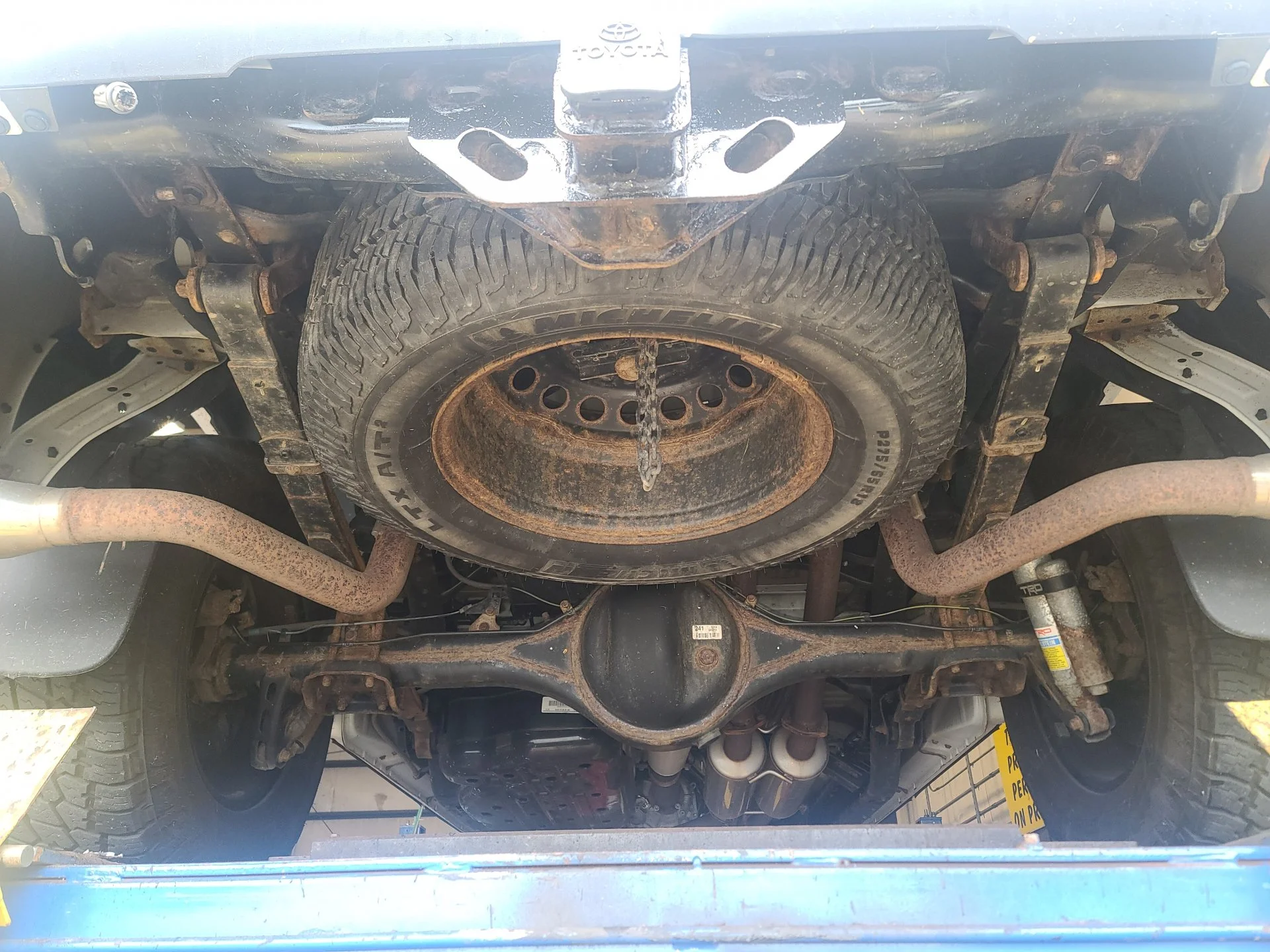

Pics from underneath a Tundra that is from the NE. Seem about right or avoid?
As a PA resident, I see nothing that would stop me from buying it...
That's a lot worse than my 2008 that I owned from new and sold in 2018. But I don't think it's terrible. If there's a drop in bed liner, make sure you check underneath it.
Personally, I'm not buying anything with rust, but I understand that circumstances are a bit different right now.

Good morning and thanks for the responses, it's been helpful. To clarify, this is not my truck and when I said "MY", I meant Model Year. I was hesitant when I saw the CarFax said VT and CT, that's why I asked for the underside pics to confirm my beliefs. I think you all provided enough insight that it seems I should stay clear of this purchase.
It is worse than my 2015. If it’s a good price It would not scare me off. Just get it rust coated. Just to be clear Not rubberized undercoated.
