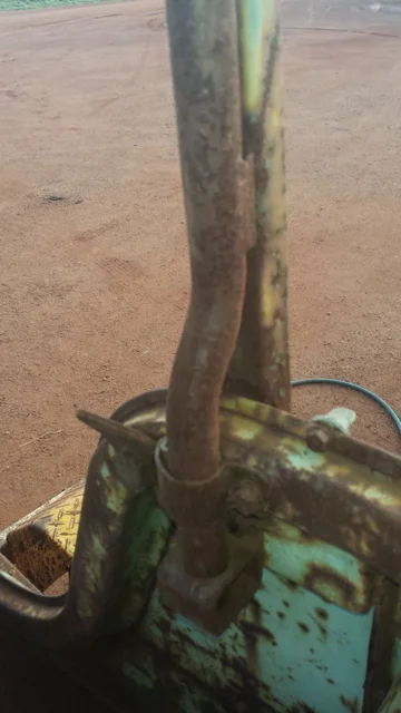

i knew nought about this tojo when i went to pick it up; only that it was a column shift shorty forty that had been parked up for a long time. so i was with a great deal of anticipation that i arrived at the location with car trailer and carton. for the record it came from the farm of shane green about 34 miles north of the pub and wheatbin that make up the tiny settlement of yuna. shorty fortys are scarce in my part; 45s being the standard. but it was love at first sight of course!
i believe column shift was only in aust. in 61 and 62; all else appears stick shift.
there are rims around both with and without hubcap clips but i have never seen a hubcap myself so they certainly werent popular if they were an option. no clips on this one.

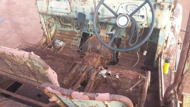

the gas cap is there, looks like my 25 one, but the tank is gone. an old car tank was doing service in the back and unfortunately the large quantity of hessian bags i mentioned seem to have been used as packer to stop the fuel tank sliding about.

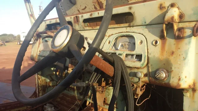

everything pretty much intact under the bonnet. the wiring is a complete shambles; ive rarely seen such a mess. the horn relay is there, typically they are missing the cover in my parts for some reason. all the hose clamps including the vacuum lines are the wire originals which is nice.
steering wheel is not perfect but it is about as good as they come especially considering it has been open to the elements for 40 years and some

i also swept a large drum of sand, rust, old bag and broken glass out of her.
