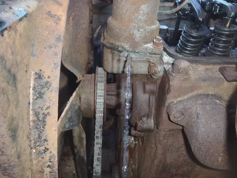

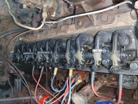

g'day punters. had a bit of a win. never heard of that atf 'recipe' but threw a drop in and gave it a go. also found in my junk a spin on oil filter (z9) that had been adapted to fit an f motor so mocked this up and finally got oil to the rocker shaft. happy days; this has been concerning me. threw a top hose and belt at the existing cooling system also. had a distinct 'leak' at the thermostat housing but that 'took up' a bit once it started circulating. this all needs much much more love of course but all in all i'm now calling this motor good to go and moving onto other isues.

i think adding the filter did the trick and some correct weight oil should improve things even more. never mind the yellow murky oil; must of got a bit of water in there when cleaning with the waterspit; rocker cover was just sitting loose on its old brittle gasket. have cleaned the rockers and pushrod gallery as best i can with kero and compressed air and have resolved to pull the sump for a clean and looksee.

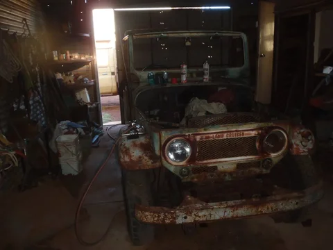

managed to play a few hours over the last couple nights. did a car shuffle. stablemate is now front center (awaiting head gasket and sump clean) and shorty is tucked in the back corner where i can tinker at will. looks so much better in a shed on a concrete floor! have pulled the driveshafts, cooling system, a few other oddments and sprayed lots more lube. threw a bit of heat at the seat bolts, battery tray and a few hydraulic fittings etc and left said pieces to ponder their folly. i like to heat and let cool a few times before applying a spanner.

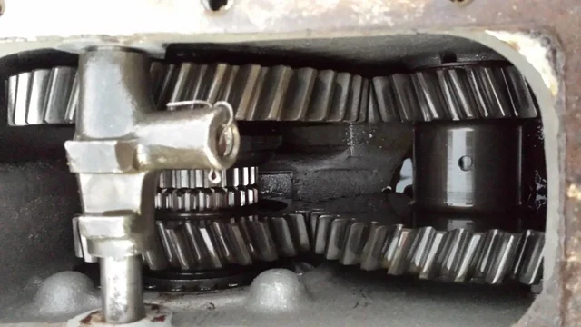

Whats up with your current transmission? What you said and looking at the picture it doesnt look that bad. Maybe its just the control arms that got stuck. The gears look beter then mine. What of you just try to turn it with a bit of fresh oil? I read something about a special atf recipe. Might save a lot of work.
This transmission is quite simple so it cannot be that hard.
this is the rarer 61/62 only trans. the vacuum parts at the box are missing. trans cover is lost. there is a homemade bar operating the 2x4 but this doesnt feel to engage anything in the transfer. and everything external is very very siezed; column linkages, cable and etc. post 63 sums up my thinking; i have another backburner project that may deserve this box more. but i am all about original and would love to see project shorty go back original thats for sure! in the meantime i am pondering my options (and budget;haven't blown it yet) and using whatever play time i got to clean my shed/workspace a little. got a mate due for beers on sunday (with a bring your pressurewasher postscript attached to the invitation haha) so after i have cleaned this box will open it up a little and see what i think. but mr. hdjtachig i am starting to lean towards your way of thinking lately. in the meantime there's a can of crc sitting on the cowl and plenty bits get another quick spray as i wander past attending to other things. i like this little tojo!

had no time lately but managed another look inside the gearbox. got it turning; very bearing rumbley of course. a tooth missing off what i take to be second gear but this the only obvious damage so far. havent placed an exploded diagram beside the box yet and havent looked in the transfer. with heat and patience got a few more things loose. passenger seat finally out. everything external to this box is seized very very solid. the gearshift collumn is one immovable solid lump from top to bottom. see the firewall is butchered with a chisel where someone has tried to remove this as one piece before. your comments on steering wheel removal (in your thread) were interesting andy budge. you can imagine how mine is 'attached' after 40 years in the weather. was a mission just to get the horn mechanism apart! havent even considered tackling the actual steer wheel yet. was thinking some kind of asbestos packer to heat the wheel. a slice of old asbestos waterpipe would be ideal but i dont know of anything that small dia. (incidentally my local small town still has sections of old asbestos pipe among the outlying borefield that supply the town water supply; guess it is safe to drink asbestos just dont breath it!)

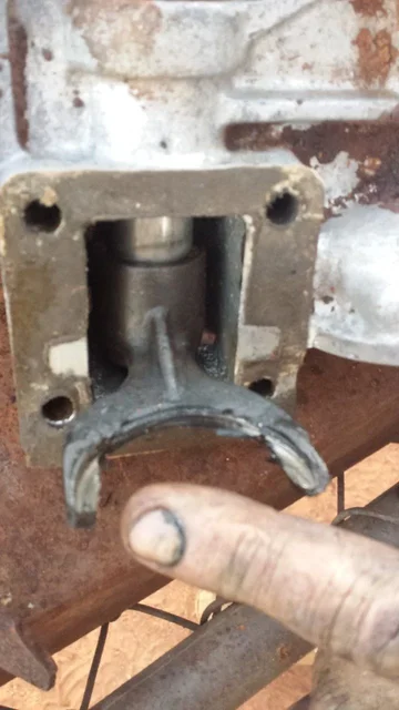

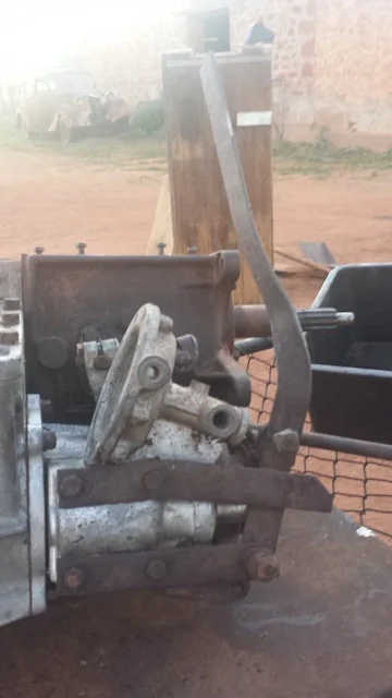

had another quick play tonight. pulled the 2x4 mechanism. the fork that operates this is very worn and was no longer attached to the appropriate location on the operating 'coupling'. i sorta suspect this has been reassembled wrong in the past but haven't studied this too much; perhaps it was able to slip past somehow. you can see how po attempted to build the fork up with bronze. the bronze piece was laying loose in the housing; its a classic po repair!
also pictured is the homemade 2x4 operating lever and the missing tooth on second gear.
