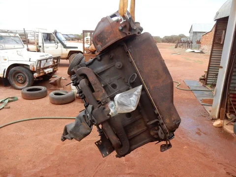

the project rusty thread has slipped to page 5. how embarresment. anyways honoury mudder bumstein turned up for a day or so to kick me into gear so today we packed a few beers over to the shed and turned a spanner. pulled cam and fitted steel gear. were not happy with one cam lobe and matching cam follower so rummaged for donor camshaft and follower from my junk. noticed the original cam followers a little different to the later donor; will get a pic of this later. finally got this engine off the stand; bellhousing/flywheel fitted; and a few small things done. nice to be turning a spanner again

cheers for the pics bumstein. yea we got a bit done while emptying a few green cans! new core plugs all round. new spigot and thrust bearing. went cheap and cheerful with a used clutch plate for now. going to run this 1964ish stick shift gearbox for now but have not given up on the old column shift stuff.
motor drying after water jacket flush.
