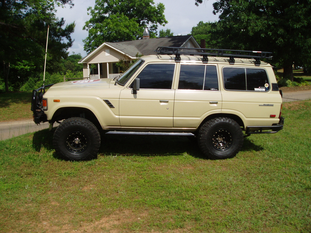

Got any rear bumper pics in that shop? :D
Here you go Brett. Gasket has not arrived yet.
Stan
Oh yeah! Very nice Stan...thank you for the pics.
I can't believe the gasket hasn't gotten there, I'm sorry about that. Let me check and get back to you.
