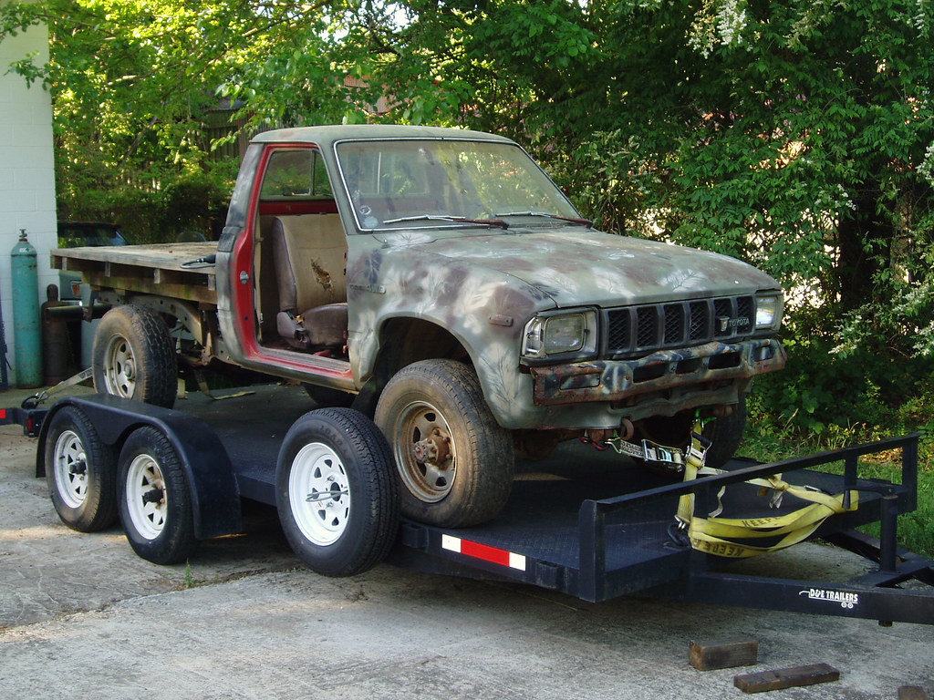

Now that I am in the new shop it was time to go and pick up my 83 PU that my buddy James was keeping at his house for me.
We think this cab will work for us. I like the fenders and the grill. Between this truck and the 89 Donor I have, I have the drive train I need.
Up side is that between the utility bed, cab and bed from the 89 and other parts it will cover what I have in both trucks and buy me some other parts as well.
Is that an aluminum utility bed?
Got the utility bed off today, that thing is heavy. I am thinking front clip is coming off next.
