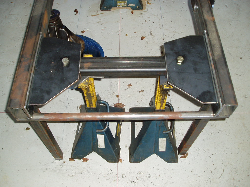

I got a lot of the T-case cross member done today. I am more interested in the frame mounted pieces over the cross member itself. It will rotate 180 degrees on the cross member to be installed, the T-case and trans will drop out from under the rig.
There will be bracing between the 2X3 and the plate and a bolt top to bottom in shown hole. 11.5 " between the mounts, 24" between the frames. The side plates held up with the magnets weld to the frame for extra support.
This is the cross member tacked together not in the location where it will be installed.
