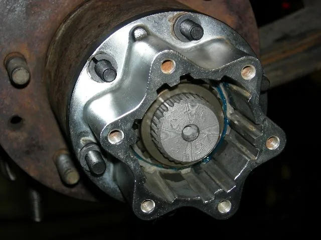

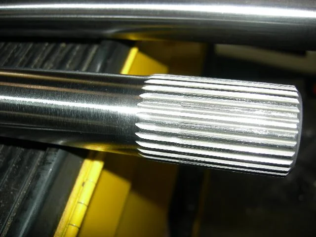

Pictures I posted about an axle I built from another thread out here:
30 spline 300M CTM shafts
attachment.php
ARP hub studs, Longfield chromo lockout gear and CTM 300M full-float axle shafts....
attachment.php
attachment.php
This configuration has been in service now for three years without any issues....

Poor mans front dig? Do you have the shaft dimensions handy?
