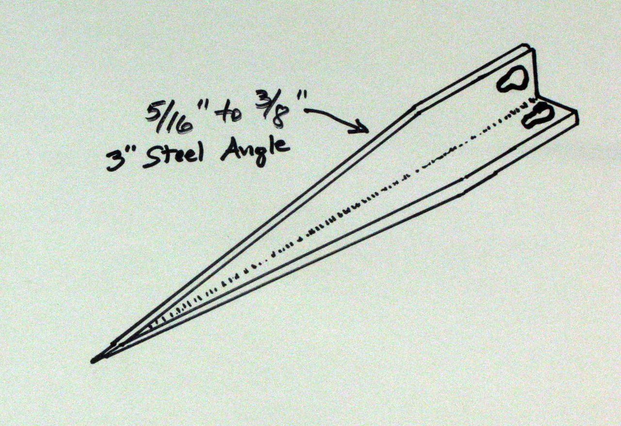

I have a slightly different solution and it's one that can usually work around rocks if there's a way to get them in with a sledge. I bought them 30 years ago and have yet to need them, though. It's a pair of heavy angle iron cut into a stake with holes pierced at the top to get a clevis or hook into. These are heavy (3/8") but take up virtually no room since there are just an L. You might get by with driving just one, but driving in the second one and daisy chaining them together is good practice.
And they were designed to work in sand, as they were sold as "sand spikes." The L is big enough (3") that when the inside is faced toward the vehicle, there's plenty of frontal area to give them a bite when driven into soils, sand, whatever.
I'm interested. Do you have photos?
I'll keep that request in mind. Right now they're buried in the truck, given they're a last ditch, got 'em if you really need them sort of thing. I could make a sketch and scan it though. Gimme a few so the burger doesn't get cold...
I did only minimal dimensions on the sketch. Length is about 30" with the full section angle at the top being 8" to 10" long. I was rather skeptical of the idea of them holding in sand, but was told to drive them in below the surface and bury it so the full part of the upper is buried. Also, always use them double. Obviously, not something you want flung at you if things get loose, which is probably why not on the market long as I recall, given the way lawyers have proliferated...but I can imagine someone wanting to hurry things up by just setting one and running into problems.
Remember these are from the era of 8k winches. So bigger may be better. And I'm using my memory, but pretty close. I'm sure it was heavier than 1/4", but may have been 5/16" instead of 3/8". These were bought in the late 70s from some outfit in SoCal. It could've been Cepek, but Con-Ferr or some other of the usual suspects from that era may have been the source. They were nicely done, painted black.
I'd dig them out, but they're in the middle locker of the sleeper/drawers buried under other heavy s**t and my back is trying to survive painting the wife's rental house right now. Will try to remember to get pics when I happen to be in there, but mostly it's about NOT opening that one. Hey, I'm a weak little man too stupid to buy the locked LandCruiser I need, what can I say?:bah:
Much appreciated. I have over 500 lbs of tools in my truck so I understand the reluctance to dig it all out. This drawing will do fine. I have a friend who is a welder that can make this and ensure it is strong enough. This would make an interesting projectile. I have a mental picture of it sticking in my radiator in the middle of nowhere but if I am stuck and cannot get out any other way, I don't really see the difference. I stand way out of the way when I run my winch so I am mostly concerned about the truck!
