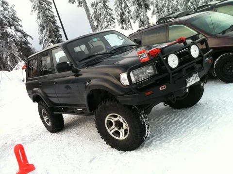

i run 35" trXus on my 80. no problems with them whatsoever save for the extra weight which i feel and ate up a bit of my mpg's. 75ish# 315 KM+wheel combo vs 95ish# trXus+wheel combo. otherwise, the soft tire compound gave a VERY quiet ride compared to my first gen MT/R's and KM's. downside to that is a bit quicker wear, but with proper rotations it shouldnt be a problem esp with the heavy 80/81 in snow/deep snow wheeling, they performed awesome and was very impressed with the traction they had. sadly, not much off road wheeling miles on them recently, but hoping to change that this year! they seem to have a bit more siping vs a KM/KM2 or other dedicated mud tire...and so far rain performance at 70+mph on the hwy has been excellent.
re: balancing...when i purchased the set (came with LX450 rims), they were balanced with dynabeads. not bad, but they had a slight shimmy at around 50/110kph. decided to go with standard balancing and have been mint ever since. yes some took a bit more weight, but as long as it balanced i didnt really care. oddly enough when i had the beads in them, when cold & driving off first thing in the morning you could feel them and it felt like the tire had a flat spot. no issues with the standard balancing. i had stick on weights on my previous MT/R's and KM's on 80 wheels, and they rocked & highly recommended, but so far the regular clamp on weights have never fallen off in the 2 years ive had them.
the 35X12.5X16 size look a bit narrower than a 315 counterpart. at least thats what ive noticed anyway, when looking at pics of my 80 vs others with 315s. a bit taller lift in my 80 vs others may be contributing to that illusion perhaps. the only other 35" skinny for 16" i know of is either the q78s or the SSR's, both by interco. going up to 17s opens the door for other sizes & availability, but then you dont get to rock the awesome oem 80 series rim.
bottom line, id get em but in a 37 if your truck can handle em. they're a great all round tire...but of course we all praise what we currently ride haha. are the trxus back in production? as noted they were out for a good while, not available when was looking for them. i lucked out and found 5 with 90% tread on rims for $1k here on mud. but this was 2 years ago...
