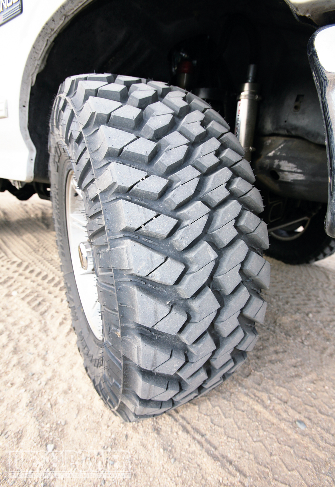

Here is a pic of the Nitto, get these siped and your golden .

get Pitbull Radials and be done!
not bias if you want to street drive
We've sold several sets, reviews are good
no snow flake symbol on them but they work great in the snow for me so far
You can get decent size tires in 15" wheel sizes unlike most other tire companies
I think the snowflake symbol is for ice traction - these tires remain soft at low temperatures, with special corrugated sipes to grip ice, but should not be used at temperataures above 45F as they wear like erasers. .
