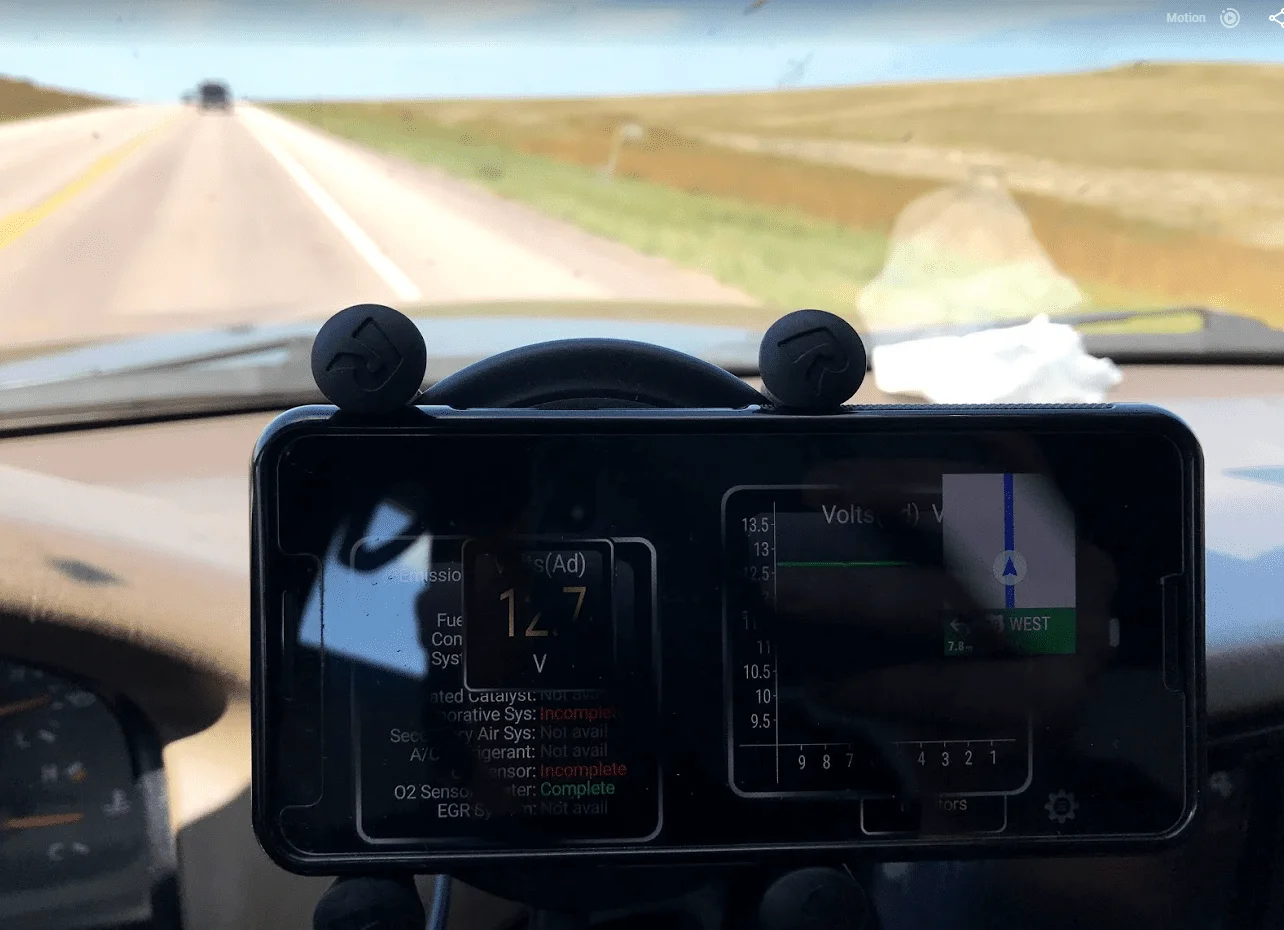

10 Miles into the 300+ Mile Journey: 12.6V cruising (~13.7V at the battery)
Yikes. This is not good. I'm not looking at a rate of 30 miles per volt now. That will barely get us to Lusk and not even close to Cheyenne.
30 miles in: 12.65V (~13.75 at the battery)
60 miles in: 12.70V (13.8V at the battery)
This is when I knew we were ok. The bleeding had stopped. I don't know how or what changed, but our voltage leveled off at 12.6-12.7V. Still below what it should be and stalls seemed likely at stops, but I had a new stopping procedure that minimized current draw and kept it running.
