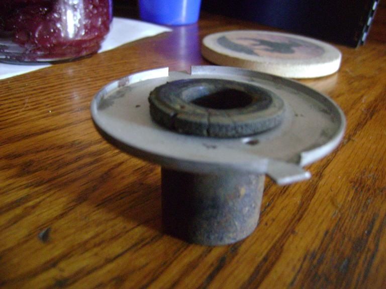

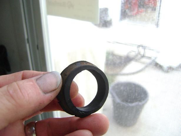

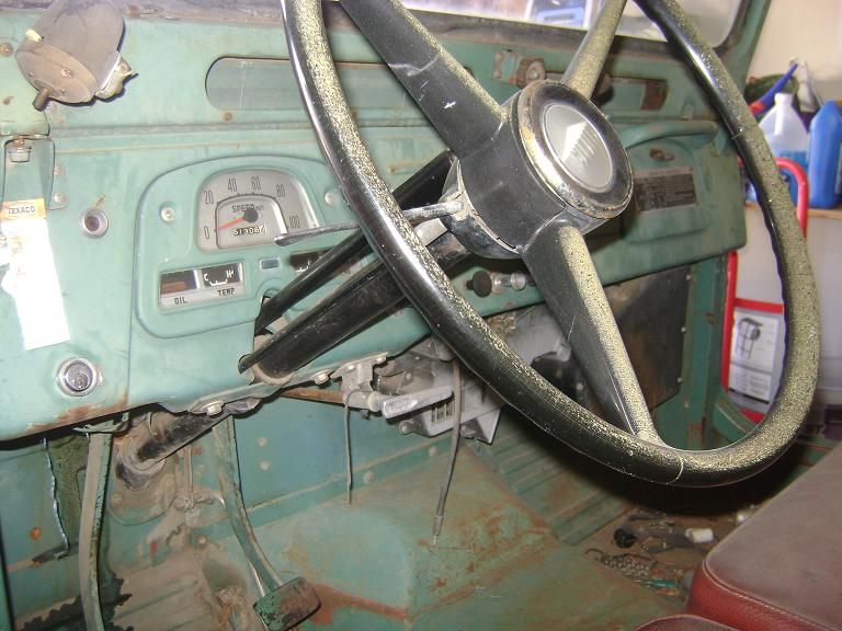

after work today, i sanded the wheel and put another coat of paint on, tapped a hole in the suspension on boss hogs pig and began working on the horn contact in the wheel. found a 68-89 gm contact kit and modified to work, dorman pn 83230, now to figure out the isolator bushing
Nice!
if anyone hasn't seen the thread on horn contacts and isolators, i used an old fj55 spring bushing, cut it down with a hacksaw, put the shoulder against the grinder and used a dremel with a sandpaper barrel on the inside to hit the required measurements. works awesome!!!! it's fun to hit annies button and hear her scream "gtf outta my way"!

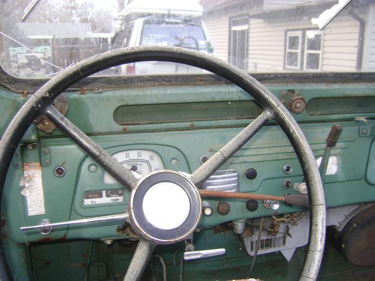

Yea, s.wheel looking so much better. Great job. I noticed your wheel was positioned differently before restore but horn button was not. Were your tires just in a turned position or was your s.wheel set different like mine?
yes, the wheel was turned when the old pic was taken

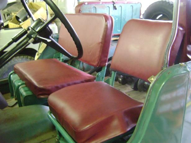

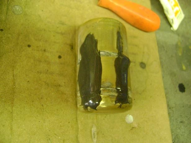

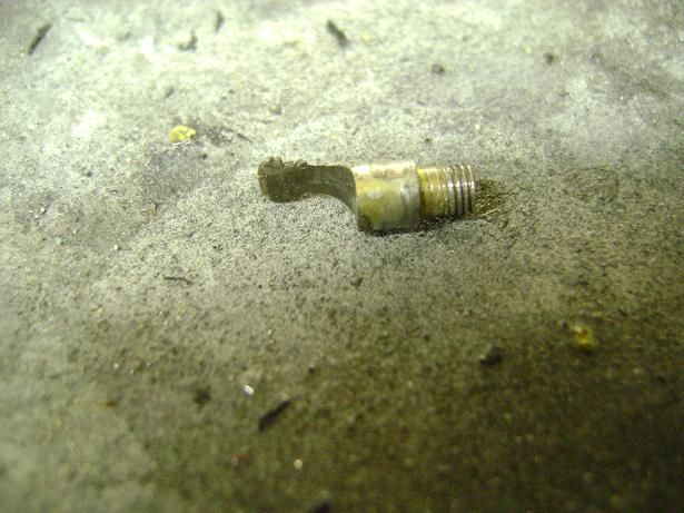

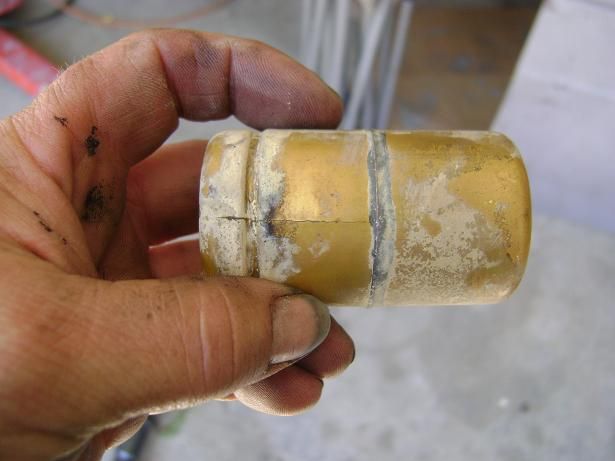

fuel gauge worked intermittantly, so while i had the seats out to add more padding (upholsterer didn't use enough foam :rolleyes: and too busy this summer to get to anything), after a bunch of messing with meters, i pulled the sender to take a look. found at least one slight crack had allowed fuel in. for now, it's epoxied and working well. i'll keep my eyes out for a suitable replacement
newly overstuffed seats (hopefully, they'll calm down a bit after some use ;)
