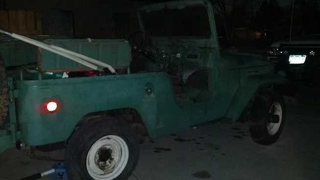

only issues were she's currently stuck in 4wd (couldn't get to shift linkage with skid plate in the way and no vacuum to pull out), so we drug her down the road and pulled the rear shaft from the axle. tires held air most of the way home, but were so low that on backing up the driveway, the right rear peeled off the rim and the left was dang close.
before we left the p.o.s, i coated the engine with simple green and we stopped at the carwash down the street from home, but the only way the grime was coming off the engine was with the paint, so there are now a lot of bare metal spots on the valve cover and a lot of grimy spots:D

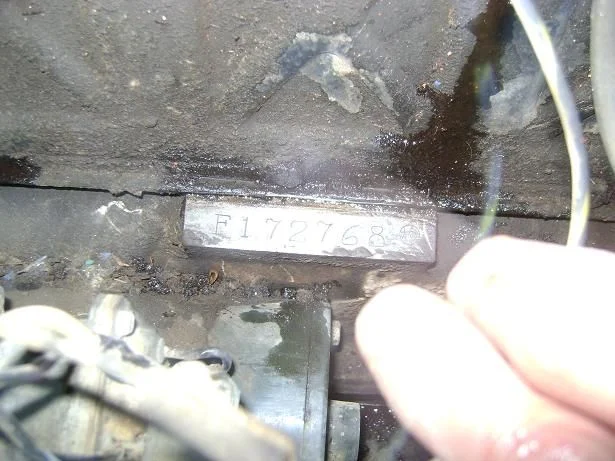

haven't checked the engine serial number yet, as it was dark by the time we got her weaseled into her temporary spot next to twrecks. will try to check it tonight and match it to the service booklet tonight.

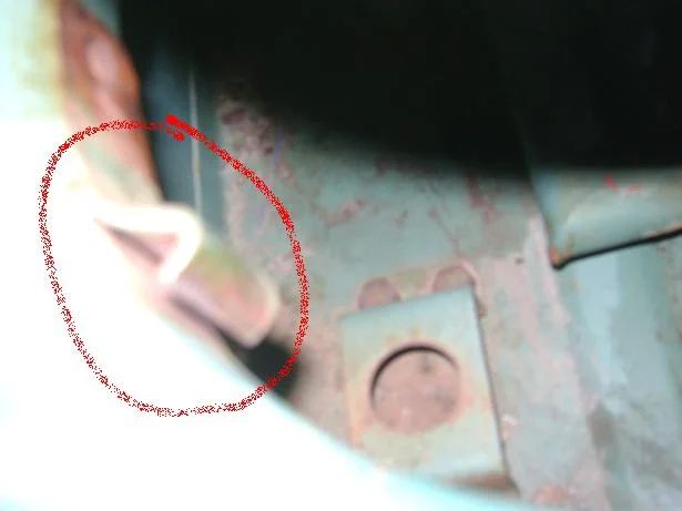

how does this bracket for the soft top work?
