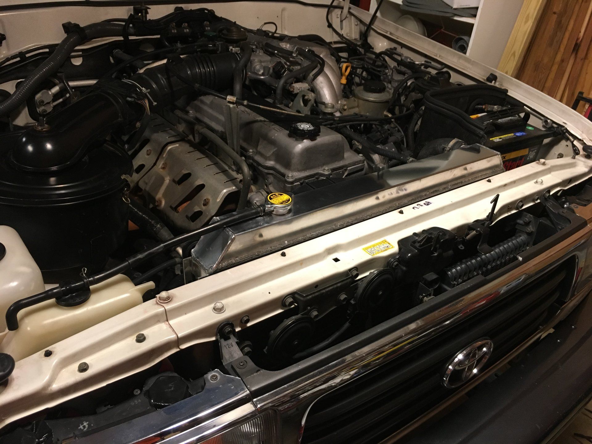

Installed a Liland Model 1918AA in my 1997 LC last weekend.
$195 plus $11 shipping from Rock Auto.
Install went well. No plastic parts to break down. I had a cracked tank on the original.
The design eliminates the side brackets (not the mounts). It was 3/16 less on width so I had to use shim washers to align the lower mounts, but that is better than being slightly too wide.
The fan shroud does not fit tight against the radiator (1/4 gap at the top), but I modified the shroud tabs to make it fit better. I recommend using the bolts left over from the bracket instead of the normal shroud bolts since the are shorter can can't touch the tank.
I have more photos of the fittings if anyone is interested.
I have only done normal driving in 90 degrees outside temp so far and coolant temp is normal.
I got an email from rockauto last October about these radiators and was curious about he quality. Please update this thread with any updates.

View attachment 2047097View attachment 2047098

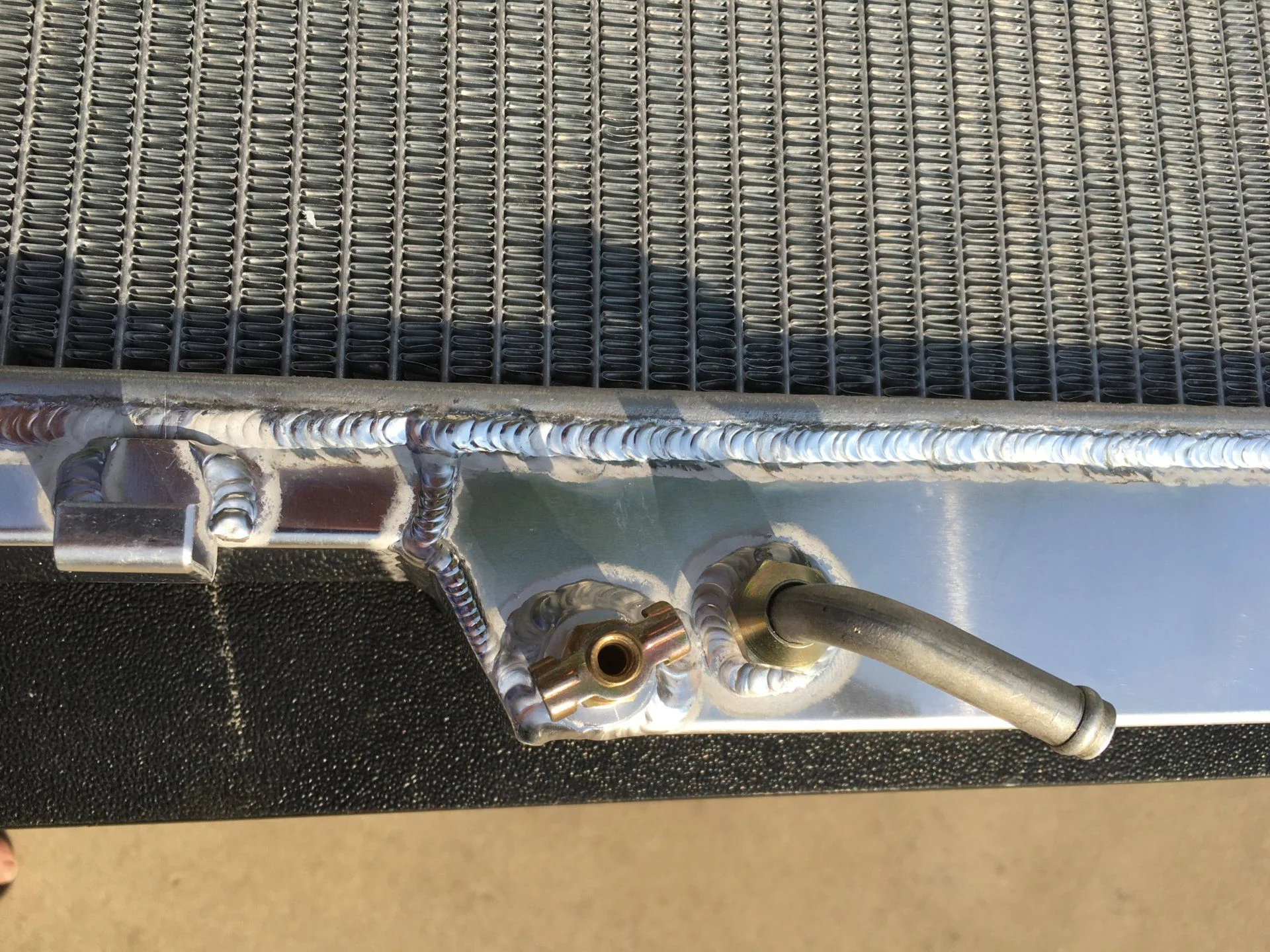

Here's a close up of welds.

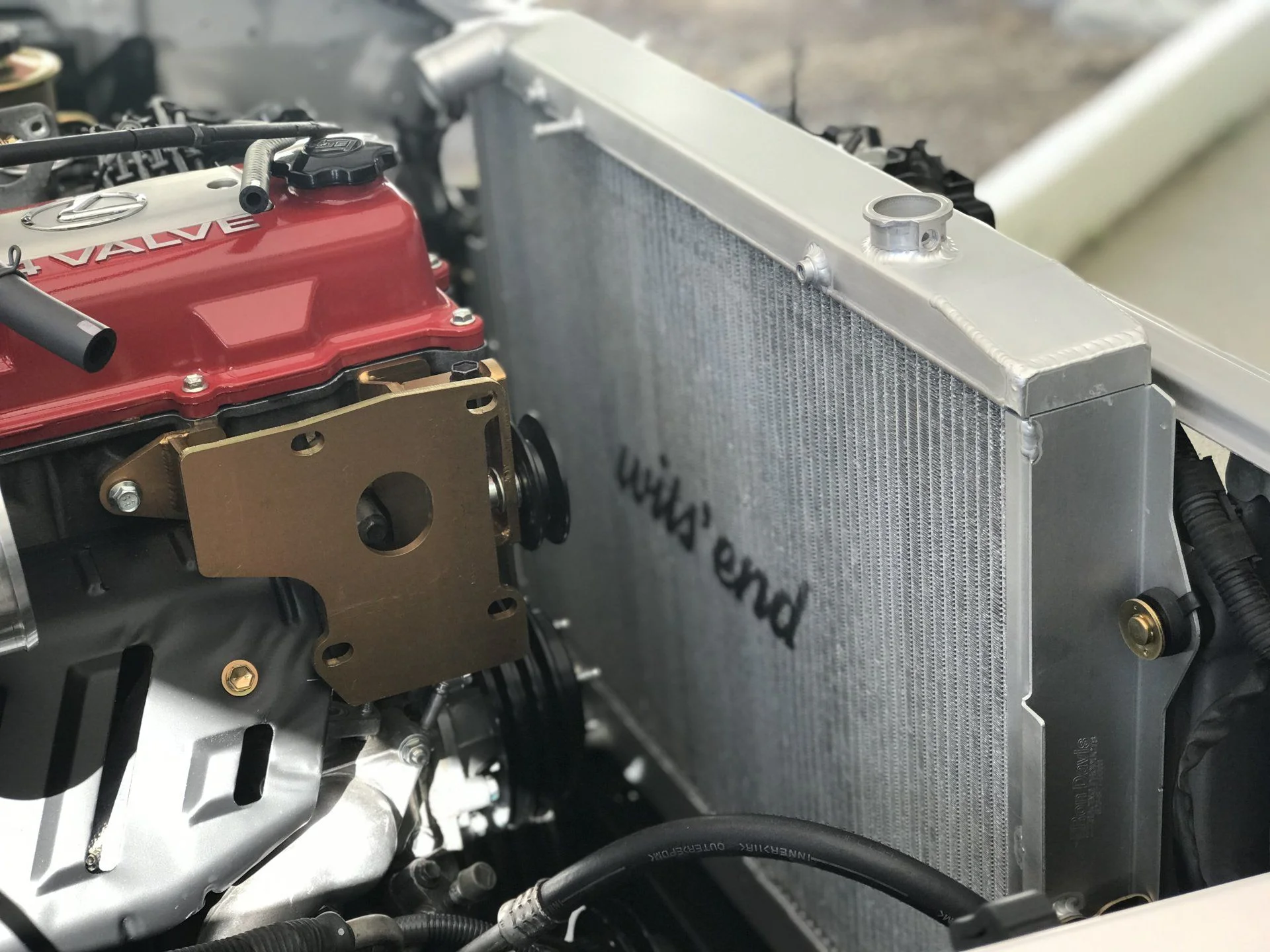

Here is a side view without the bottom mount installed. Note the integral flange for the top mount (installed).

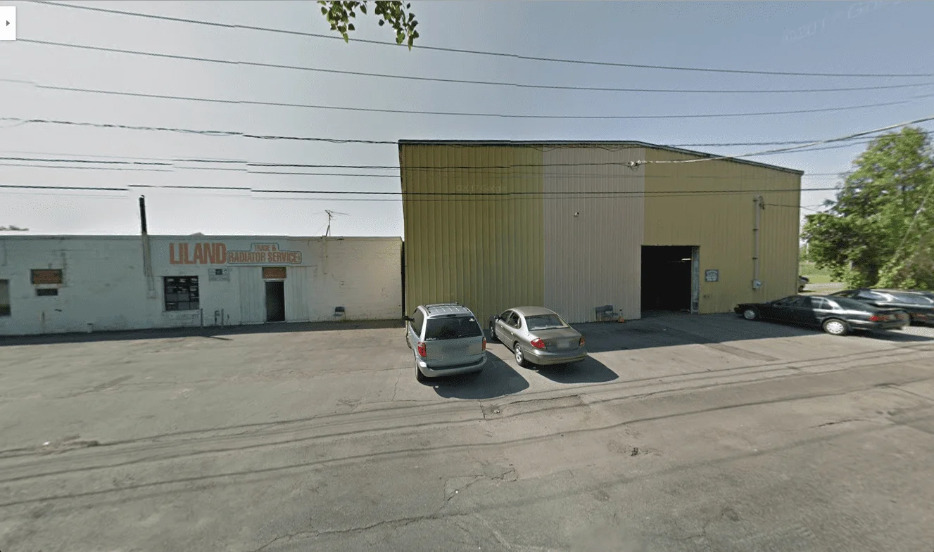

Where is this radiator manufactured??
@Kernal Their shop is in Syracuse, NY. It looks like all the radiator shops I’ve seen before but neither their website or Rock Auto's say where they are made. It's probably china.

It does say where it’s made.
