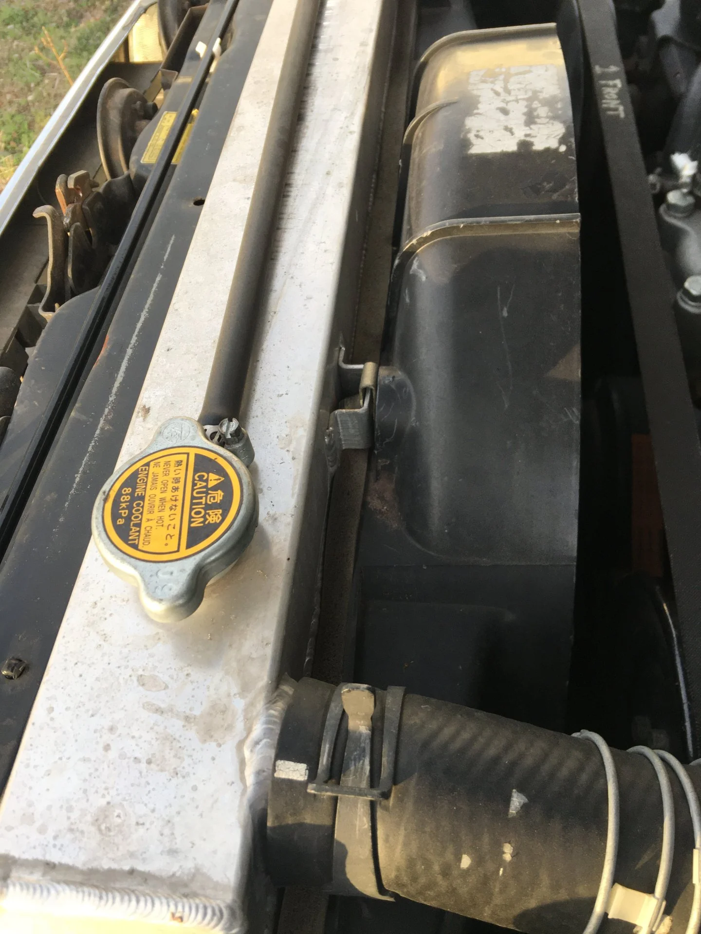

Liland all aluminum radiator
i went with a Liland unit after i blew my Ron Davis. It is cooling just as good as my RD i had installed. Pretty happy with my unit.

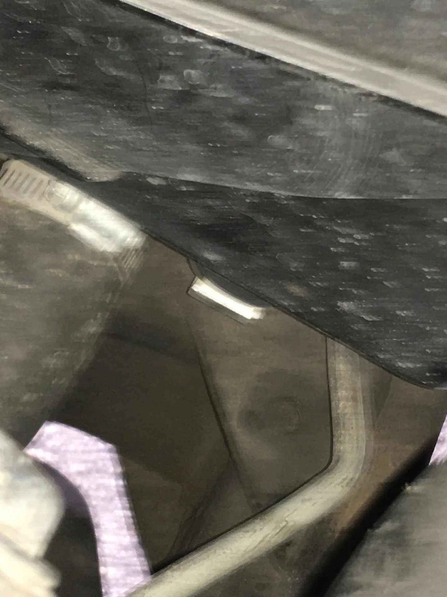

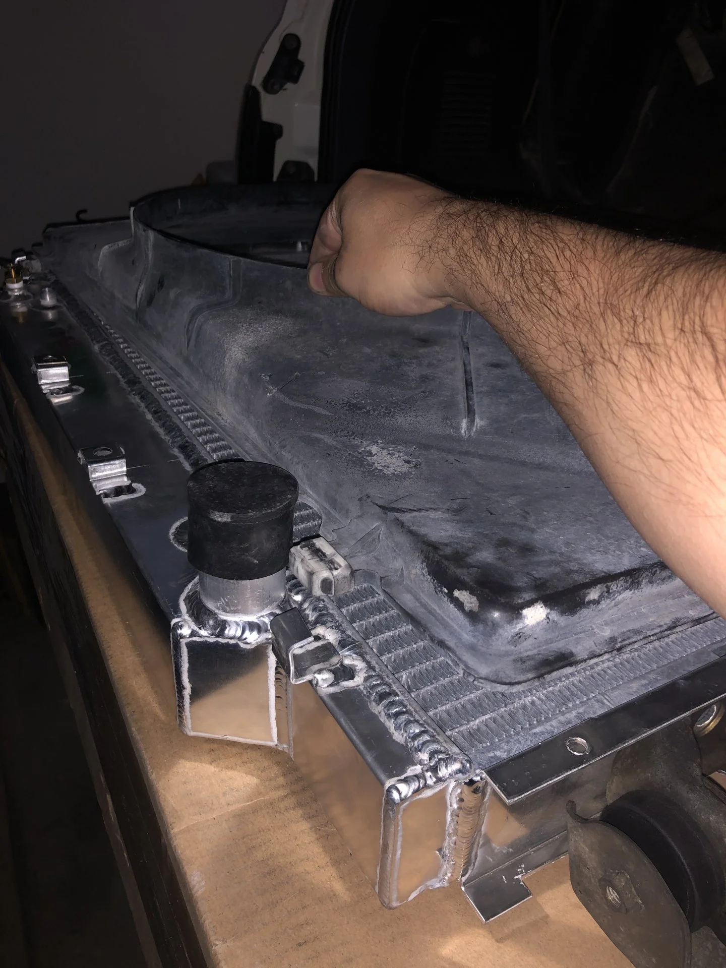

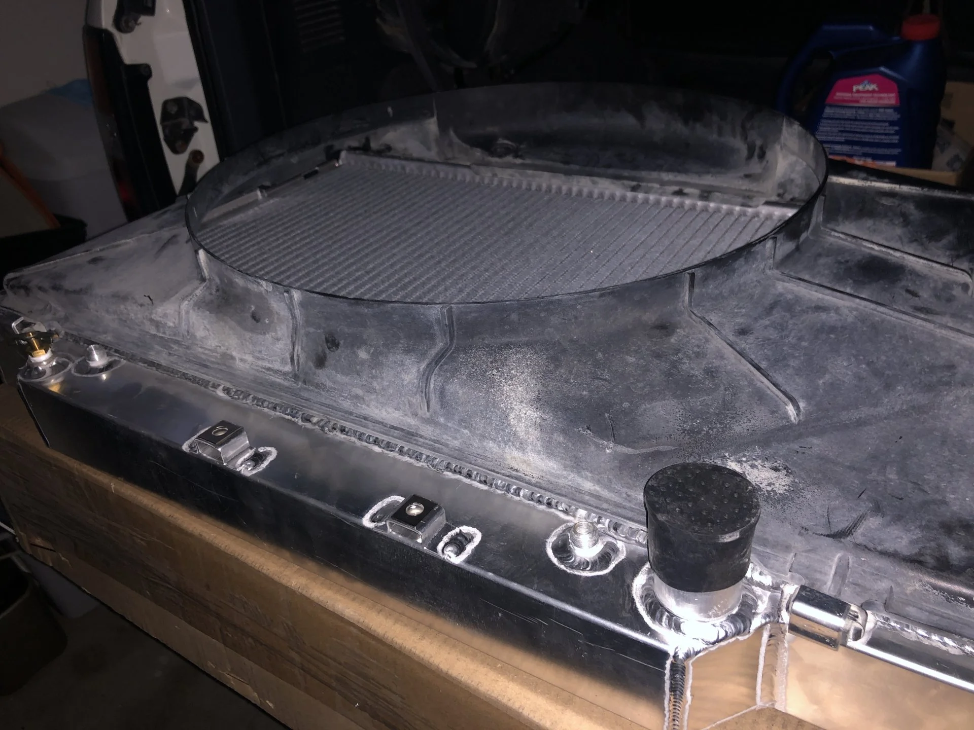

My costly mistake. The fan took a chunk off the top of my cracked shroud and gouged a big hole between the top tank and the tubes...:bang:
That sucks!!! Did you check your motor mounts?
That was the first thing I repaired on my old 91. The motor mount was bad and the fan would hit the shroud under torque. I was lucky and fixed it before it ate the radiator.
yeah that happened a while back, i have since replaced both fronts and tranny mounts. I procrastinated on replacing the shroud.....ugh.

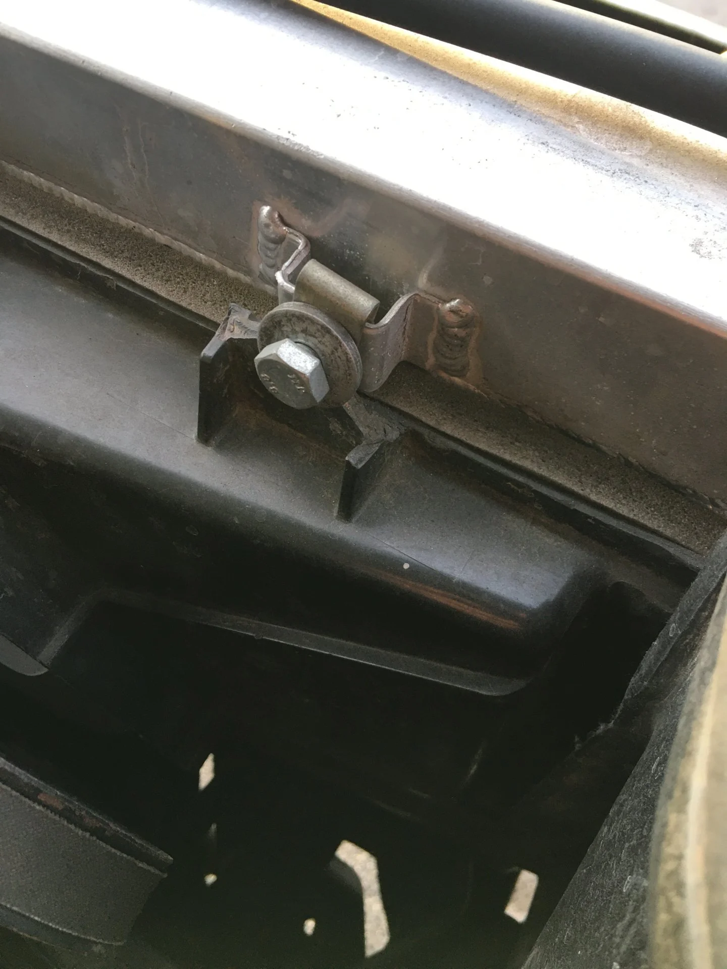

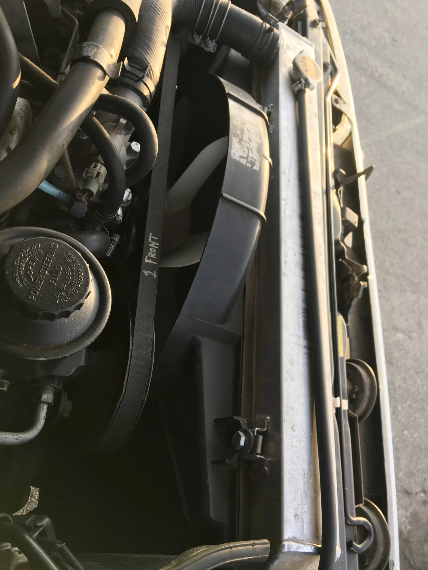

91 3fe here… and four years later my Liland is still working. During the intial install i did make sure the rubber bumpers were installed correctly as iit would help eliminate stress when bumping down the trail. Im using Toy red and distiled water, NOT pink its too accidic and caused the leak of two heater cores after a fluid swap.
Resurrection of this thread… can someone explain how the shroud fits on the radiator? Do you have to drill holes in the shroud?

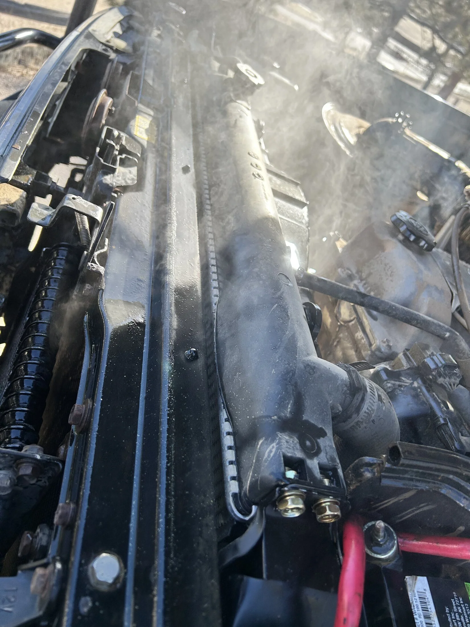

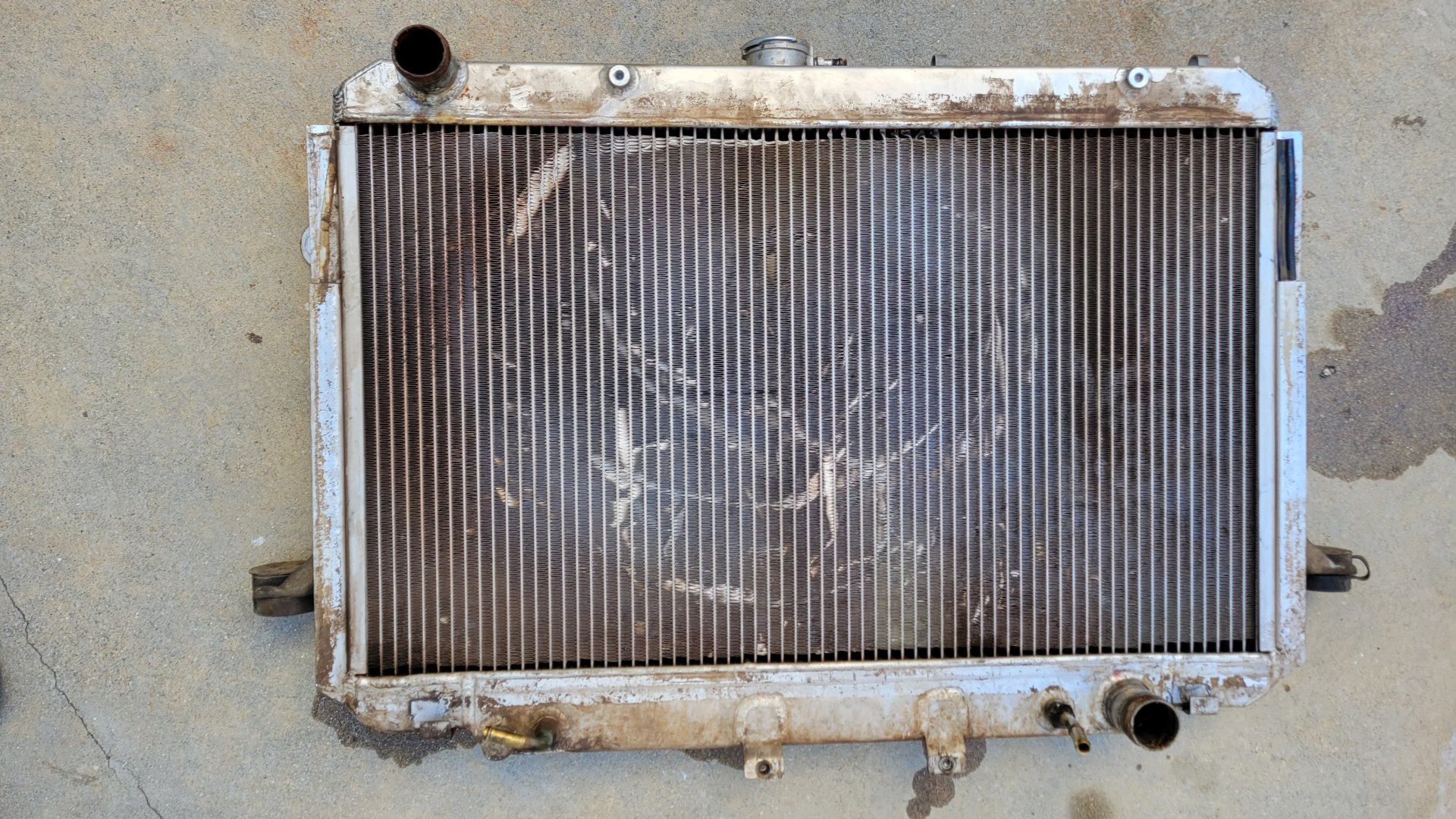

I just bought one of these to replace my 2 year old TYC that blew the top tank. Glad to see it’s doing well. Plan to install this weekend.
Pic of the s***ty TYC, glad I was pretty close to home when it let go.
To bad about the TYC.
