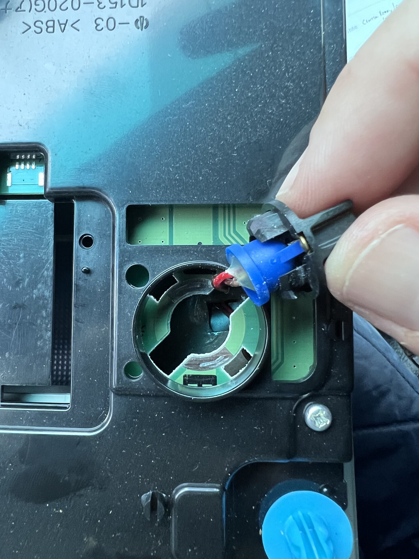

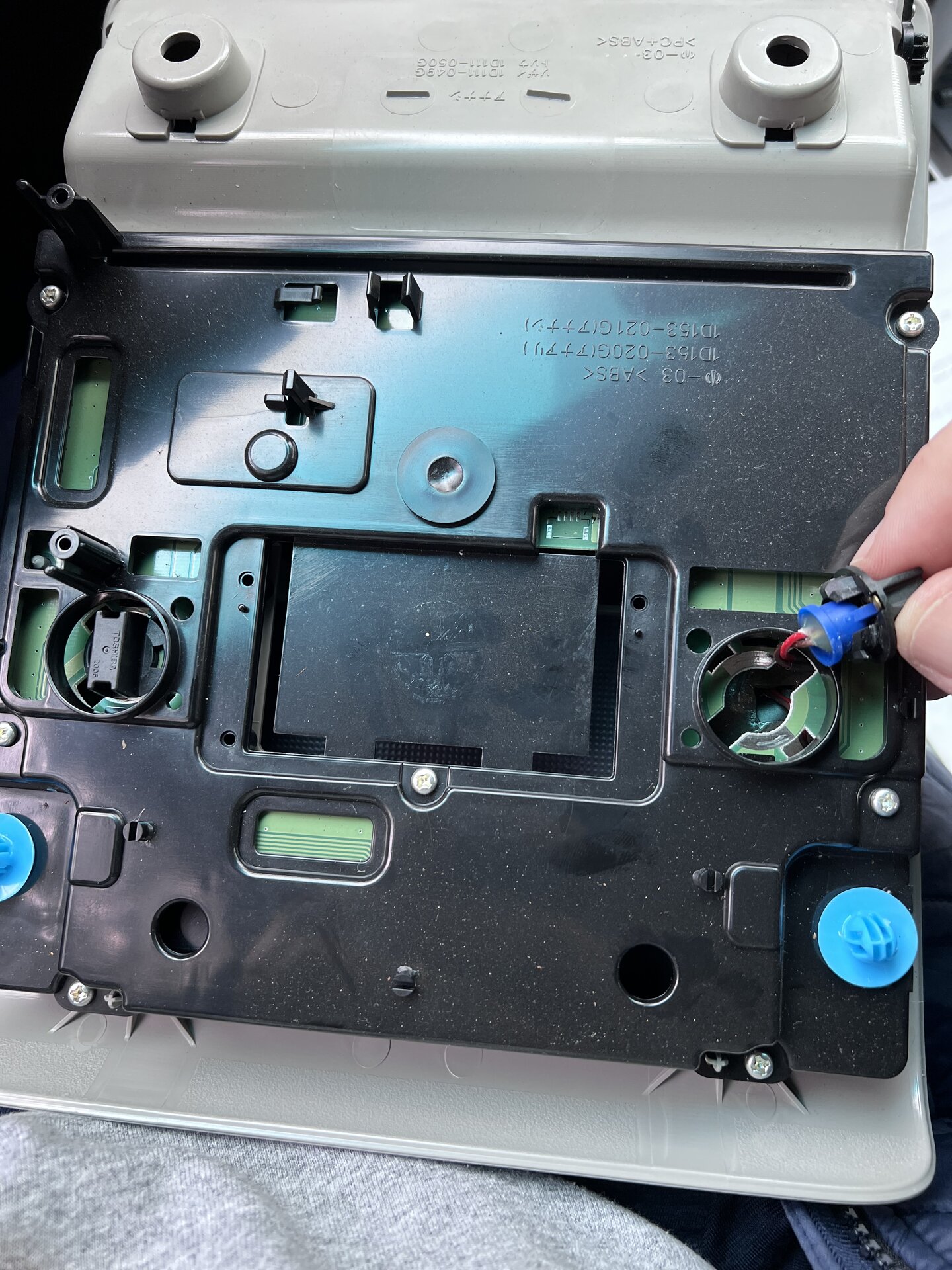

I am the second owner of a 2013 LC 200.
When I purchased vehicle the interior lights had been changed to LEDs.
Now, one of the map lights is not working so I sourced some new LED lights and looked up the procedure to change the bulbs.
Interestingly, upon opening the unit it appears that this was more than a bulb upgrade (or not?).
No way to easily exchange a bulb as none there - all wired in.. is this normal? Not what I suspected.
Please see photos below- appreciate any advice or guidance.
Thanks.
If you take the lens off the other side you’ll probably find those wires going to an LED array panel.. have any good picture of the other side through the lens?
If you’re just trying to replace the bulbs you took apart way too much. The plastic lenses pop off and the bulb slides out. Takes about 30 seconds to replace one.

Ok, stupid question. How did you get those lens off? Afraid they will snap.

If I'm remembering correctly, just take a tiny flathead screwdriver, slide it in between the lens and the surroundings, and carefully pry it off, while working your way around the lens. Most light lenses remove this way.
I have the lights just wondering the easiest way to remove those lens without damage?
Flathead screwdriver or putty knife.
