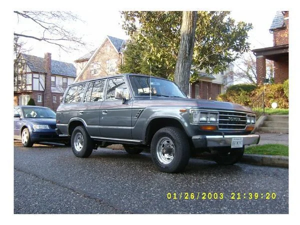

I'm new to the LandCruiser family and looking to lift my baby girl. She's a beautiful, near mint condition, FJ62. I dont want to go extreme, just enough to maybe clear 33s. Also, I am looking to re-gear the axles and was wondering what ratio would be needed. I was thinking 4.11s. Any help is appreciated!!
Thanks.
FJ 62 already has 4.11 gearing, and it would be hard to beat the Old Man Emu 2-3" lift for 33's. Just did this myself. Would stay as FAR away from Man-a-Fre though! Where you located?
Looks awfully like our neck of the woods doesnt it? I agree Old Man EMU would probably be your best bet for a lift that size.
I just did an Old Man Emu lift on my '88 (same color as yours). 2.5" heavy front and medium rear. I was concerned that it would lift the truck too hight but it really looks great and the ride is better.
It seemed like I had a hard time getting the parts from the dealer who got them from OME. Also, remember that you will need to deal with longer brake lines and stabilizers. Well worth it though.
x3 what they said...
It's more expensive, but arguably one of the best suspension systems for our 60 series. I got mine (for my 60) from Kurt at CruiserOutfitters, you'll find many of us trust him completely for advice and like to fork over our paychecks to him. ;)
also - liek everyone has said, you've already got the 4.11s, depending on your intended use, you could look at changing gears to like 4.56 or something - but be sure whatever you do syncs up with your intended use.
HTH
I'm located in Baltimore, MD

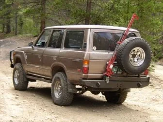

my 60 with OME on it...
I don't think there's much difference between the 60/62 when lifted (although the AT, my weigh enough more...)
I have the OME Heavy/Heavy, 1.5" over stock front shackles, and +2.5" in the rear. (IIRC)
