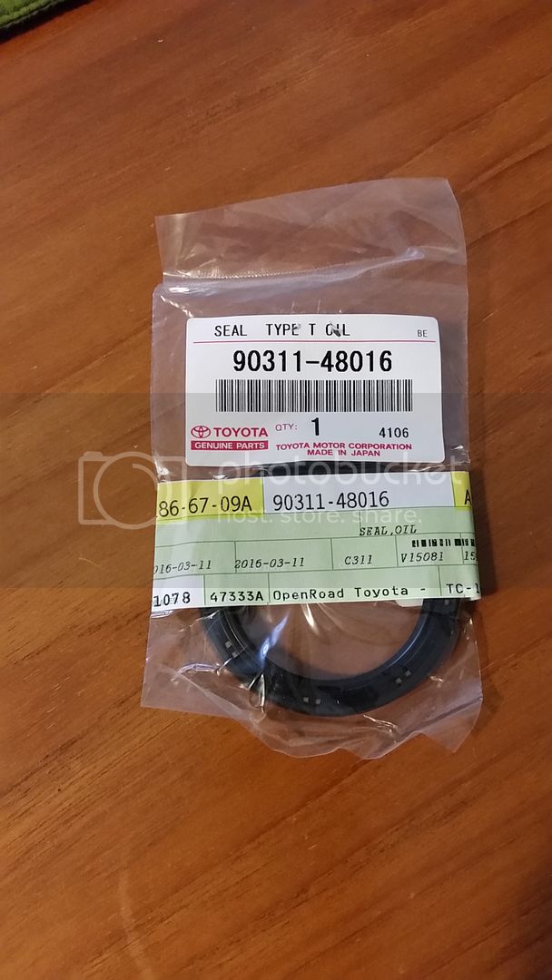

@Wheelingnoob do you have the part number for the seal you used in the updated HF2A adapter? My adapter just arrived and I thought I had 2 of the right seals, but looks like I have the wrong ones as they are too big. The part number on the ones I have is 90311-50014.
The number you found is the change up number for 90311-48018 exact same as this one but the number you found is not easily found. The difference is the production date. The parts they seal did not change at all. I have confirmed that this earlier production part number works. The one I have used is in stock in most warehouses.

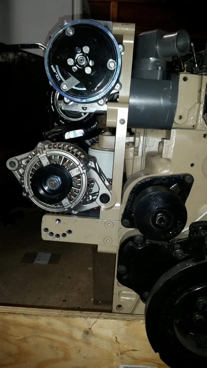

The belt tensioner I ordered will not work, it's for a 97 Dodge and tensions the wrong direction for this f800 accessory mount. So I will need to get another one.
I decided not to make my own tensioner mount I'm just going to buy the one from the same guy that made the alternator mount. At this point a saved day in this swap is worth more than the part.
I think I just ran into the same issue. My motor is a 97 6BT and the the tensioner wants to apply clockwise tension. Using the diesel adapter accessory bracket I think I need a counter clock-wise tensioner. Were you able to find the right one yet?
Yes I got a Cummins part number 3978021. Found a new one in box on EBay for $60.
