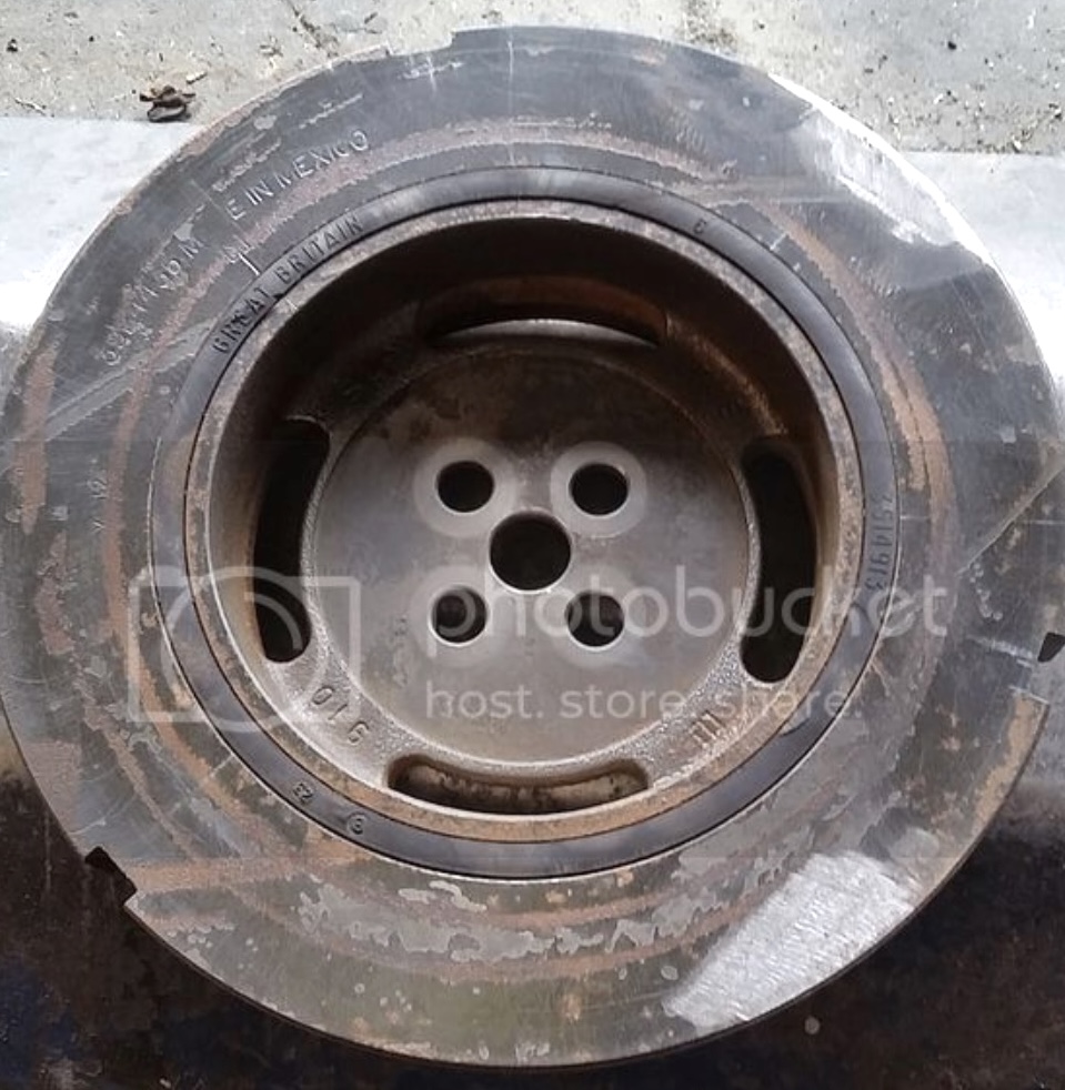

I did the 3 notch method as it was a simple mod with a welder and a grinding disc, used a simple two wire setup and has been total reliable with no boxes to program or wire in place.

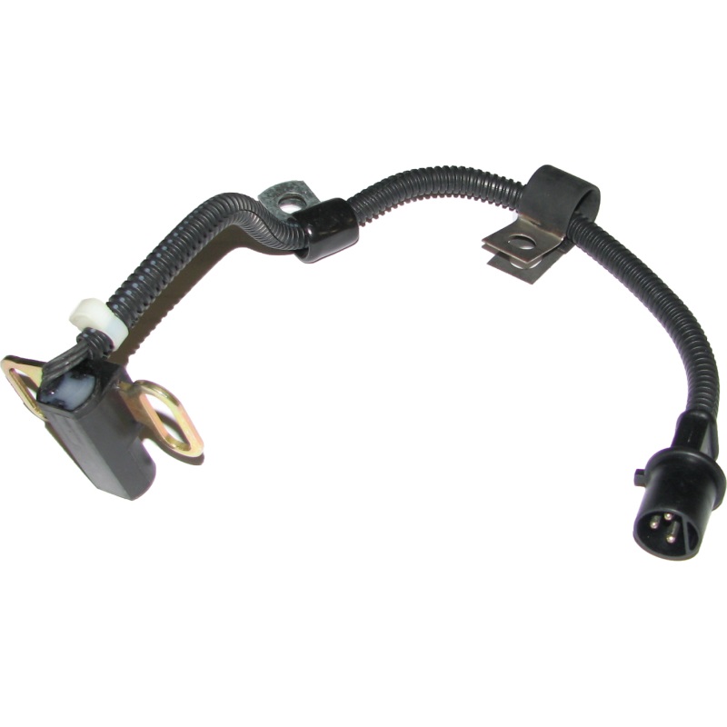

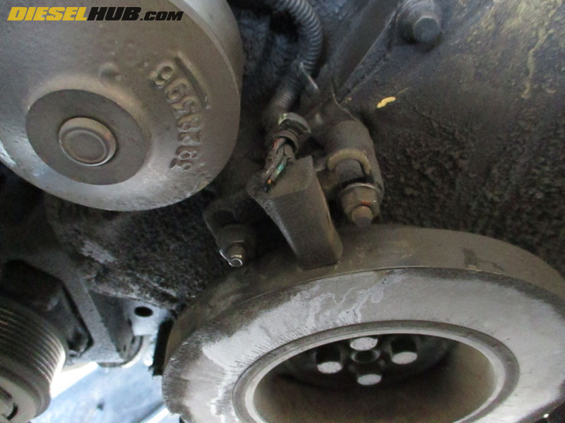

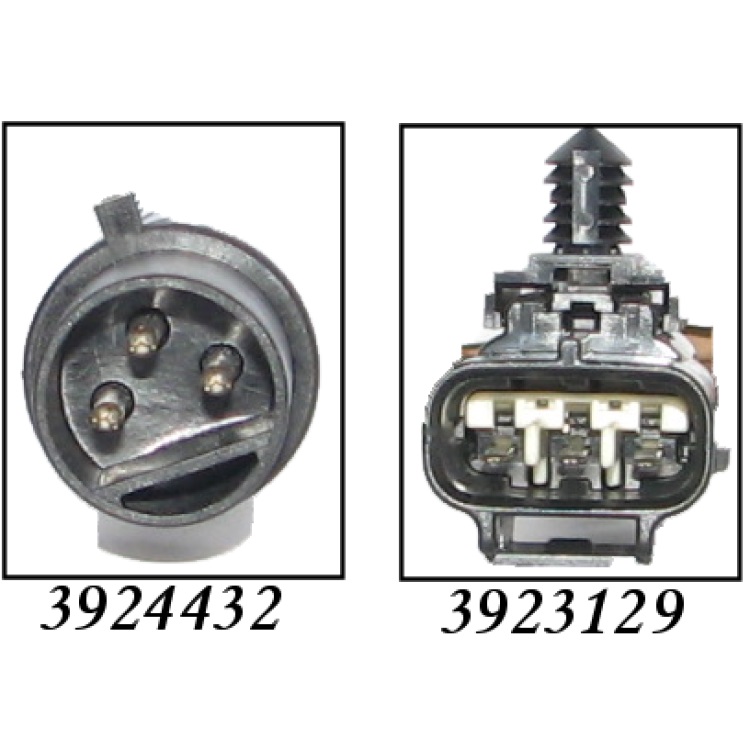

Nice solution and great work. So you used a Dodge 2-wire crank sensor and wired it directly into the OEM Lexus harness for the tach?
Correct, one wire to ground the other connect to the tach reference wire out of coil.

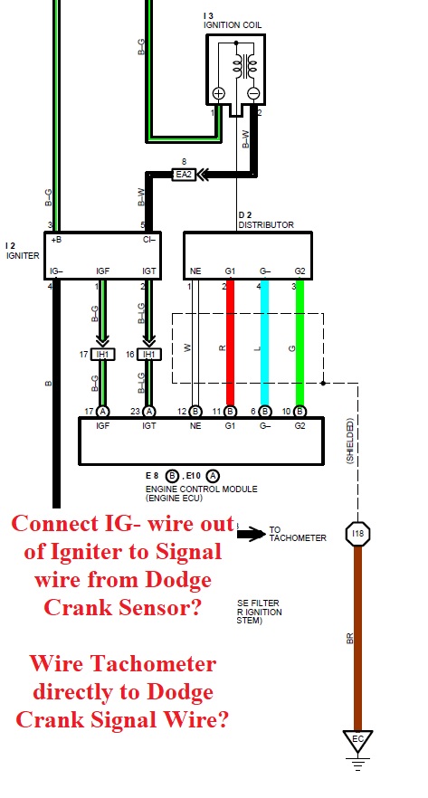

I am sorry to belabor this point, but I am designing my wiring harness for my 6BT Cummins swap.
I understand that you modified your Cummins crank pulley to have 3 notches instead of 2.
And that you wired the Cummins crank position sensor directly into the Toyota FZJ80 wiring harness via "the tach reference wire out of the coil."
Based on the ECM, it is my understanding that the FZJ80 tach signal comes from the ignition coil/igniter. So I assume that the igniter is supplying the tach with 3 pulses per revolution, hence the 3 notches on the Dodge crank pulley?
And you can just bypass the FZJ80 igniter and ignition coil wiring (IG-) altogether and wire the Dodge crank position sensor directly to the tachometer signal input to the dash?
And so the Dodge Crank position sensor would be wired with one pin to +12 volt power, one pin to ground, and the third signal pin directly to the tach signal input (previously supplied by the igniter signal)?
Do I have that correct?
