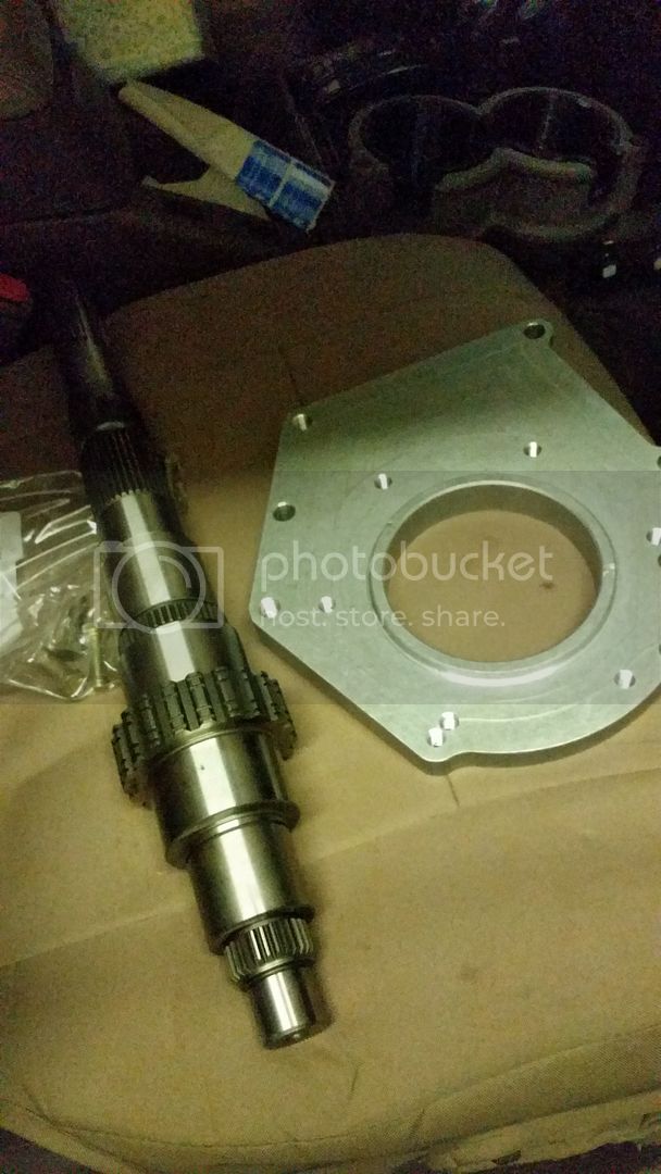

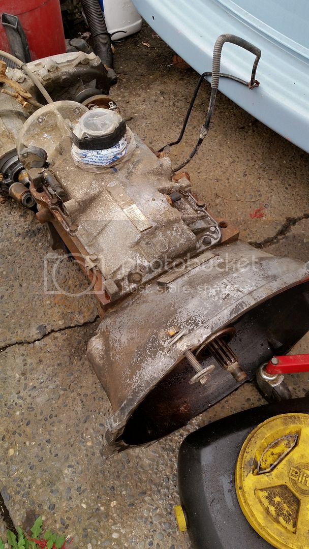

So far I have a diesel adapters HF2A to NV4500 adapter. Two Nv4500's one from a 95 Cummins and one from a 2001 6.0L chevy 1 ton. The one from the Chev is like new the Cummins one has been run hard, input shaft has play and the fluid is ugly. I plan to try and rebuild one myself and install the new output shaft for the t case adapter.

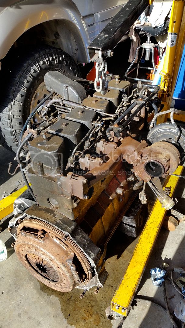

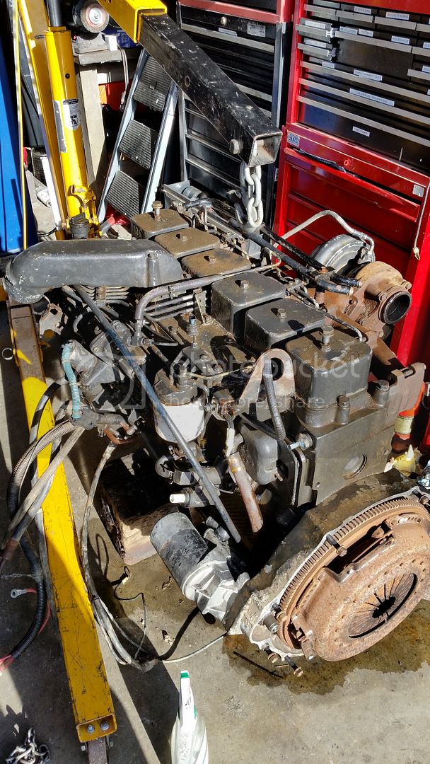

I have acquired a 97 6bt that was in a 5spd truck so it's got the 215hp rating. I had originally wanted a 1gen VE pump engine but finding one with less than 1/2 million kms was next to impossible. The 97 motor had 200kms 10 years ago when it was written off in an accident. It's since been stored in a barn so it's filthy, but all the critical opening where sealed and the cylinders where fogged.
