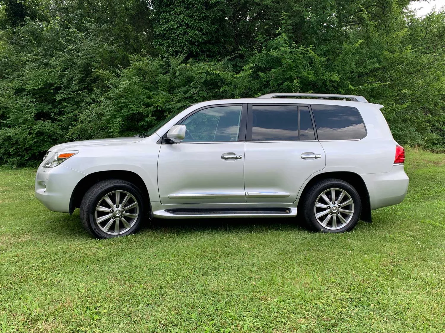

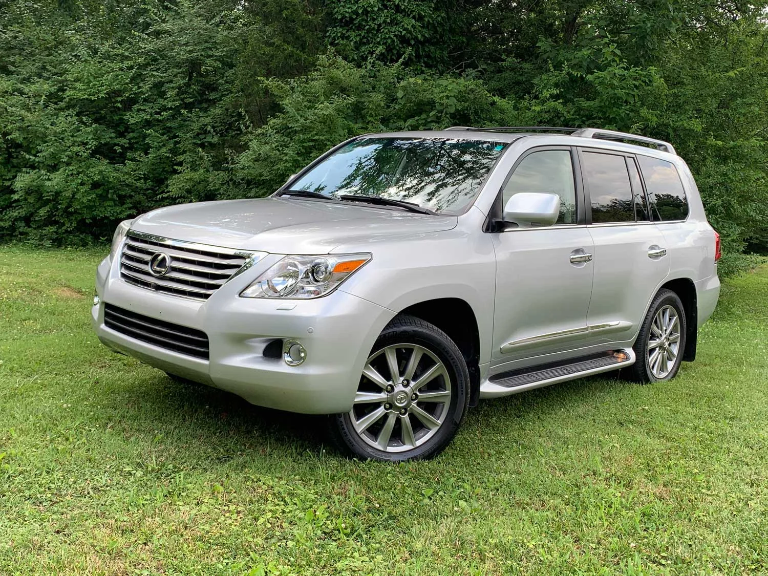

Currently, my rig is completely stock (see below) with the exception of the remote starter I installed myself.

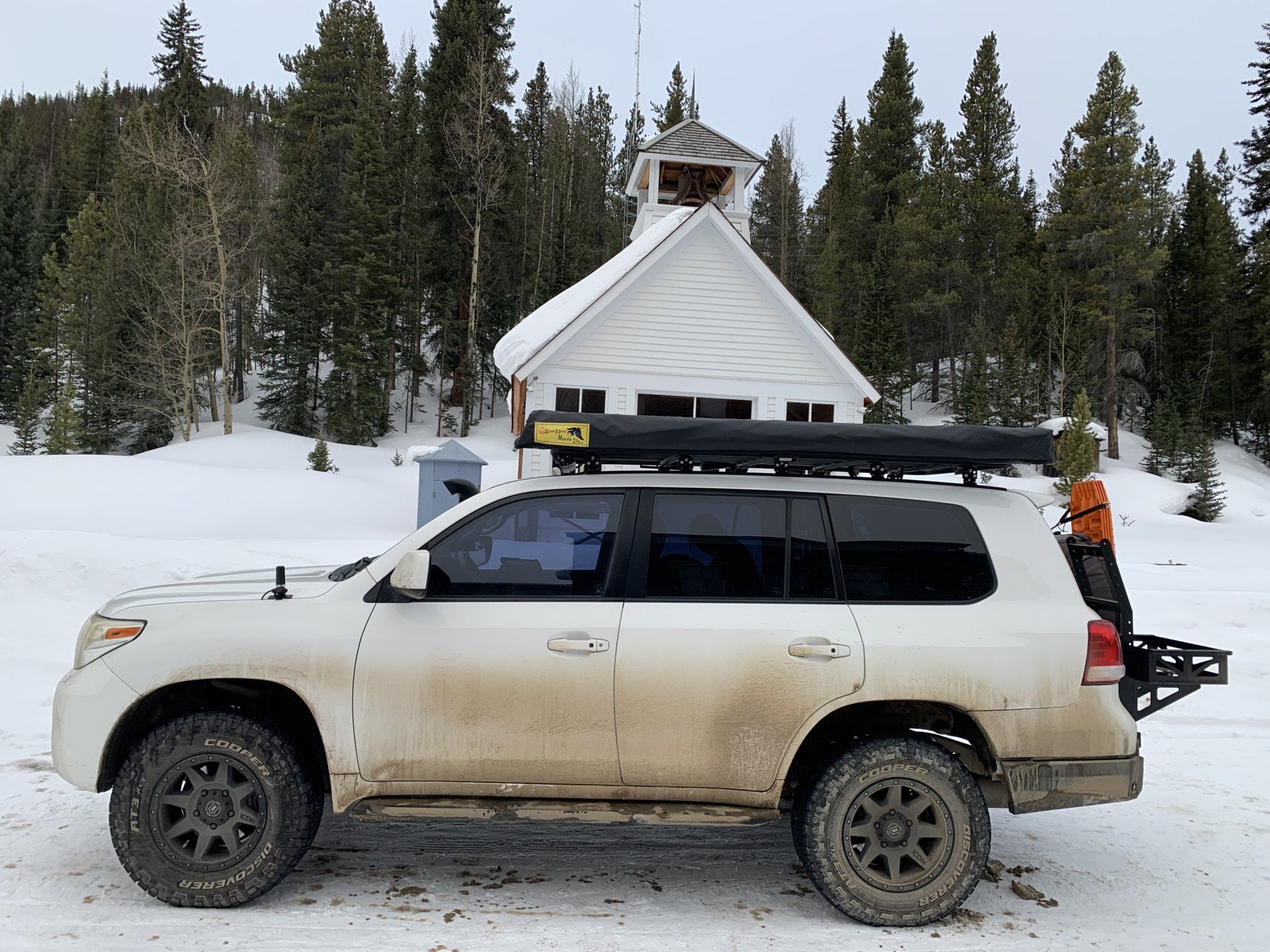

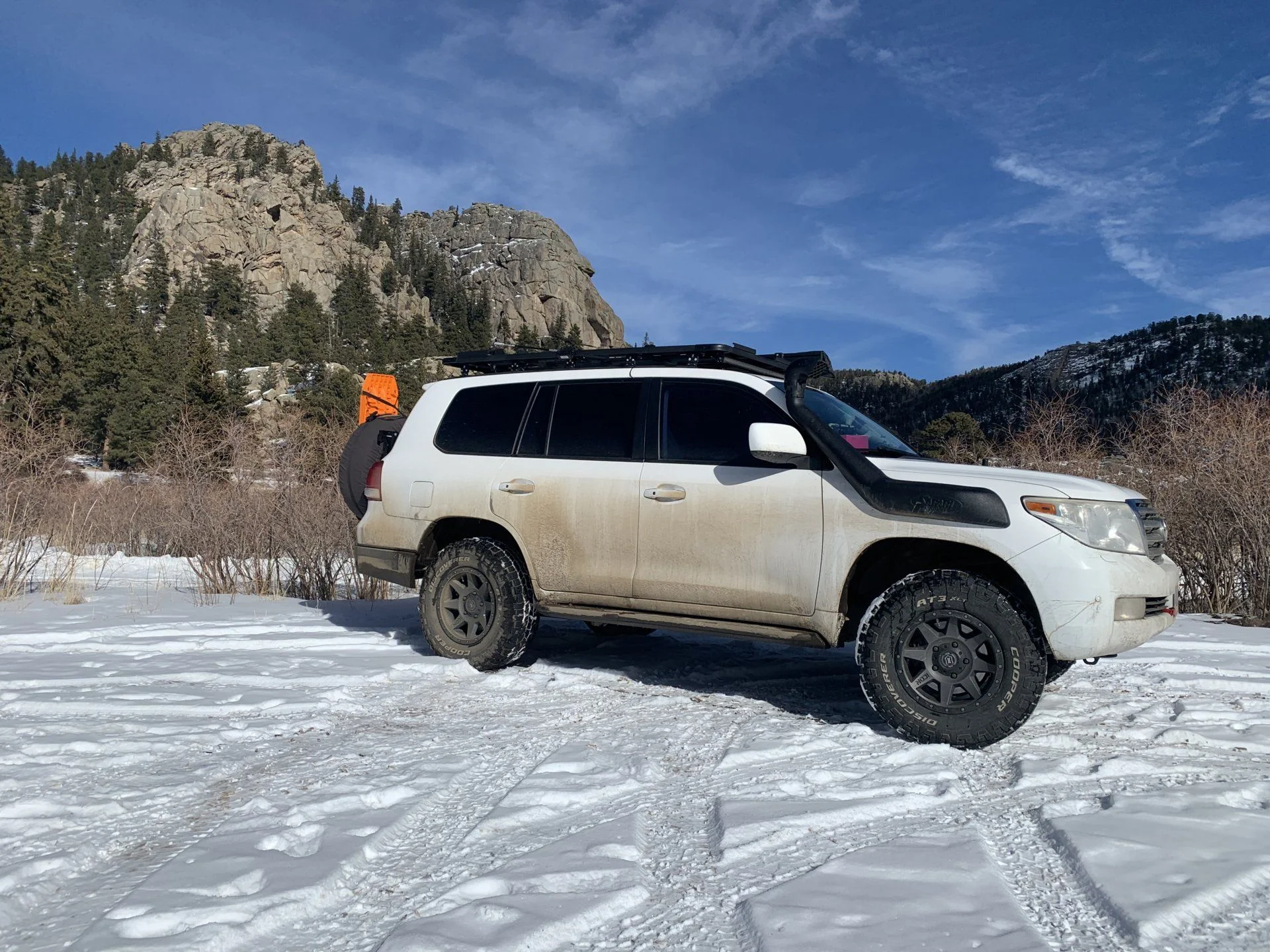

I have the wheel/tire setup you are looking at. Great road manners, had no issues across 3.8K road miles/2.2K off-road and trail miles.View attachment 2234427
@LittleBurroAZ You are several Mods ahead of me and I like it. You have an LC, right? Am I correct in assuming that you've lifted it some? If so, how much? And those are the 285/70R17 or 286/75R17? I'm just trying to visualize mine with the same tires and lifted via AHC Sensor Lift.
From what I've read on here, the lift itself doesn't do much, if anything to help with the clearance for the tires but it does help get some of the sensitive parts of the undercarriage a little further away from rocks and such.

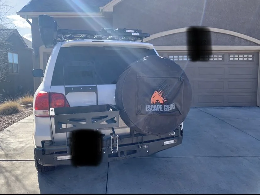

Also, can't tell from the pix you provided...what are you using for the spare tire, traction mats, etc.? Is that an ARB bumper or something similar?
Thanks!
It’s an 08 LC200 on a BP-51 suspension and 285/70R17s. The lift maybe gave me 2 to 2.5” and tires another 2”. I’d go measure it and send you pics but I literally just dropped it off to get a front bumper put on and finish the project off.
@LittleBurroAZ Congrats on getting a new front bumper! Which one are you getting? Also, which one do you have on the back? I'm still a ways away from getting bumpers but I can still dream :)
Left off some details. From the pics you can see I removed the splash guards to prevent any running. There some slight shaving on the lower front of each wheel well as well to prevent rubbing as well. We are talking little slivers about 1 cm wide by an inch long. No issues rubbing at all.
@BigMF I am getting a Dissent bumper put on up front. Not super heavy duty but suits my wants and what I’ll be doing. Slee Off-road rear bumper. Expensive rear, but it has been worth it to have a rear dual swing out that hasn’t been a PITA and that has awesome build quality.
On the rear are maxtraxx boards strapped on to the discovery at3 Xlt spare tire.

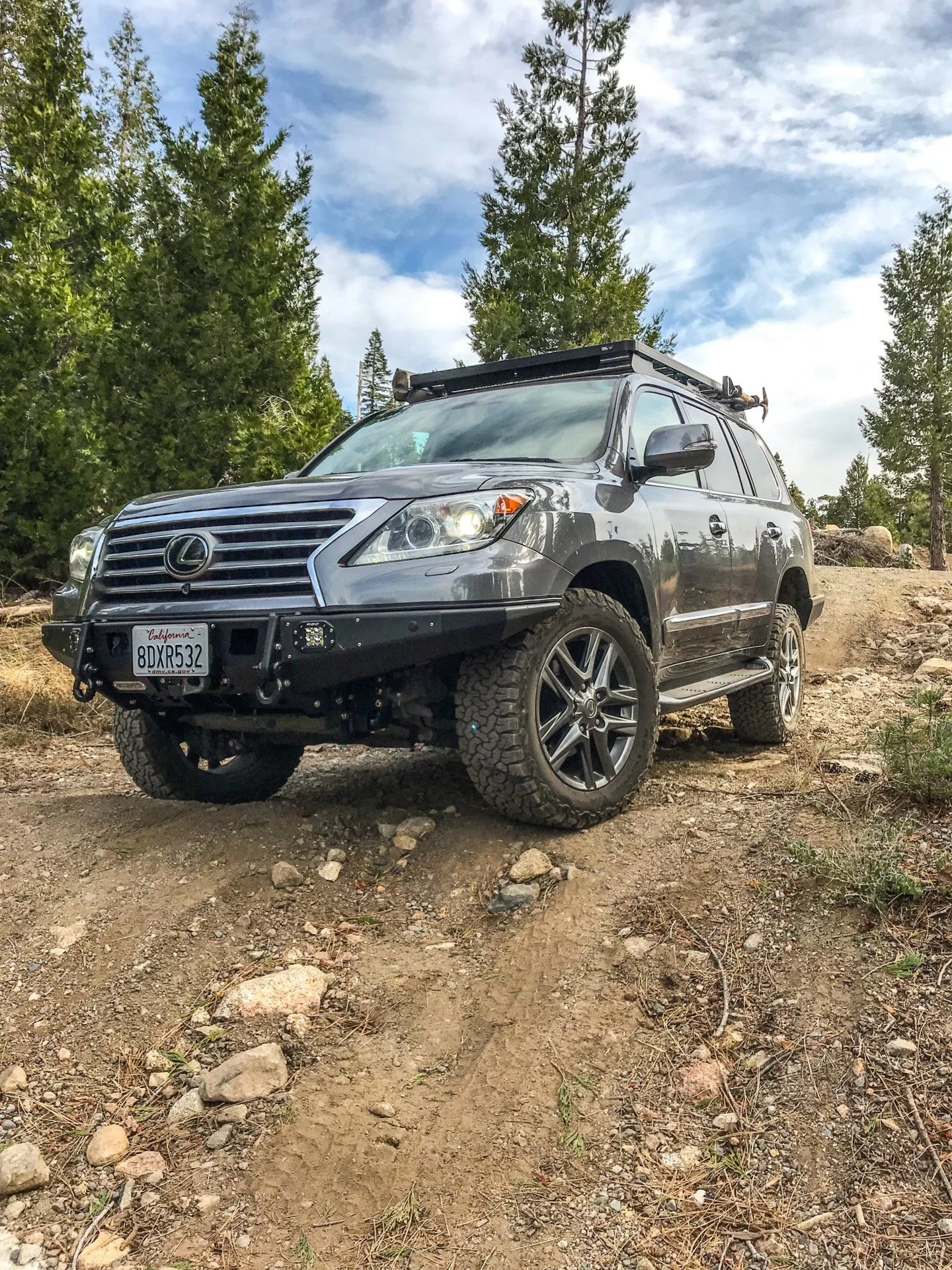

ARRRRRGGGGGHHHH!!!!!!! Absolutely love that bumper but I really don't see driving to California from Tennessee just for a bumper. I'll go cry in my coffee now.
Yeah, at the moment you would need to bring it in to their shop. They will be shipping them at some point, so it might be worth dropping them an email to get your name on the list of interested buyers.
And I would challenge you on the idea that driving out to have a bumper installed is not worth it. The Dissent shop is surrounded by some of the best trails in the country. Aside from the Rubicon and Fordyce, there are hundreds of miles of amazing trails throughout the Sierra. In addition, on the drive out and back you would pass through the Rockies (WRNF), and some of the best parts of Utah, and Death Valley, and the Eastern Sierras. If you take the the I70 route through Denver->Grand Junction->St George->Vegas->Lone Pine->Tahoe, you would essentially hit the best that the US has to offer as far as scenery and overloading opportunities. It is the perfect road trip for an LX. Hell, just the section of I70 between Denver and Vegas would blow your mind.
