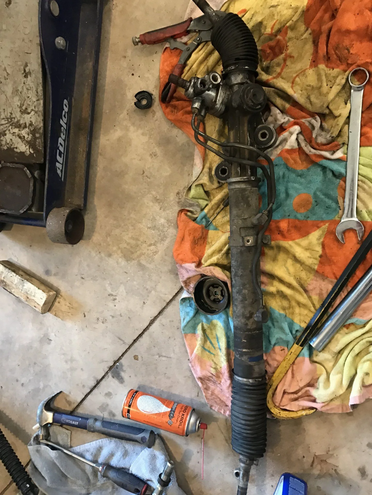

So heres some photos from my steering rack job. Started it two weekends ago, everything came off smoothly except for the rear pressure line coming from the rack. The line twisted off inside the sleeve, making it impossible for me to know it was twisting until it was too late. Nobody in town had a replacement and I could not form one myself.
full
full

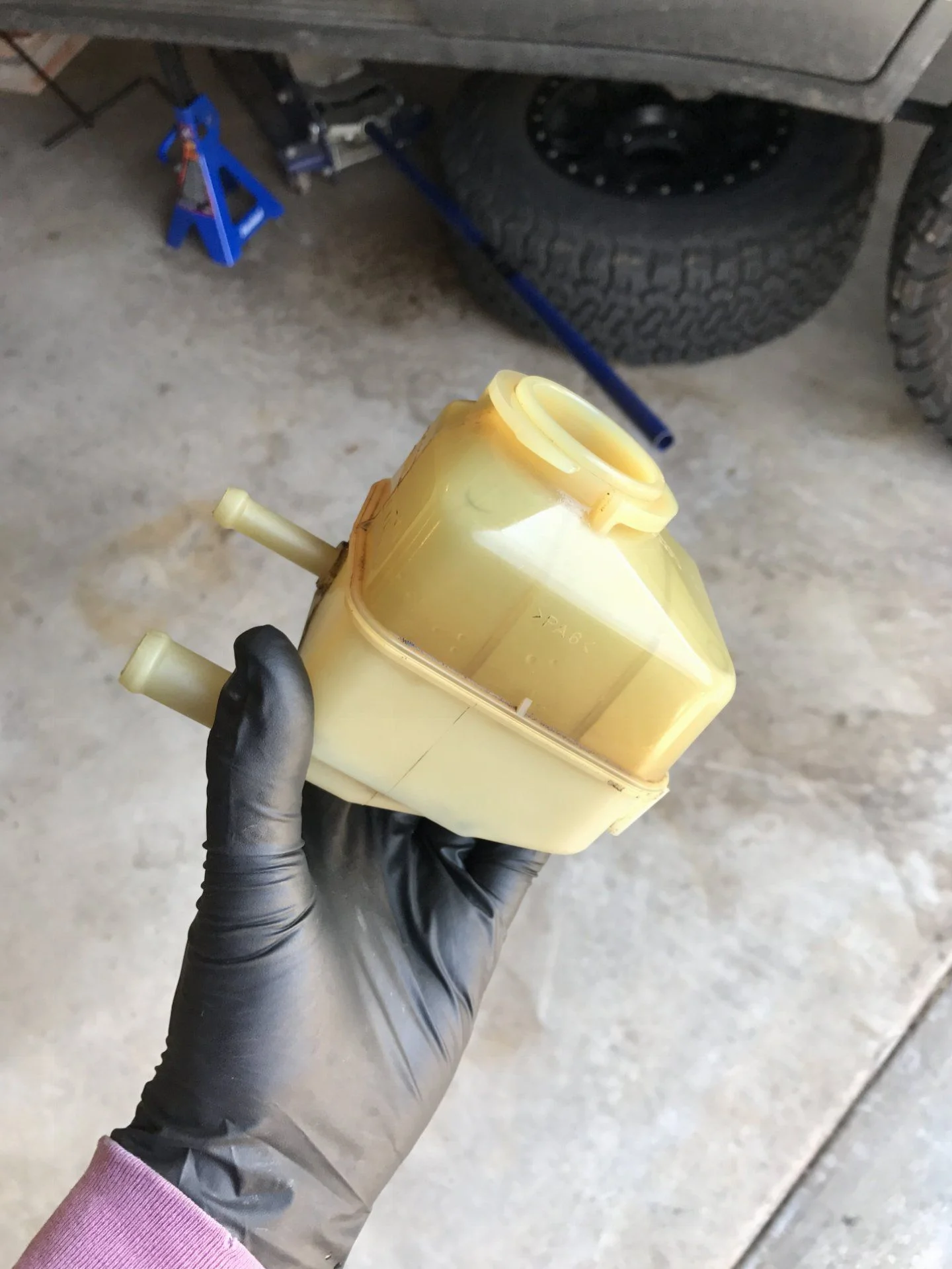

With basically a completely whole new steering system besides the pump and reservoir, I figured I would flush out the reservoir real good. I was surprised at how well my fluid looked when emptying it from the system, but I was even more amazed at how clean the reservoir was before cleaning... This pic is before cleaning with degreaser and water.
full

Wow! I am so happy to have a fresh steering rack in there! It made a huge difference on steering precision and tracking on the highway. Didn't solve all of my issues, but I think they are primarily alignment related. More pics from the install:
full
full
full
That reservoir looks great. It is cleaner (before you started) than mine was after I cleaned it.

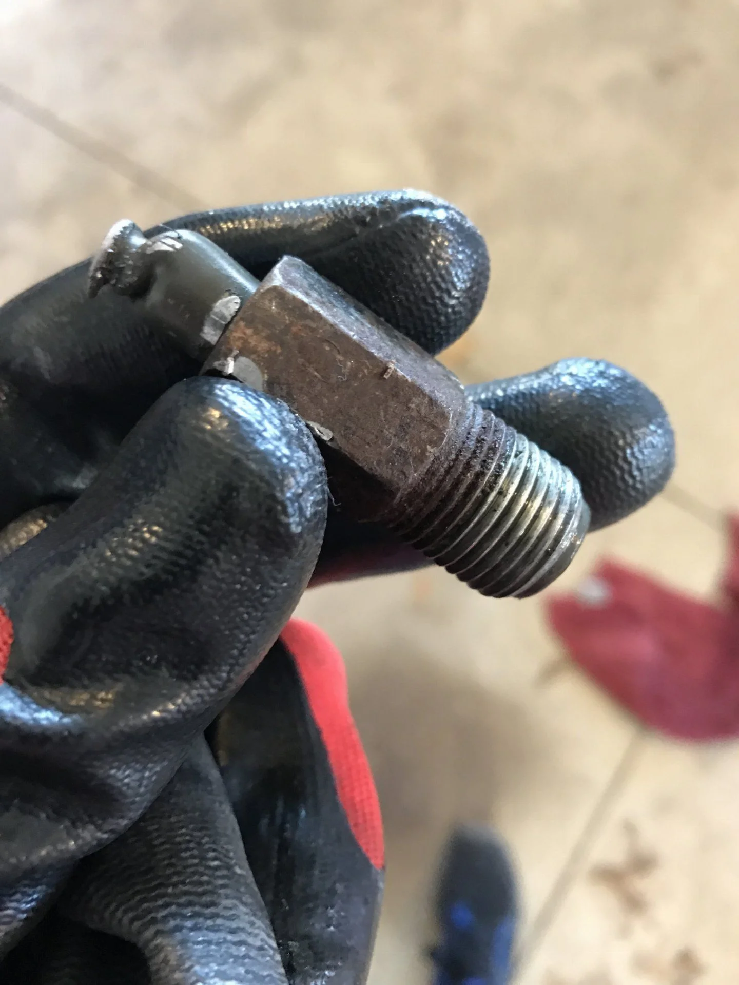

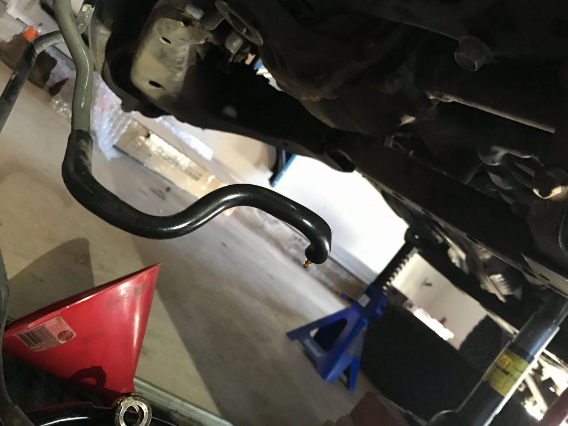

Dealing with two broken bolts for the rear stabilizer bar brackets that hang off the frame rails. I am real close to just welding them on. Have been unsuccessful with extraction
Thankfully I'm luckier than that, the only one that broke on me was the driver's side bolt on the outside of the frame. But breaking that bit pretty much screwed me. I have considered running a small bead on the upper part of the bracket, but really would like to stay with the factory setup.

How bad is that bit jammed in there? Not sure if this will help you or not but I have had to cut a drill bit out in the past on another vehicle with a torch and use a thread repair. Broken drill bits and taps are extremely hard to extract because of the hardened tool steel that they are usually made of.

Thanks! The bit is pretty stuck in there... I've tried hitting it with a better drill bit, only to dull said bit. I think the torch is my next option, just worried about messing up the threads despite the hours under my belt using an acetylene torch. I guess if I fubar it, I can always just weld the bracket on.
