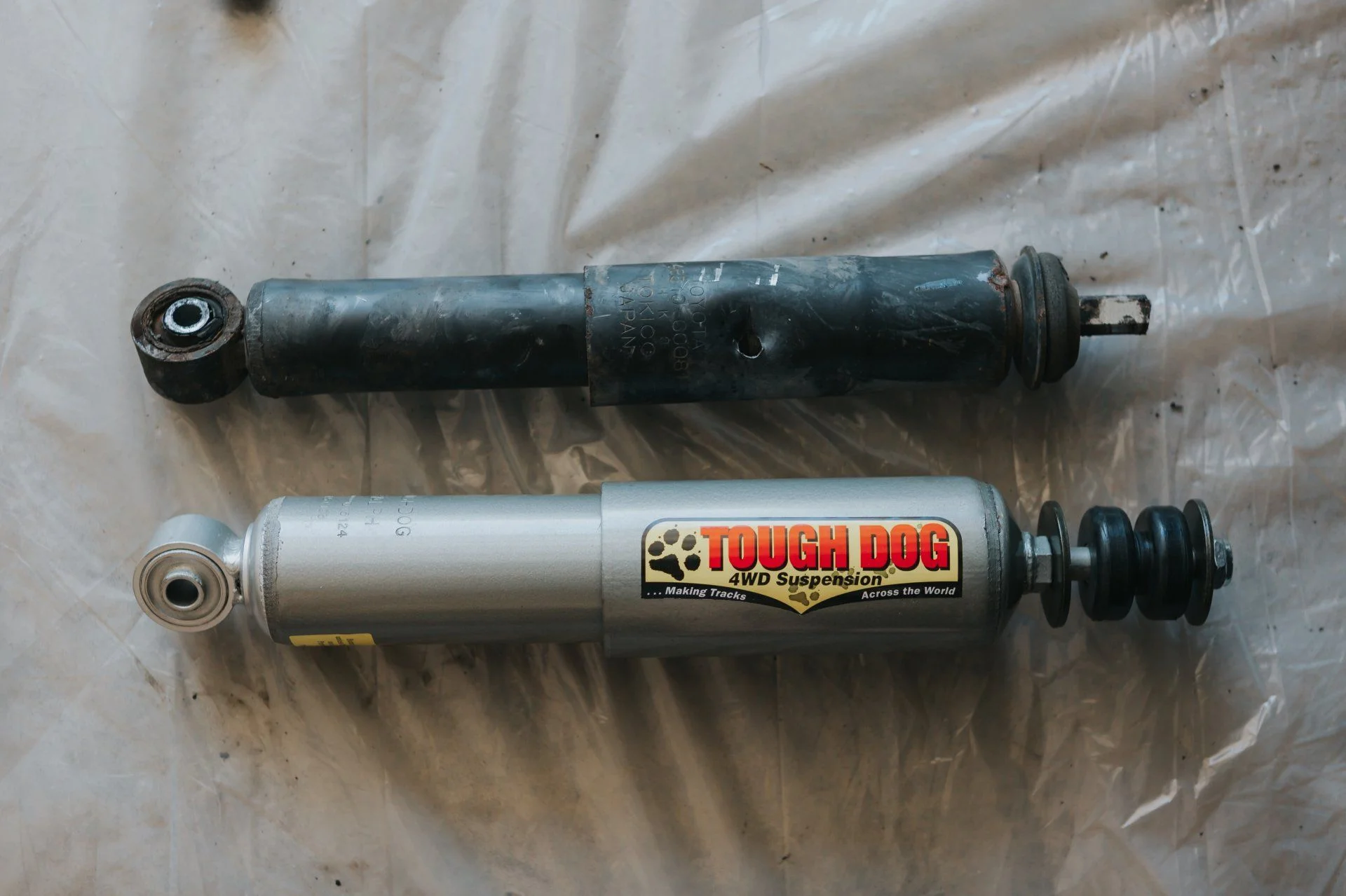

After evaluating all my options, and my budget, I decided on Tough Dog from @reevesci (Trail Tailor). Me and Jason had already discussed the system at length when he first started to bring the system to the states. The system was well priced compared to other options, and Jason had nothing but good things to say once he installed it on his 100. Based on all the above, this is why I decided to go with the kit. Heres what I ended up with:
-53mm RALPH Foam Cell Front Shocks
-41mm Foam Cell Rear Shocks
-Light Duty Rear Coils

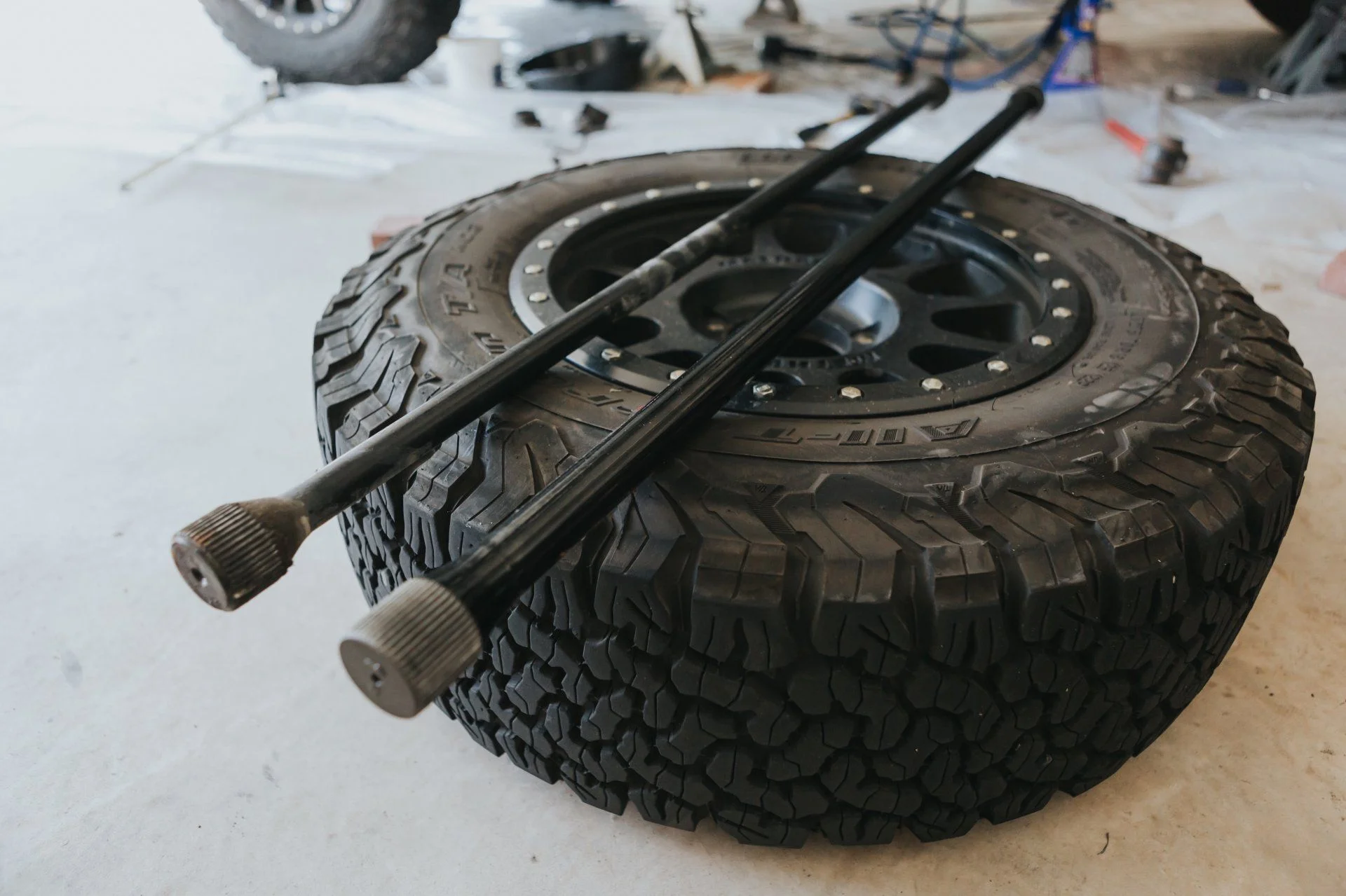

-Torsion Bars and Strengthening Brackets
full

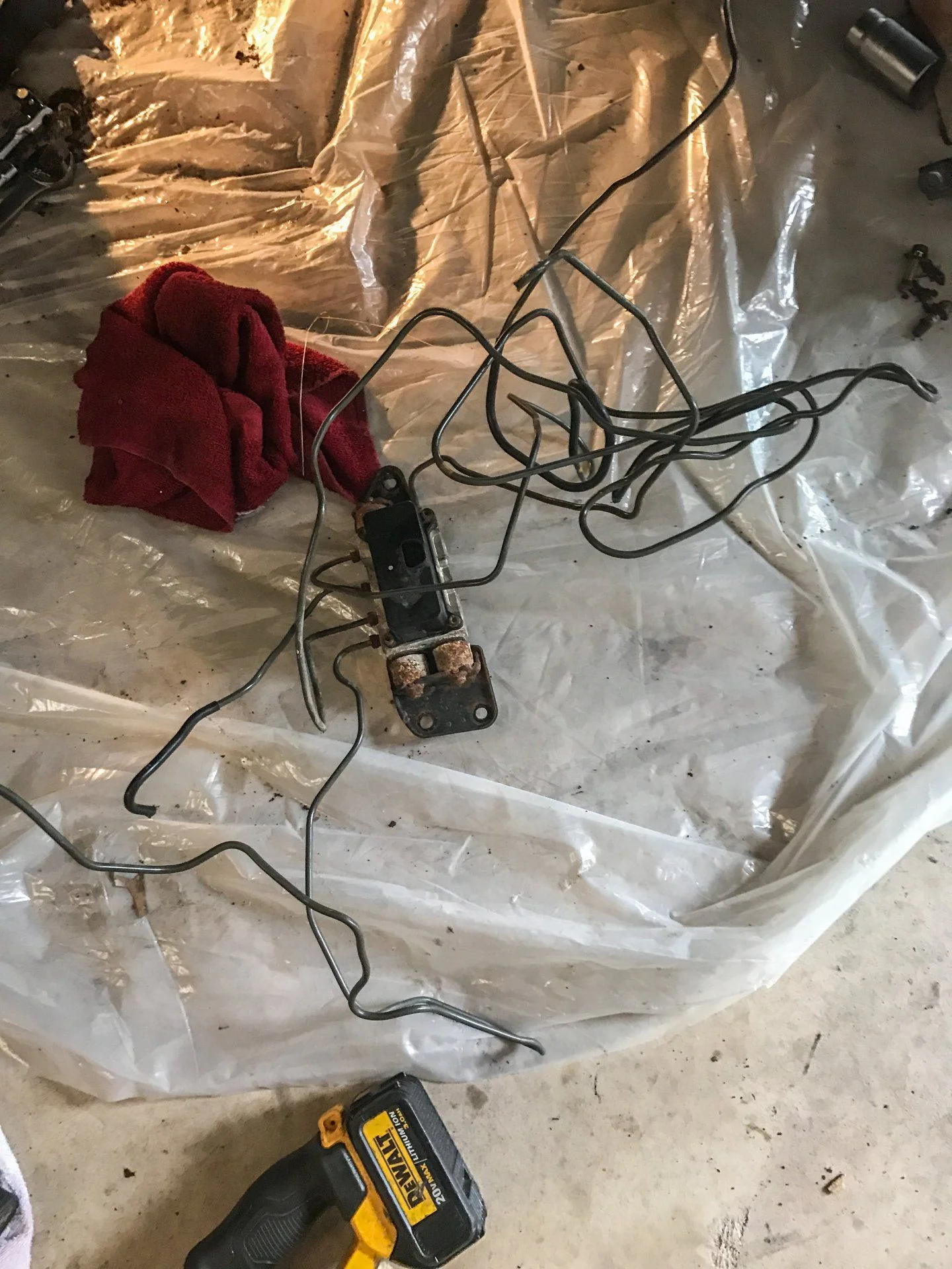

The install was BRUTAL, taking about 3 full days of work with the help of my good buddy @WillGentry . Even @SUMMIT CRUISERS Jr showed up for a little bit. Now the AHC system itself wouldn't have been too difficult to remove hadn't it been for the minor amount of rust on my vehicle. Regardless, I managed to get almost everything off without breaking any bolts off in the frame. One thing that really sped up the process was my willingness not to save the shocks. After trying to loosen the top nuts on the shocks, out came the reciprocating saw and made quick work of both the front and back shocks (after removing the hydraulic fittings of course). I also chose to remove everything, aka: fluid reservoir, accumulators, globes, shocks, control valve, ALL lines, and the sensors. As far as the electrical system goes, I only unplugged the AHC computer and so far so good.
Some tips:
-Presoak everything (Kroil is my drug of choice)
-Buy a 12mm 6 point ratcheting wrench (this will be used the most)
-Cut off your shocks unless you really just want to save them. Took me 30 mins per shock max.
-I suggest removing all lines (seemed incomplete just leaving them in there)
-The accumulators have 3 mounting bolts (12mm) and one is on the top of the frame rail..
-The hydraulic line to the rear shock is bolted in a place that is practically inaccessible. Good luck, I was laughing the whole time because I couldnt believe how awful the placement was. Use the above 12mm wrench to remove.
-Be prepared to get dirty.
-I put plastic sheeting down under the cruiser to minimize stains and whatnot on the garage floor.
Onto some pics:
full
full
BEEFY
full
full
full
full

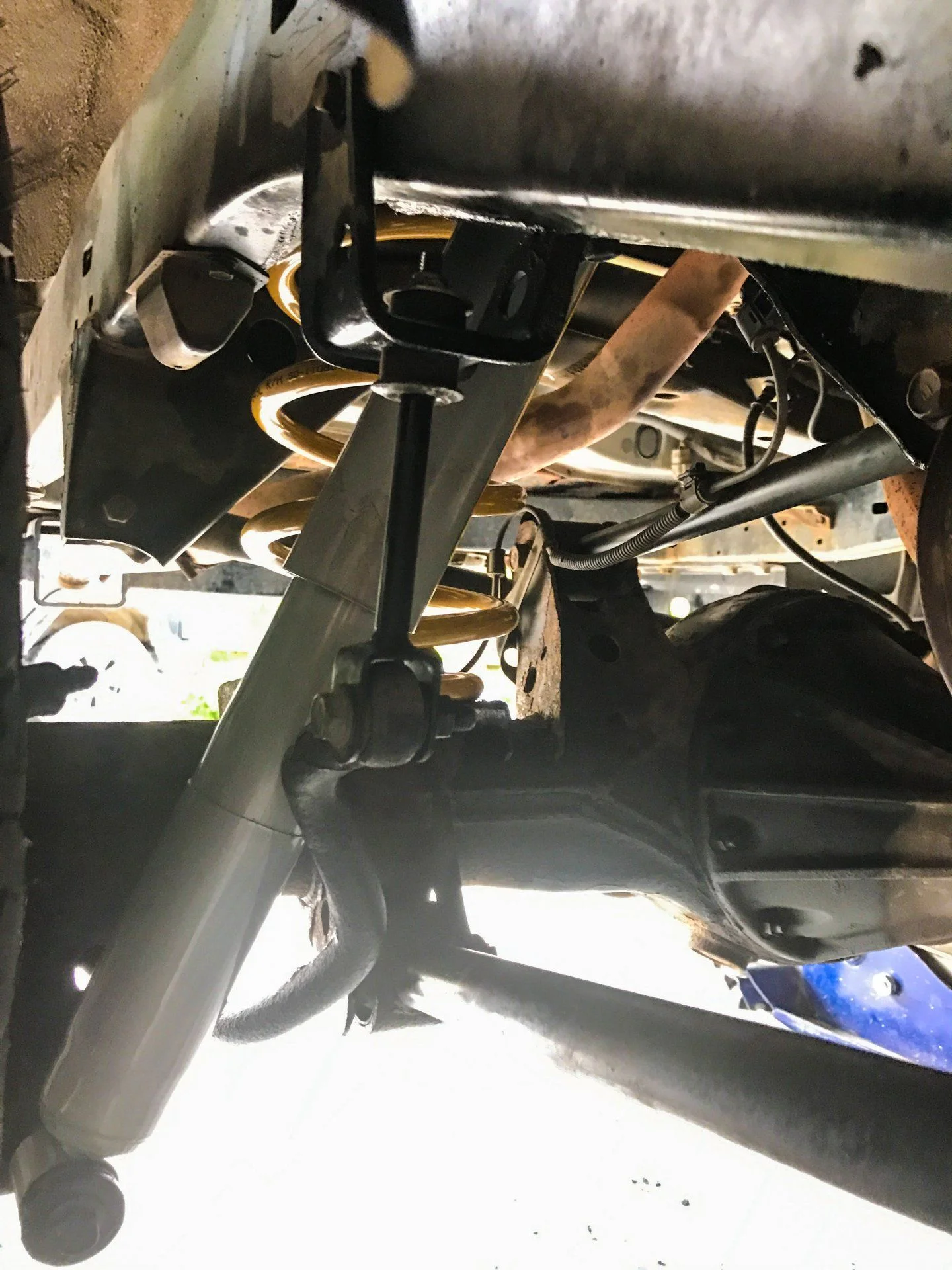

So now that I have had the suspension on for about a week now I wanted to give a fair honest review. So far I am pretty pleased with the system. Having driven a lifted AHC rig, a rig with OME setup, and a stock 100, this is by far my favorite ride.
Ride Quality:
The front is perfect. In my opinion, it has the perfect compression and rebound valving. It soaks up bumps, but is never jarring. The rear can be a little bouncy at times, but settles quickly and is still nice and firm. Despite getting the light duty coils, I think once I get some more weight in the rear it will calm down a bit. I am currently running super light in the rear (no rear seats, removed rear tire and crossmember due to failed lowering mechanism), but plan on adding a swing out and full size spare this summer. Also I plan on upgrading to the 45mm adjustable rear shocks, which should help dial in my ride perfectly. Keep in mind I am super sensitive when it comes to cars.. Overall I would compare my ride to my buddies stock tacoma, firm but not uncomfortable.
Parts Quality:
The shocks are BEEFY. The front 53mm shocks are absolutely huge which I appreciate considering the super short travel length of our front shocks. The rear 41mm are just as impressive. They come with a 24mm top nut, which is an upgrade over the 22mm stock size (the threads are YUGE). Not too much to share with the coils, other than they sit perfectly level and I kind of dig the honey-mustard color. Same with the torsion bars. They are super beefy compared to stock LX bars (see above photo) and have a great spring rate for the front end, with plenty left for handling future weight.
Other notes:
It doesnt ride as plush as a stock/AHC 100. This is EXPECTED. This heavy duty suspension was installed to give more stability, anticipate for future heavy mods, and to replace my worn system. There is more initial harshness at first bump compared to before. I am attributing this to my height and not the suspension, later on I will be extending my sway bar links which others have claimed solves this initial harshness. I will also be adding aftermarket UCAs down the road to correct alignment and replace UBJs, even though it tracks/drives fine right now.
Height Change:
Before:
-Front: 21.5"
-Rear: 22"
After:
-Front: 21.75"
-Rear: 23"

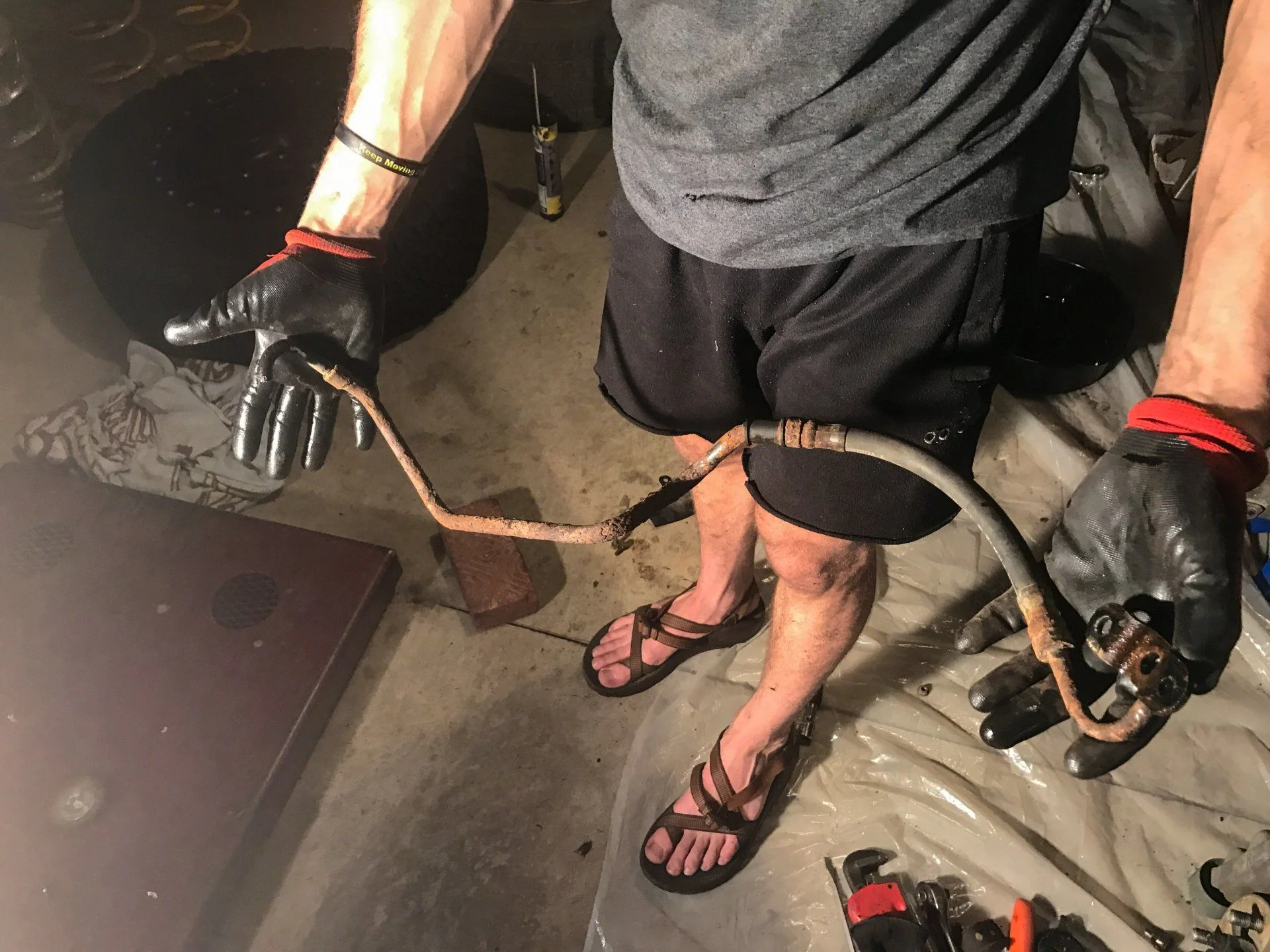

So heres some photos from my steering rack job. Started it two weekends ago, everything came off smoothly except for the rear pressure line coming from the rack. The line twisted off inside the sleeve, making it impossible for me to know it was twisting until it was too late. Nobody in town had a replacement and I could not form one myself.
full
full
I had to leave the cruiser in the garage all week while I waited on replacement hoses from Rock Auto. I went with the Sunsong lines, others have used these on the forum. The lines showed up and were honestly good quality. Everything lined up and works great, I couldn't justify spending another $600 on new OEM lines.
