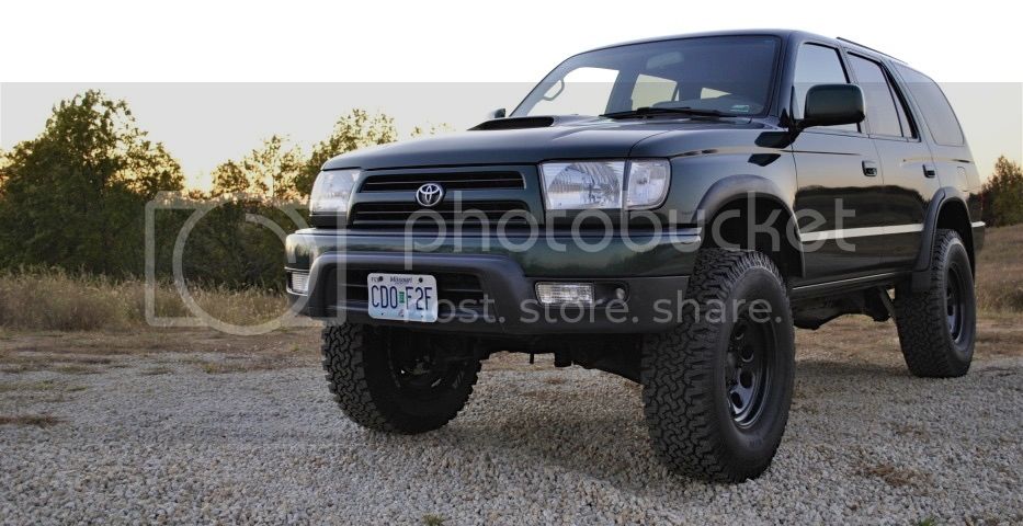

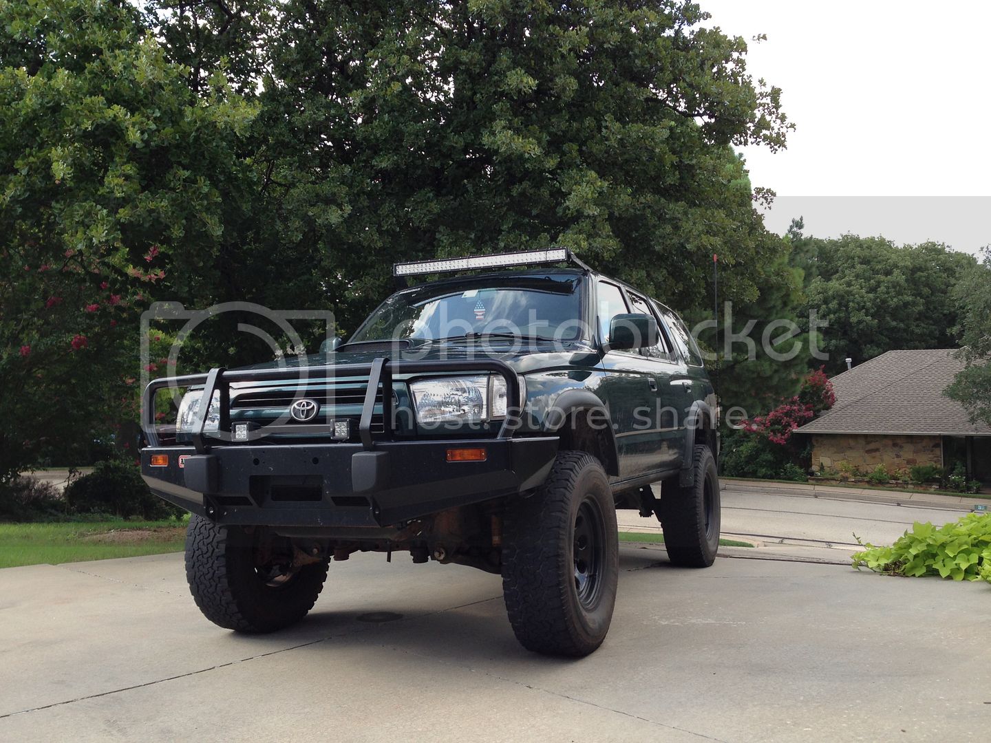

In comes the first of many - a '99 4Runner. Unfortunately I don't have any photos of the sequoia or 4runner, but they were just your basic stock variant. 2 months into ownership, I rear-ended a jeep compass. Part of it was due to teenage stupidity, part due to malfunctioning brakes, but regardless I was devastated when I totaled my dream vehicle.
I knew I wanted another 4R, but this time I wanted to find the right one (rear diff lock, sr5 sport, etc). Luckily for me I stumbled upon a green '99 with 160k and the rear diff locker! I talked to the guy some and headed up to Kansas to pick it up.
Throughout the rest of high school I built it up to suit my needs.

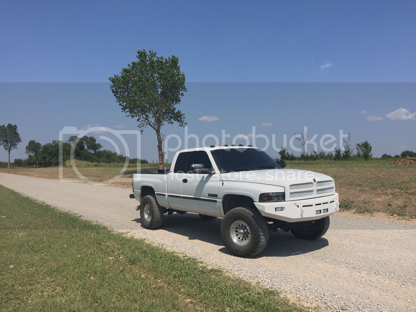

However after high school I ran into a huge problem with my setup.. The 4Runner was way too small to fit my needs. In comes the next toy, a '99 Dodge 2500 4x4.
It had tons of power, space, and was the smallest diesel truck you could purchase at the time. Once again, I slowly built that up with the aspirations of eventually putting some sort of camper on the back. I got about half way done with the build and finally had enough. After replacing 2 injection pumps, the whole fuel system, and many more repairs costing more than the worth of the vehicle, It was time to let go of my bad investment. I knew I should have listened to my father and stuck with a Toyota.

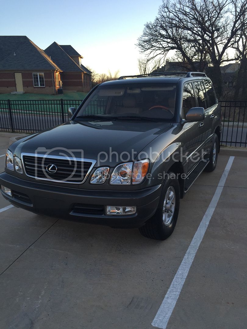

2000 Lexus LX470 with 114,000 on the clock.

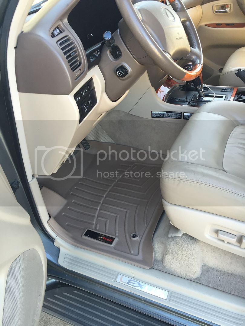

First and foremost, weathertechs.

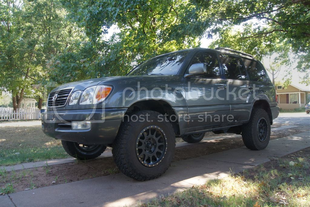

Then came the lift. I decided to stick with the AHC system for now, but don't feel like Im keeping it long. I have created a separate thread to document that: 2-2.5" AHC Lift Using King Coils & Shock Spacers

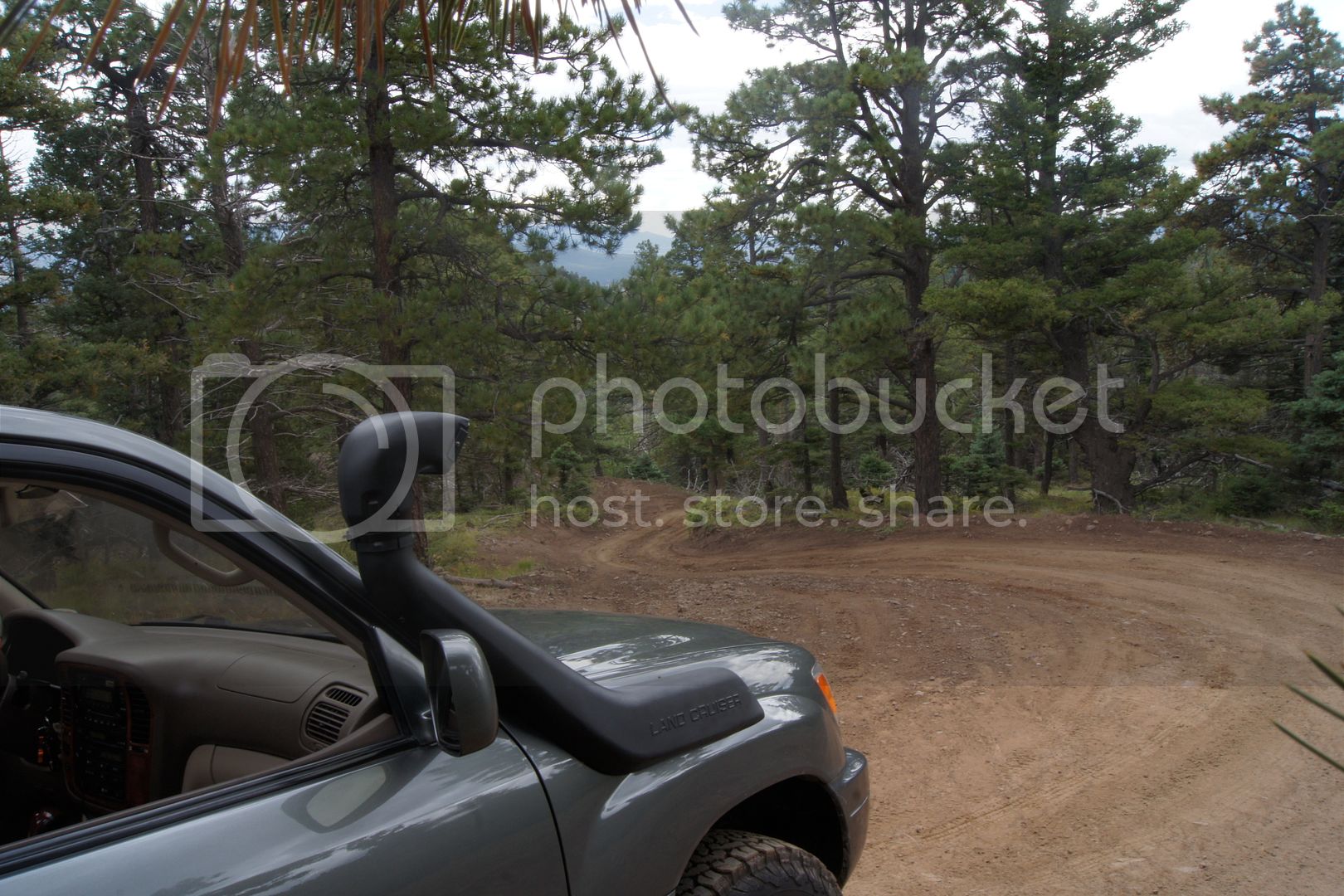

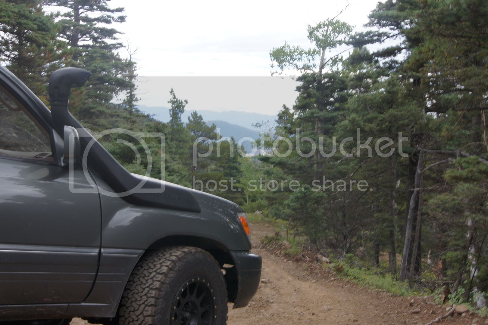

With the funds diminishing, I decided to go ahead and go in on a budget snorkel.

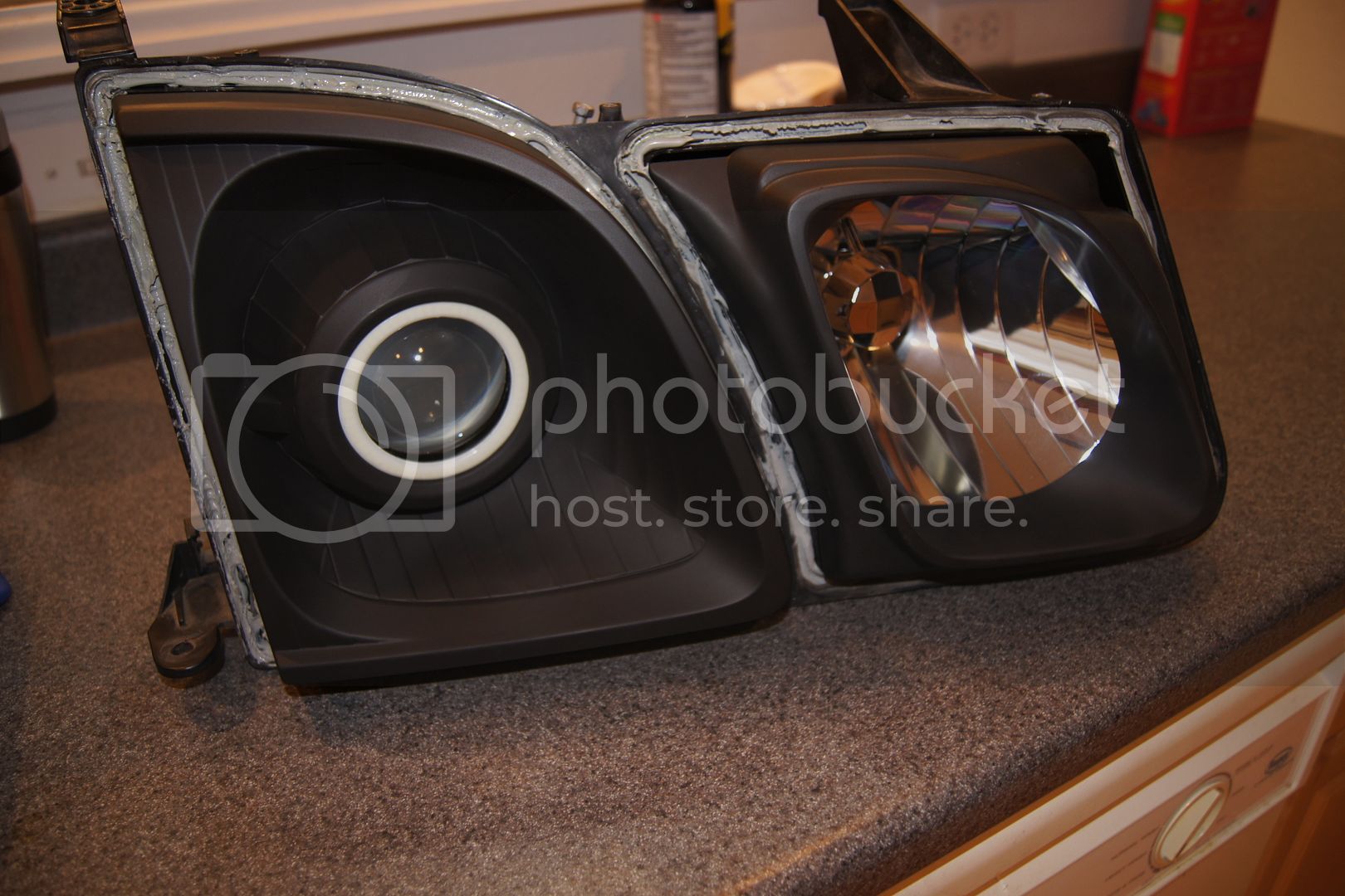

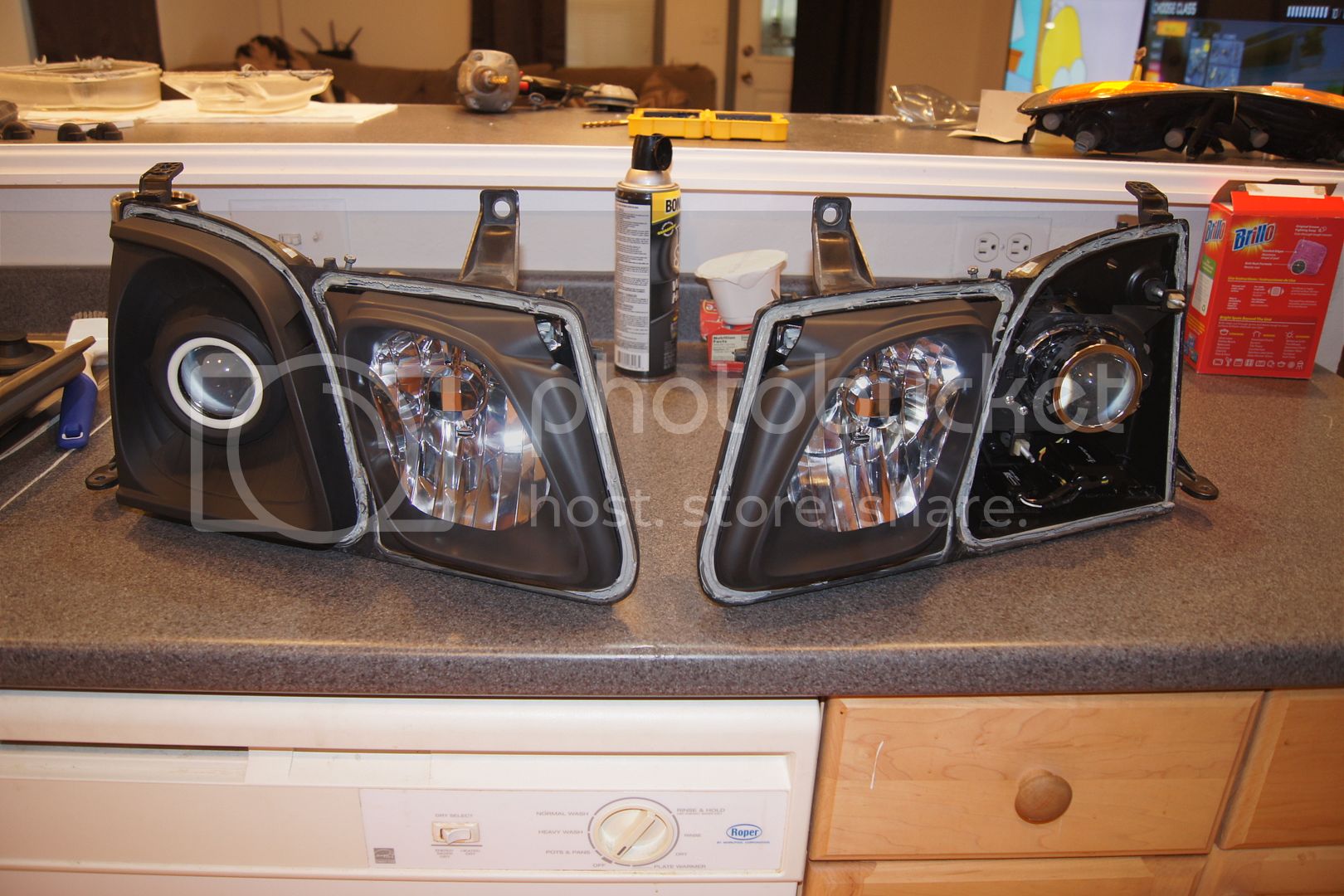

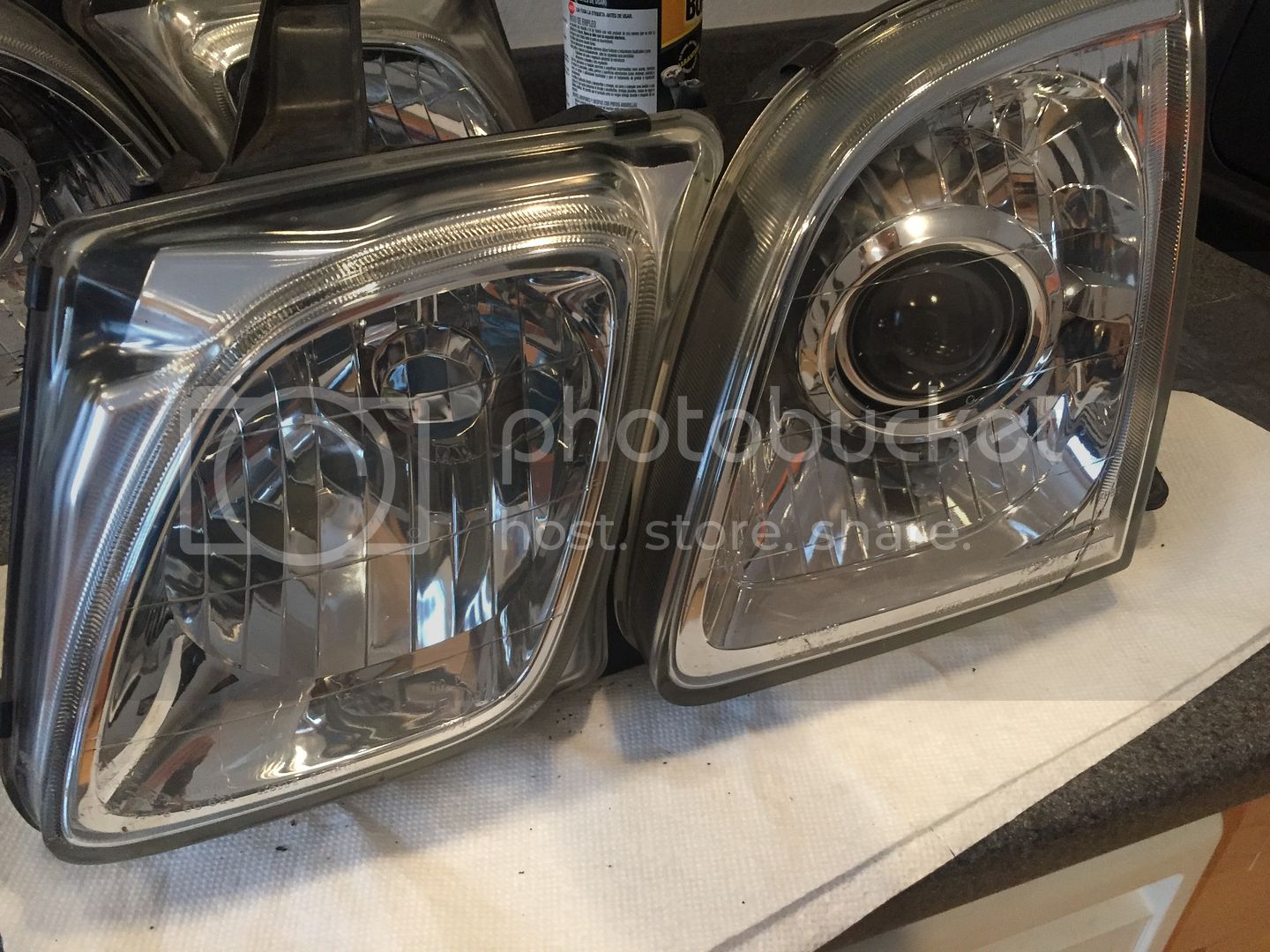

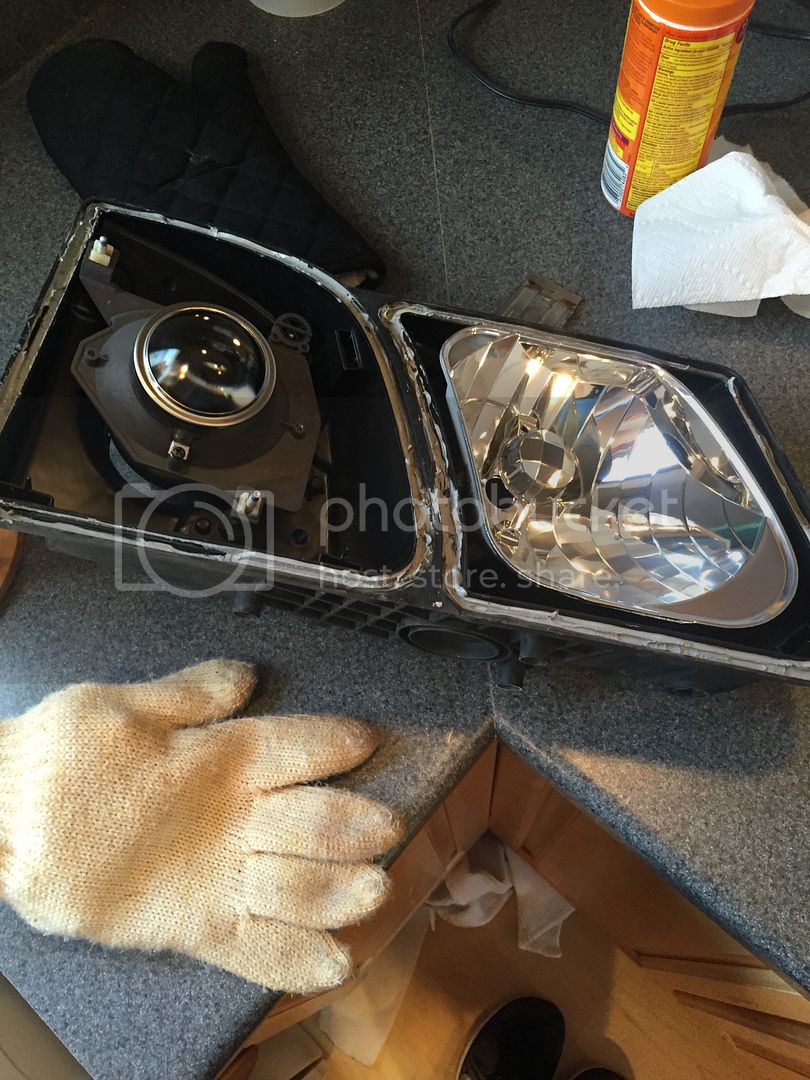

One thing that has always bothered me on every vehicle I have owned is the stock lighting. Some are good, some are bad, but the case for most, is that they can always be improved. I have done several headlight builds for friends and family in the past and figured it was time to start one for Lexie. Heres the build out:
-Acura TSX Projectors
-The retrofit source Morimoto HID kit (Phillips Xtreme Vision Bulbs, 35w ballasts, relay set up)
-LED Halo's to eventually be used as turn signal.
-All supporting hardware.
I decided to paint the housings black to be different and I love the grey/black color combo. Still trying to figure out what to do about the corner lenses. Here they are on the cruiser:

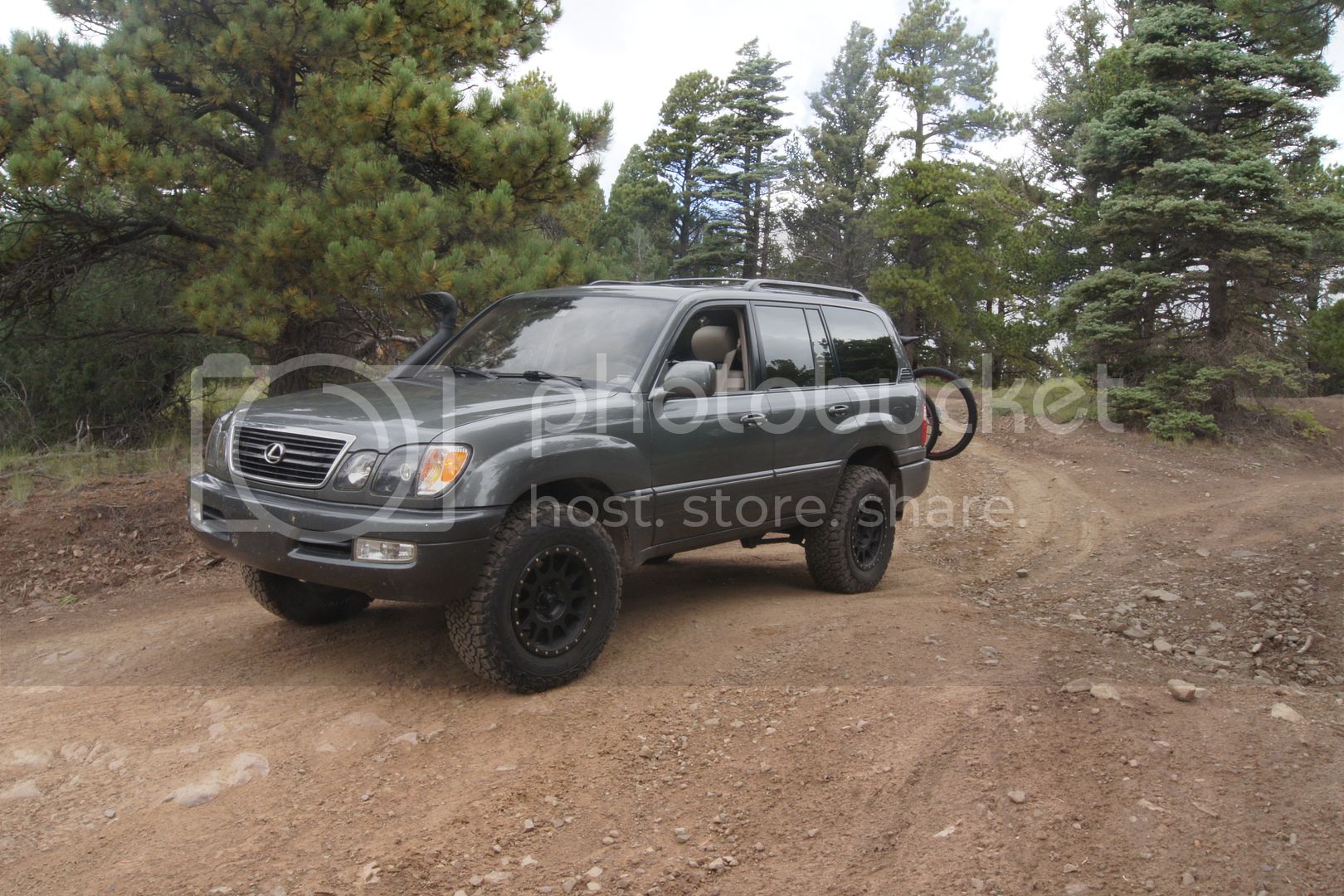

And thats about it so far. Currently trying to replenish the modification fund, and just enjoying the great outdoors with my cruiser. Heres some photos from a recent Colorado/New Mexico mountain biking trip.

This weekend I ended up lowering the suspension to 20.5" front / 21.5" rear. This solved my bump steer issues and the LX rides/handles much better. I had the tires road force balanced as well and this almost entirely solved my vibration issue. I still get a bad vibration on certain surfaces, but it is not often, and it's usually gotta be decently rough. At this point I am contributing this vibration to my blown lower hydraulic shock bushings. So once I eventually get a fresh suspension in this thing I will see if the problem persists.

Man I love your dedication to the headlights. Great lighting is such an overlooked tool and necessity!
The tint looks good. The wheels and tint on that color are a great package.
Thanks man! After owning several vehicles with less than adequate lighting, I started to do projector retrofits. Now I think it is one of the best mods you can do to any vehicle. Yes they're expensive, but the light output is worth it.

Dodge?!?!? Leave this forum! lol jk :)
Despite it being a hunk of crap, it was probably one of the nicest out on the road. Though that's not saying much because most dodges are beat up... ;)
In the end I ended up spending what I payed for the damn thing in repairs and mods. :bang: I loved the Cummins, but after going through a couple injection pumps, it gets a little spendy.
I'm just messing around! Honestly, I think you did a great job on that truck. That 4Runner though, I love it, awesome!
