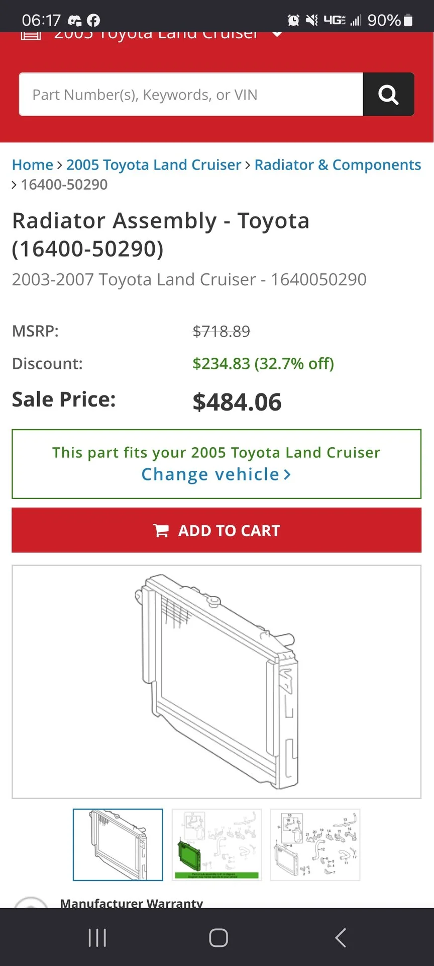

That's interesting - is that for a 03+? It's showing $484 for me:
Sorry 2001. Strange there would be much of a difference in price. I would definitely hold out for a holiday sale. We just had one and I saved 35% on some coils with free shipping. If you can hang in there I bet there will be some good Memorial Day sales.
  • Like
Reactions: LJE
Ahhh, gotcha. I agree - seems weird that there would be such a price differential. I'll keep an eye out for a sale then!
