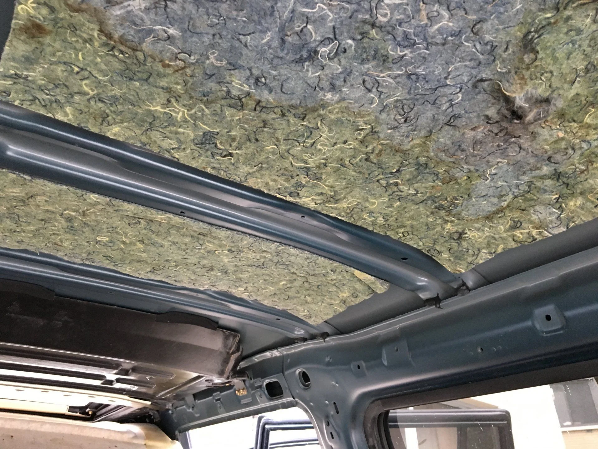

Removed headliner. Pretty easy, just an hour or so of careful disassembly. I was pleased by how clean things were underneath headliner. My passenger side rear drain was clean but partially kinked. My driver side rear (which was where the problem was originating) was partially clogged, two bad kinks, and a couple big punctures from a nail getting in the line. I blew out the lines with a compressor set to about 70 psi and will replace both rear lines with hardier lines tomorrow. I'm debating sound dampening the roof, though I don't care too much about that. I will soak the b and c pillars and the handles just to clean them up.

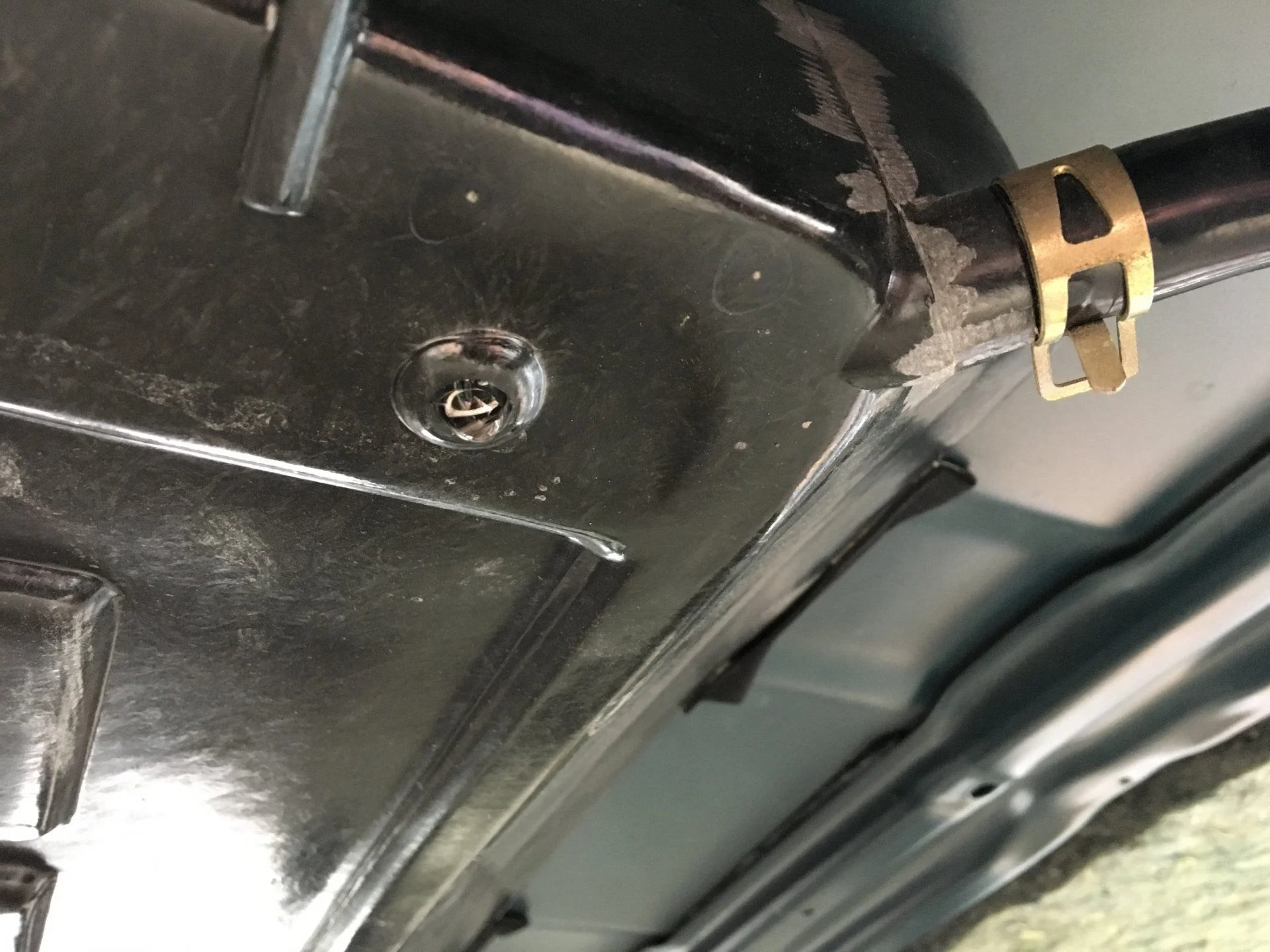

I did notice water droplets appearing through the small hole near the driver side rear drain line. Any advice as to what might be going on here?
Pictures:
Photos of the small droplet appearing from the small hole near the driver side rear drain line. Any advice as to what might be going on here:

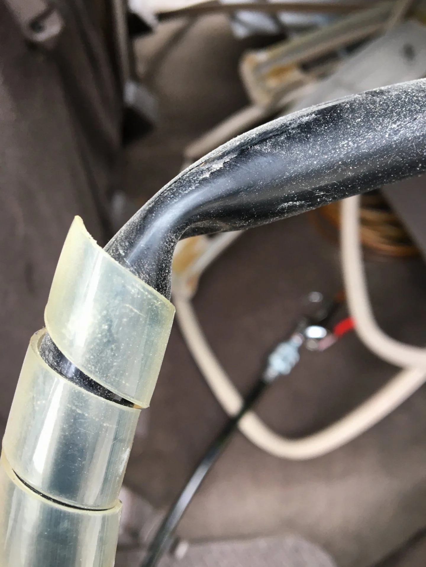

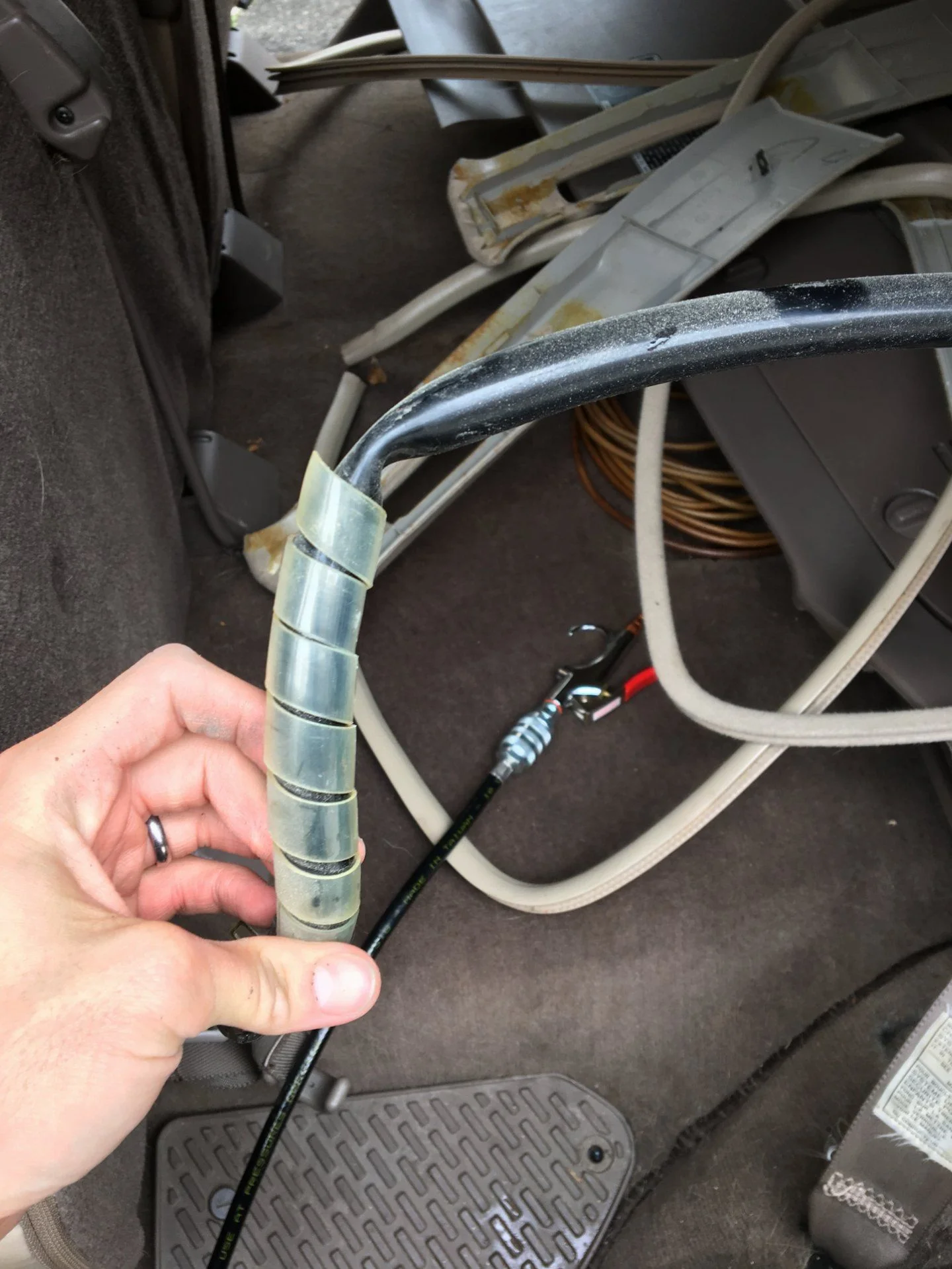

Bumping to see if you all that stopped your leaks? What sort of lines did you replace the kinked ones with?
post 7 is pretty much why mine leaked,rear lines kinked.
i fixed/cleaned all my lines then sealed off the sunroof and unplugged electrical.
several heavy downpours later and zero leaks.
if any previous owners ever did any work in the back they probably yanked/tugged on the drain hoses trying to figure out what da fun they were and as a result they pinched them off where they pass through the pillar.
