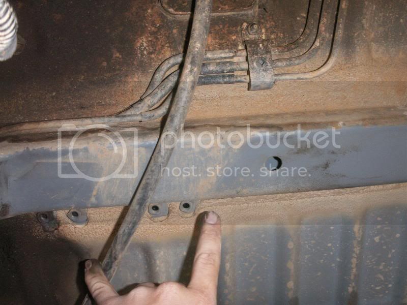

So the tank is drained and dropped and it is cracked in the very same spot as the last time. I reinstalled, marked point of failure, and removed to inspect the crossmember and mounting surface. There is no contact at this location, and only one spot that had made contact w/ no resulting issues. Everything seemed as it should except the very slightest of gaps along the front passenger corner of tank. It was perhaps 1/8'' off the body as if the strap were a bit loose, however it was not. I doubled up on the pads after i installed the tank last time and this was the only place a pad had become dislodged.
Any thoughts to why? First thought was straps were loose and the weight of the fuel caused the tank to bow along its lengthwise axis; but the strap was rather taught.
Only significant factors i can think of are it happened w/ a full tank again. 3.2 miles from fillup, on the night of the first frost of the year. Very light though, and i would really think this would affect it.
Gonna weld it up this afternoon and throw it back in there. Cross your fingers cause we depart 7:30 am tomorrow for a 5hr hwy ride and then about as much wheeling till camp. :)
crossmember is smooth and obstruction free along the length that contacts the tank.
on a lighter note, i did add this while i was under there....:D
cruisers and b'days go so well together .... :cheers: concretejungle!!!
It looks like there is a crease where the crack is. Is anything sitting on top of that spot that could cause it?
NO contact at failure point. There is a rubber pad that lies b/w the tank and the bottom of the body. The pad was in place and provided a gap b/w the tank and body along the entire length. Thought maybe it was the perfect toss of a small piece of gravel, but no dice, not twice.
oh and sorry, my finger is pointing to the area where the failure is located along boddy ribbing. Smooth and protrusion free, no signs of wear/rub.
