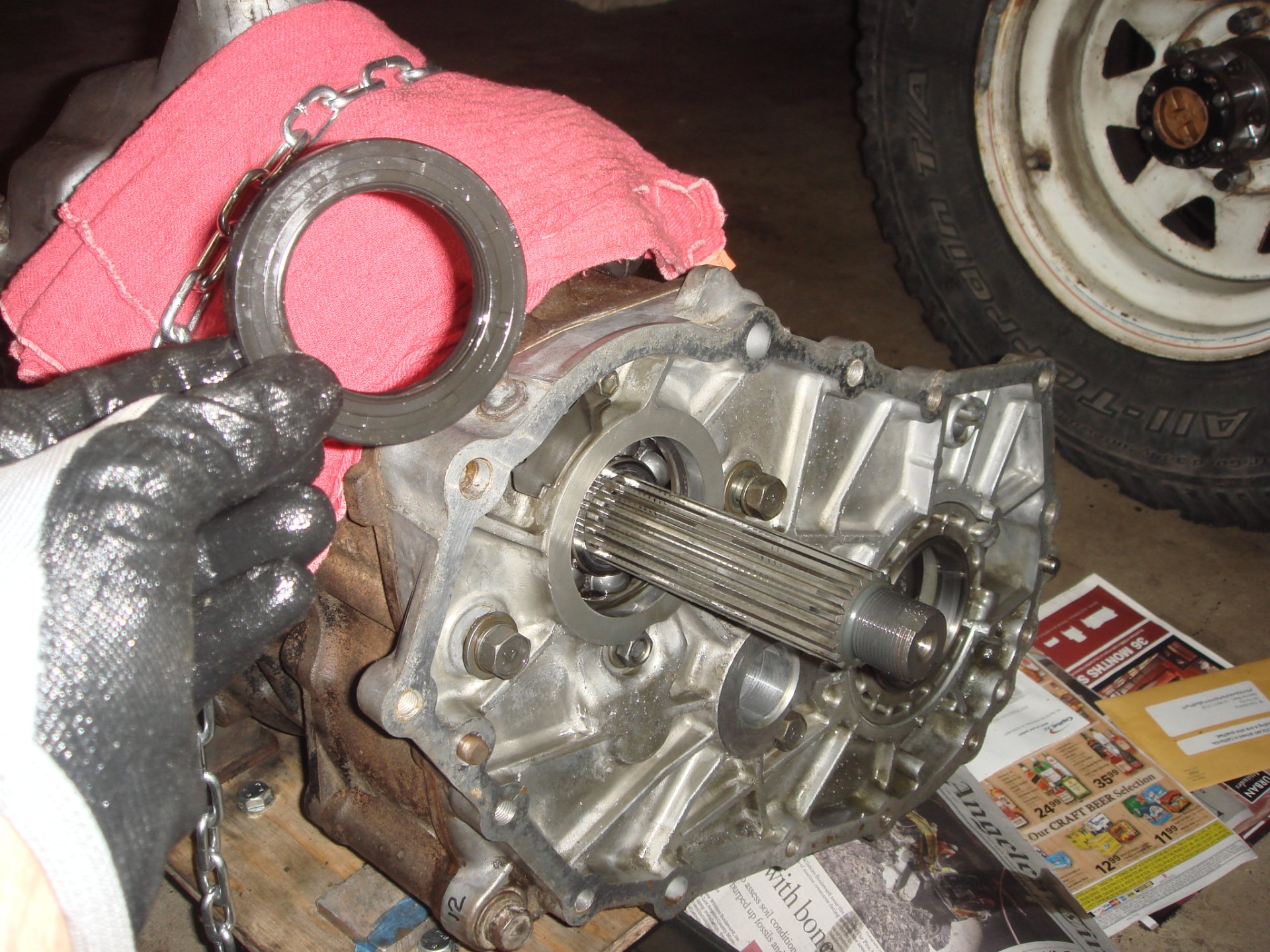

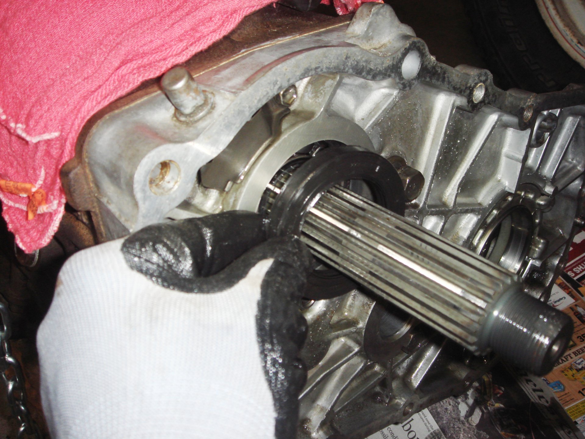

There’s gaskets that leak which are visible on the outside and there’s an oil seal inside on the transfer case input shaft that is supposed to keep the transmission and transfer case oils apart.
When that oil seal wears, (and they all do) oil migrates from one case to the other. Overfilling one and draining the other.
Old cruisers need to have the oil levels in both the transmission and transfer case checked regularly to make sure they’re both correct.
