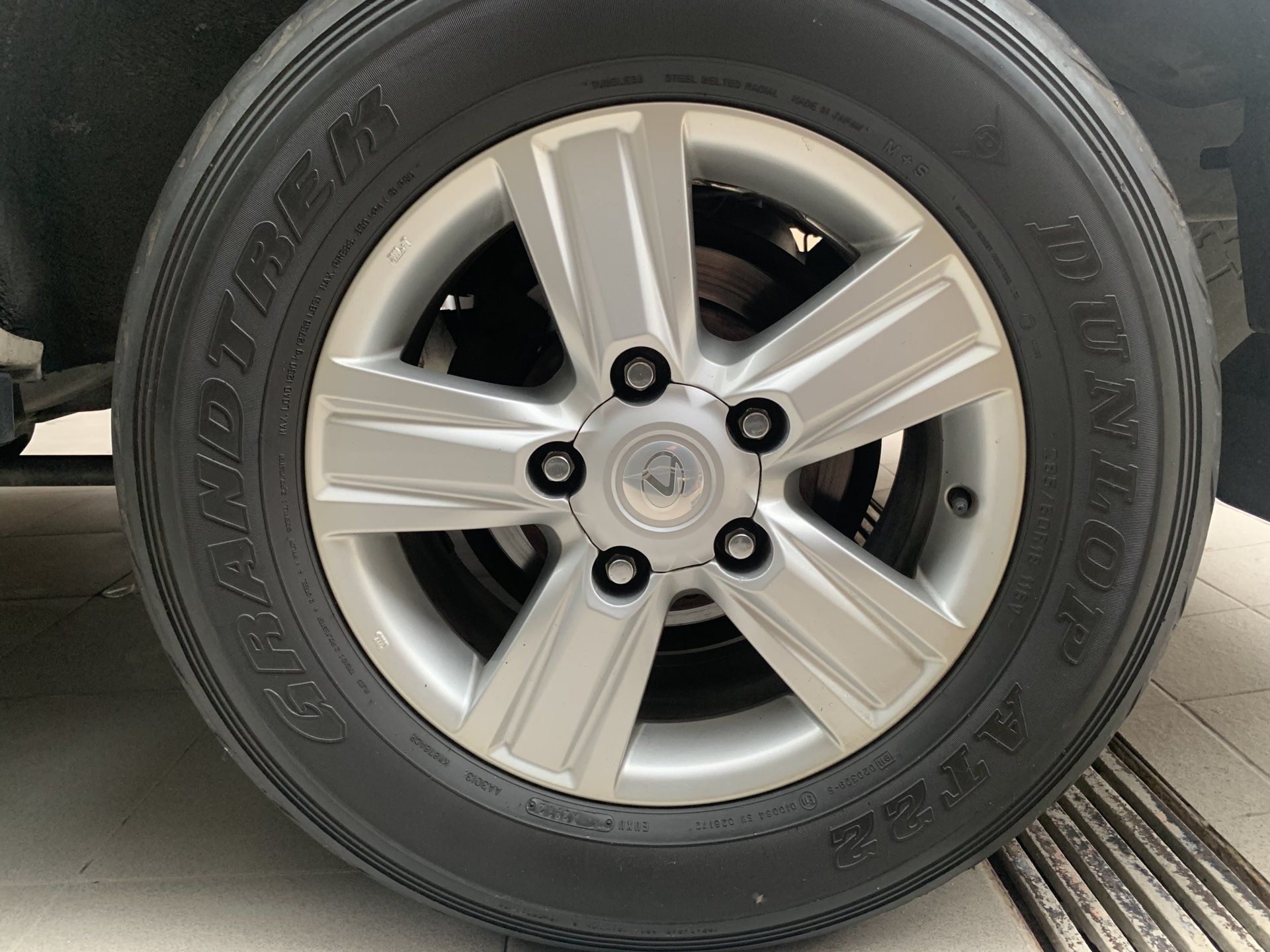

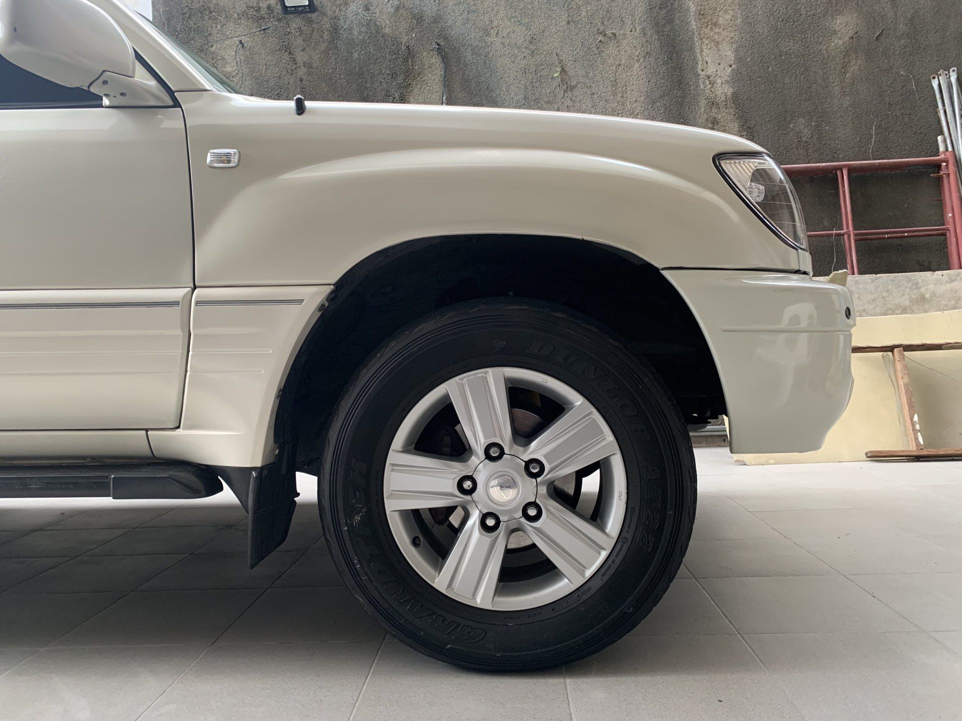

Hi, I recently bought LC 200 2013 wheels for my 2001 lx470. I just thought they were the same as the ones used for the later 2006 lx470’s. Anyway, I have a problem with the front ones as the center cap wouldn’t fit. I noticed the ones from the lx are embossed to give space for the wheel hub or whatever you call that part while the ones from the LC are flat. Maybe there’s other toyota center caps that will fit these? (Like the one from
Tundra, Tacoma etc.) I need help. Any suggestion will be highly appreciated. Thank you. I’ll post photos here.
Side
2006 LX470 wheels
Front
LC 200 wheels
I ran into the same problem. I flattened the hub grease cap on mine but the center caps still would not sit perfectly flush. Still waiting for the 6mm spacers I ordered.
Hi thanks for your reply. Just wondering how did you flatten it? Sorry newbie here lol and where can I buy the spacers? Thank you!
You flatten it by hitting it with a hammer repeatedly. I bought the spacers from ebay. Search “5x150 6mm”
Thank you so much. Now my concern is I am planning to put 275/70 A/T tires and if I put spacers, I don’t know if it will rub or not
