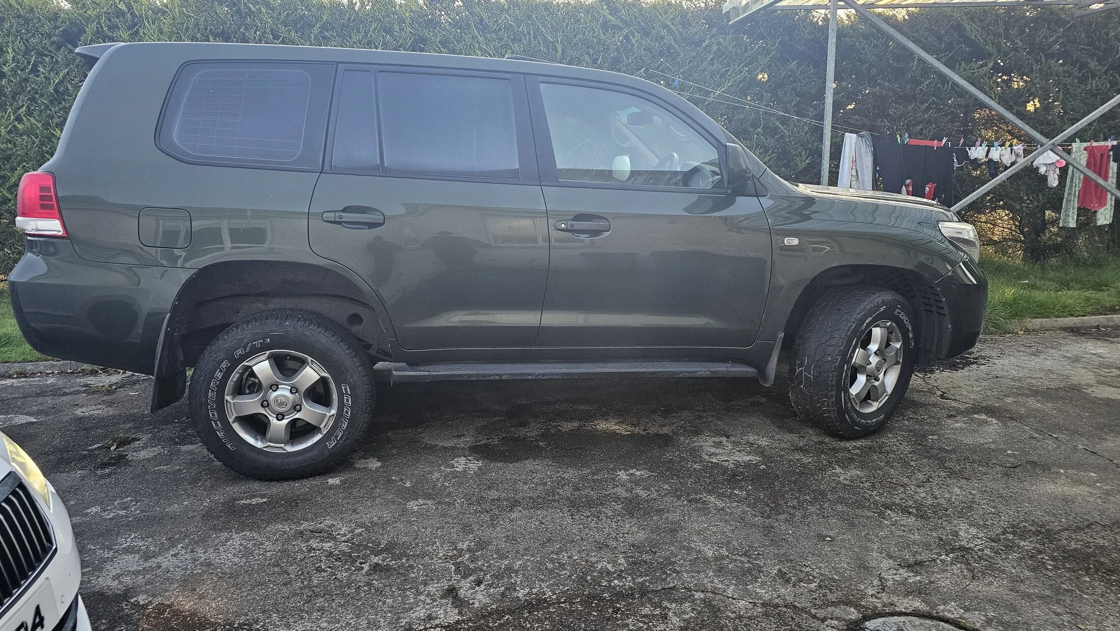

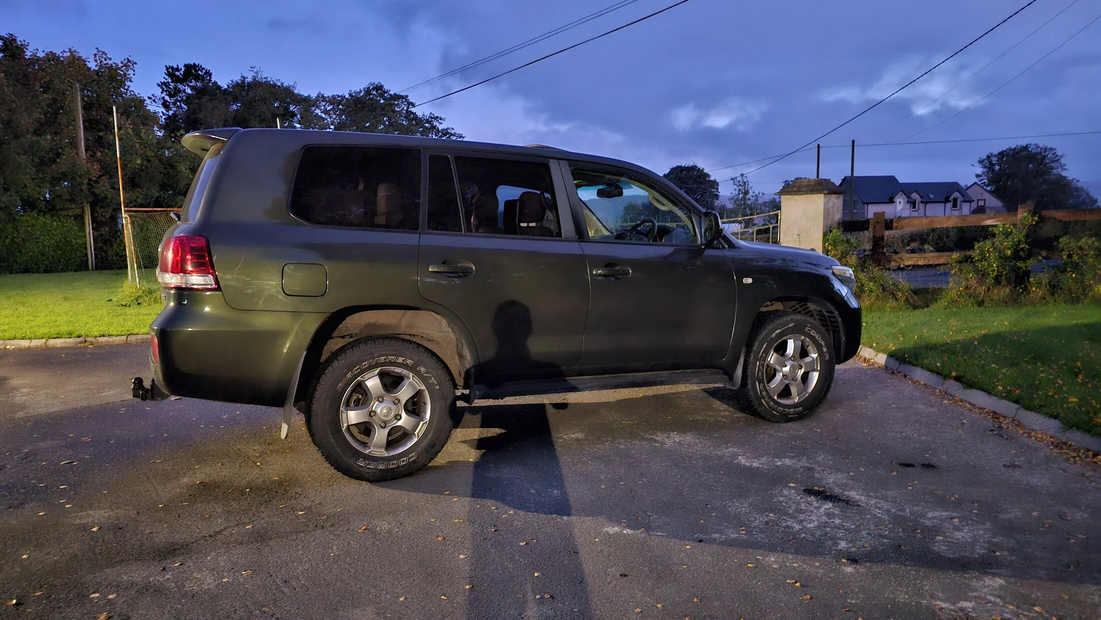

2011 200 series 4.5 V8, having problems with AHC suspension initially bracket broke on rear left height level sensor, repaired bracket but the suspension stuck on low and impossible to sit in, shocks in rear wer leaking due to bouncing along road, i assume theres a pressure release on top of shocks, refilled fluid resevoir now the body lifts and rear end sitting away up high and a real bumpy ride, at least the systems now operating and rising, maybe the 2 level sensors on rear are setup wrongly now? I prob need get it over a pit and adjust them while wheels are on the ground, so thats my dilemma atm, ps i dont do off roading and just want the car on level stance all the time preferably in the N position
