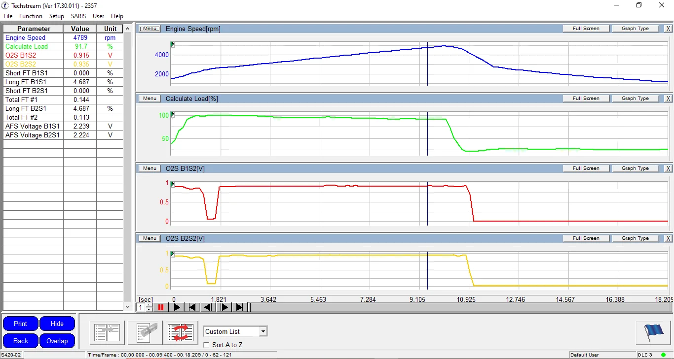

This is a run WOT, 3rd Gear up to 5000k RPM, to me the O2 sensor values seem ok, as do the Fuel Trims.

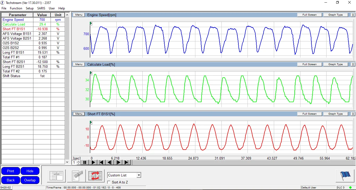

Then when in Park, we start to see something like this:
