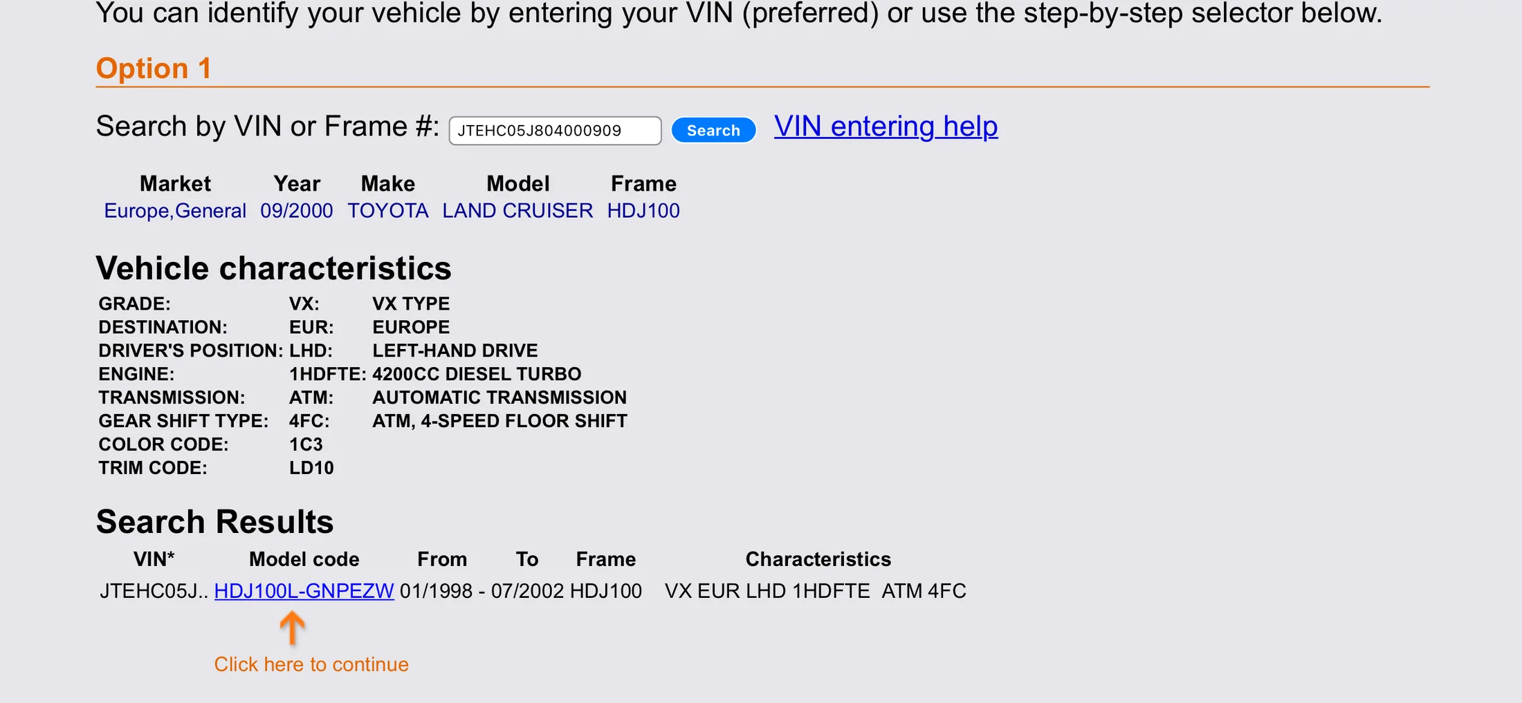

Using US model “rules” somewhere else in the world?
Thanks for the vin-info!
wouldn't it have a-tracat this year?
If it were intended for the US market, yes. If I understand correctly that doesn’t necessarily hold true in other markets.
  • Like
Reactions: GTV
Ok. I understand. Vin-number will not tell us anything about the a-trac.
Yes, but it does show that it was intended for the European market, not USA (or North American) market, meaning that the US “rules” about AHC, ATRAC, locker, no diesel, automatic only, VGRS, full time 4WD, VVTI may not apply in your market 🤷🏻‍♂️

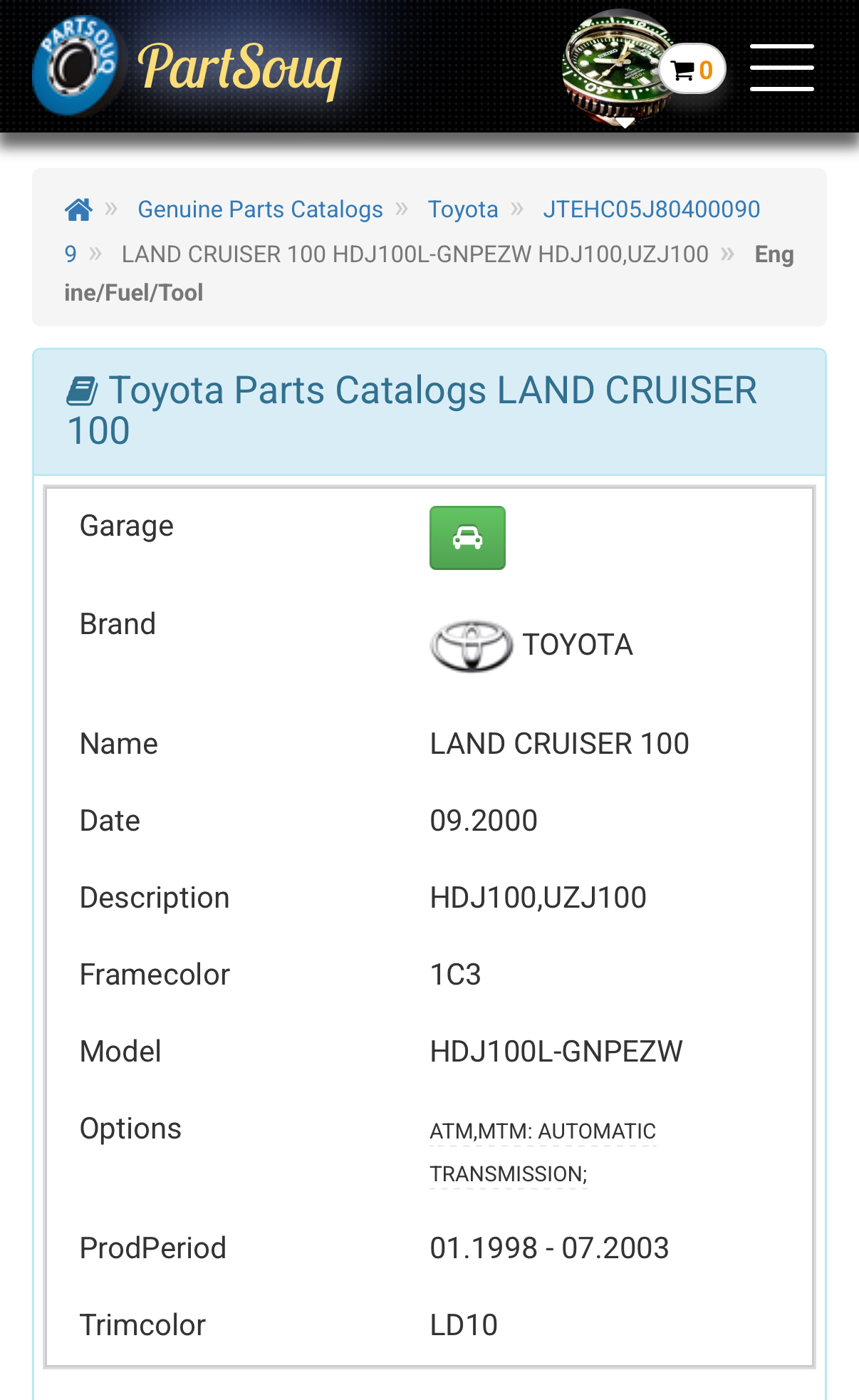

Partsouq is showing this an HDJ so this is the 4.5 liter turbo diesel 1HD engine model of the 100 series;
The standard 2001-2007 ATRAC on all USDM 100s is not applicable to African, European, Southeast Asian, and GCC spec 100s that had the 1FZ and 1HD engine options. It’s a whole different ball game overseas where there was so many options including sub tank, bench seating, oem spare tire swing out, barn doors, factory winch and factory electronic rear/front locking differentials.
